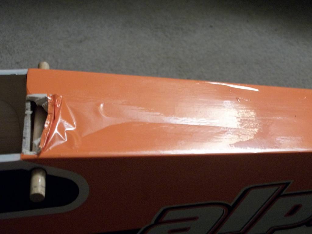

<span style="font-family: Arial;"><span style="font-size: larger;">Hello all,
Been reading the forums here for the last couple of days. I can say there is a lot of good advice here.
I'll start off to say that my flyng experience is self taught. First with a Axe c/p heli, which cost me more in parts than the copter did! I then took batteries out of the heli, and bought another transmitter, and wound up biulding a slow stick. After lawn darting the first one a few times and learning I built another one, with brushless motor. Great machine for learing on. (Once when I was working in Washington State I landed it in a 50 foot pine tree. After waiting for 2 hours, I finally fell out.) New prop, minor adjustment, and it flew fine. Had many more mishaps, but I won't bore you with those.
Yesterday I bought a Alpha One Trainer, and put it together, and batts on charge. I then proceeded this evening for my first test flight. Did all the usual checks after putting the wing on, run up, etc. I then took off, and I have to say a nerve wracking experience. Airelons are far more sensitive than evevator only, and flys fast enough to make you on edge even at half throttle. Anyway, all went well and after 5 mins in the air i decided to try a landing approch. WRONG
I think I stalled, and to make a long story short it lawn darted the ground for about 12 ft high. I went over to it, and the prop (no suprise) was busted and carb had a plug of dirt in it. I had the throttle down to idle when it happened.(probably the first mistake)
I have posted pics of the damage, and would like advice on how to fix it, because to me it don't look that bad.
Damage is primarily behind the rear dowl post for some reason, and under the ultrakote I can feel a crack about 5" long. You can see the chunk that broke behind where the wing goes on. Wing and all other control surfaces were intact.
Thanks for any advice, since I have no idea how to fix yet, and I do not know anything about ultrakote.

iceman3ar:
May be time to find a club. They can help tons!
You might want check the fire wall (where in engine is mounted), make sure it's tight and also check just ahead of the tail feathers for damage.
Happy Landings!

Way to go!!! Seriously, congrats on getting out there and goin for it. Now you have your first crash out of the way.
You are right , it doesnt look to bad. I would cut away the covering to get a good eye on it to be sure of the damage. espcially where you say that 5in crack is. If it is just a crack you can apply some CA glue and it will basically weld it back solid. It will be stronger than the balsa around it.
I have never built a plane that had rubber bands holding the wing. But I am sure you need to make sure that area is not weak. Reinforce that area if it is damaged. From the pics, the damage looks superficial.
And if it was me, I would cut away those engine cheeks, just for easy access to the engine.

Sorry to hear about the flight!
It was a good thing the engine was at idle!
Had the carb been opened, dirt and related will have gotten into the engine, and caused major damage internally.
It is a good idea to check that firewall as stated above, and repair the crack. If you fix this, and don't want to wait for an order of covering,
use clear (not the translucent type) scotch tape to hold the covering for the time being - If it works on my Cub, it'll work for you!
Join the nearest club, and get an instructor to check your model after the repairs - he might spot something you hadn't.

Your probably going to have to take the engine off, clean it up (check the firewall, "t" nuts, to make sure they are still in place) and the for the covering torn off, you may either have to re-cover, or just find the ultracote coloring of that, cut a little piece, and iron it over. (wont look the best). Good Luck!

Do as others have already stated. Take the engine off and check the firewall, examine all the glue joints and pull the covering from the damaged area and inspect and repair. Do find a local club in the area and get some instruction. It save you some frustration and some $. Spend $100 dollars and go get the Real Flight G5 basic simulator. It's save you even more money as you spend hours practicing on the computer. My helicopter skills have slipped from not flying them for many years and the simulator probably saved me a few hundred dollars in parts replacements.
Definitely take your carb off to see if any dirt got through. If you find any, you need to take the whole engine apart and do a clean up. Just a few grains of dirt can ruin your piston and liner.
And don't take it as being mean, but you really need to find a club. Your prior experience really should have taught you that, but better late than never. A club with instructors and an AMA membership (required at most clubs) will pay for themselves many times over in good advice given. If you aren't willing to do that, then find a new home for the glow plane while you still have something to sell and stick to park flyer foamies (which can be lots of fun themselves).

Should float in to land (into the wind) almost hands off at idle if the centre of gravity, trim and throws are set right I would think.
A experienced flyer would check all of this for you.

Your problem is a double whammy; as a beginner, you neither know how to fly well (with the obvious result), and you don't yet know how to repair or build well, a markedly important shortcoming for someone who has already learned how to crash well. Just kidding.
So by getting in with a local club, you'll first get good advice on the repair, but more importantly, you'll for sure get some help with learning to fly, and that will lessen your chances immensely of having to repair again any time soon.
So yea, join a local club. You need them, and they need you.

You should fix more than the slight damage the trainer received. You need to get the aileron torque rods adjusted to give you less throw or on the control horn of the servo (move them out). I assume the radio included with this RTF package doesn't have adjustable ATV/end point. Reinforce the firewall whether it needs it or not, no ARF I've ever owned was sufficiently glued by any means. Get out some epoxy and hit the joints on the firewall, landing gear block, and those dowels inside the fuselage. The plank behind the rear dowel is cosmetic, you can throw tape over it and get in the air faster if the structure seems sound to you. Give it a little twist test to see if the structural integrity wasn't compromised in the crash. Consider this trainer disposable and to teach you to land, you're almost there and this trainer looks the same as any seasoned trainer I've ever looked at. Sounds like you stalled it. The simulator is a great idea, you can just walk into a Hobby Town and see a simulator set up for your free use and decided which type to buy. Check the nose gear. Flush out the dirt with some fuel. Replace the prop. A flying buddy or nearby club may get your going a lot further than trial and error. Also check the clunk in the tank, it's probably thrown forward and is stuck. Empty the tank and shake it back to the rear of the tank and make sure you hear it rattle inside.
