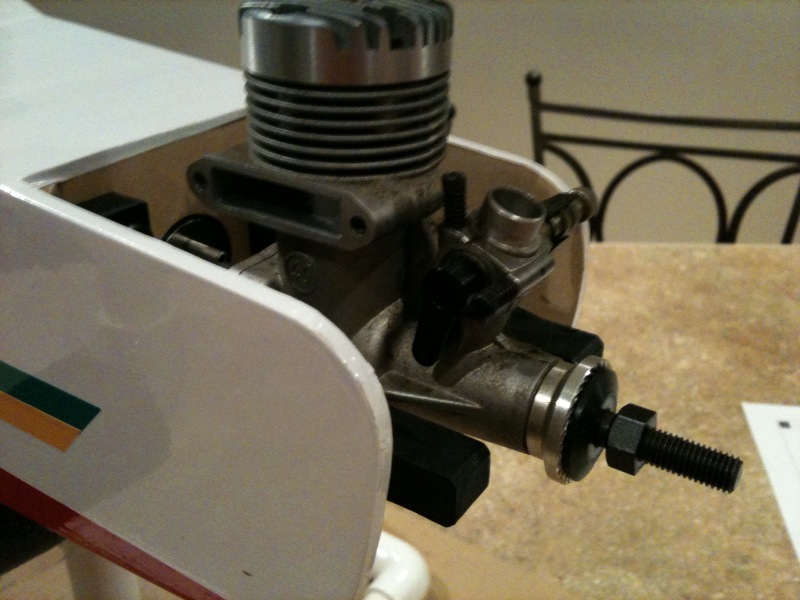

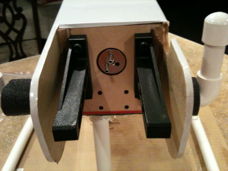

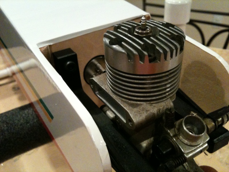

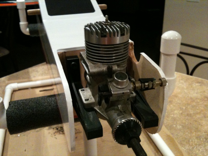

Old 03-18-2010 | 09:30 PM
ATVAlliance's Avatar
Joined: Mar 2010
Posts: 900
From: , WV
Default RE: Nitro Planes EZ Trainer
Rog,
When you put your engine in, did you use the supplied mounts? Or did you use another type?
I am uncertain if the supplied mount is going to position the engine correctly. It looks as if it will center properly...but the vertical position seems wrong. Also and again...the manual isnt much help as it shows the engine to appear to be mounted on TOP of the mount rails, the diagram shows it mounted below the rails.
If I place the engine on top of the rails...it appears to be too high above the fuel tank. If I mount it below the fuse will have to have quite a bit of material removed in order for the exhaust to clear.
See my attached pics and any input is appreciated.

Old 03-19-2010 | 01:00 PM
Posts: 7,182
From: Burlington, NC
I went on top of the rails,, most all models need a little dremelling/carving to fit in mufflers and needle valves just seal the exposed balsa back up with glue or paint....Rog
Old 03-19-2010 | 01:11 PM
Joined: Mar 2010
Posts: 900
From: , WV
ORIGINAL: flyinrog
By doing so...how was your carb in relation to the tank? Seems either way I turn the rails (they arent centered on their mount so one way will set the engine about 1/4" higher than the other way) the carb is quite a bit higher than the center of the tank. Its not higher than the tanks top...but definitely higher than center.
Old 03-19-2010 | 04:34 PM
opjose's Avatar
Joined: Nov 2005
Posts: 12,624
From: Poolesville, MD
You'll see a LOT of talk about Tank/Height differences and how things "must" be in line.
For-get-about-it!!!!
The only time this is an issue is in relation to siphoning fuel ( something you will not have a problem with ) or when there is quite a bit of distance between the carb and the tank.
As I tell people, if 1/4 - 1" made SUCH a difference, our planes would conk out every time they go a bit nose up or down.... yet they keep flying!
Most trainers are designed much like the one you have, and they are wonderful flyers.
Just mount the engine properly and securly, keep the fuel lines as short as you can, fly with an instructor at first, and go have fun!
No need to overthink it.
