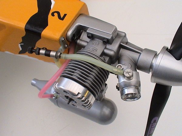

Always mount the engine on it's side so that the tank level is according to the tank rule! See picture below!
Use a 240-300cc tank for a .40-.46 engine..
Use a "Uni-flow system in the tank (Two clunk lines) for best performance!
Use a 11x6 or 12x4-12x5 APC or RAM prop on the trainer (if you fly at sea level that is).
Use as short servo arms as possible!
Use as long rudder /aileron/elevator arms as possible!...all this for having stiff flying surfaces. see picture below of the aileron servo linkage.
