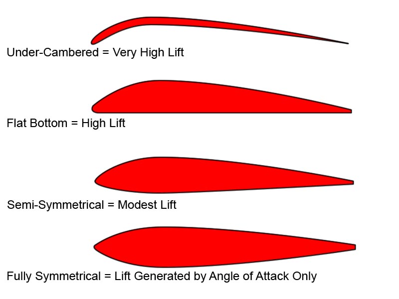

Can someone explain me how does airfoil work? In other words, if someone talks about a fully symmetrical airfoil - what does this mean? I know it is probably a stupid question, but I don't know it and if I don't ask I never will.

Korps,
Your question is not stupid at all, since it is something as hard to understand and see as it is hard to explain.
Made it very simple:
An airfoil is the transversal shape of a surface that is forced to move thru a mass of air at certain velocity.
Some of that force is converted into a force named lift, that is pointing in a direction perpendicular to the velocity of the wing.
When that lifting force is bigger that the weight of the model, the thing goes up; when it is equal to the weight, the model flies horizontally; when it is smaller, the model descends.
The lifting force is proportional to the area of the wing, to the angle of the airfoil respect to the velocity, to the density of the air, and to the square of the velocity.
There are many shapes of airfoils, and each has a different purpose.
Each has a different coeficient of lift (CL), which is proportional to the AOA, and this CL affects the proportions of lift to velocity, area and air density described above.
For high lift, the shape is curved in order to force more air downwards for the same wing velocity (high CL): this is called a cambered airfoil. Those are not good for high velocities.
For aerobatic maneuvers, the shape is straight or symmetrical (zero camber or curve) (low CL), in a way that the wing lift the same upside down. These are also good for high velocities.

ORIGINAL: Korps
The simple answer to this part of your question is that a fully symetrical airfoil will have the same opposing shape on the bottom side as that on the top side.
Another term you will hear often in modeling is 'semi-symetrical airfoil' this just means the bottom shape while faily close to the top side shape is slightly different.

"So that is why a Trainer plane for instance (which has a flat bottom wing), will fly more stable and more slow - because it generates more lift in level flight?"
A flat bottom wing is a cambered airfoil, which happens to have the bottom surface flat, just for construction convenience.
As you say, this cambered airfoil has a high CL, generating lift at slower velocities; hence, it can fly slow enough for training.
Now, the stability of the model has nothing to do with the airfoil shape; the trainers are stable for other reasons.
"But for this same reason it will not fly or not fly inverted well because it will be "pushed" down?"
The cambered airfoil ("concave" shape) can fly inverted, but it needs to compensate for the "convex" shape with higher AOA and/or higher velocity.

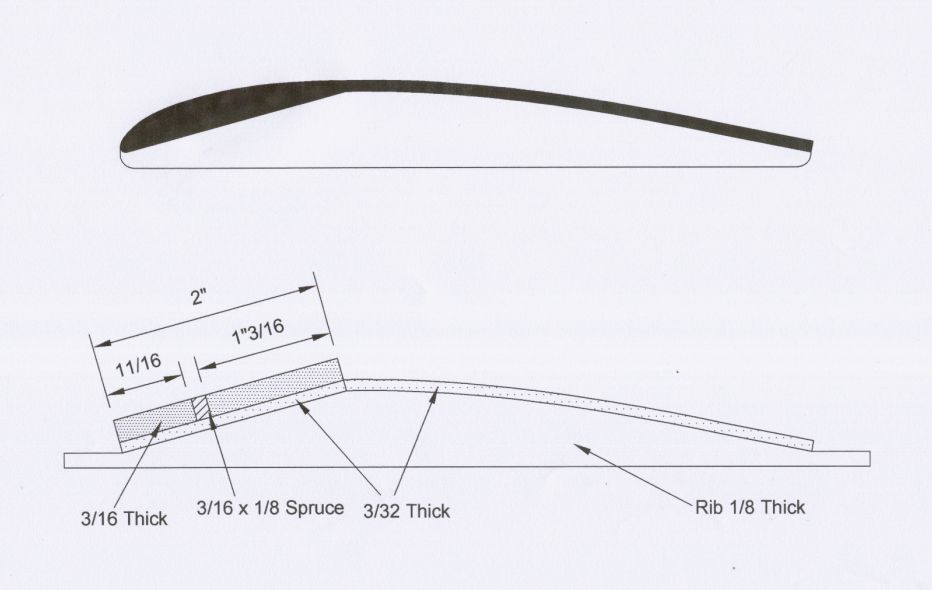

Many of the early aircraft designs featured the under camber sections. In models, it was more popular with free flight designs from the 30's and 40's, and still seen today in old timers flow with radio. The MEN Trainer also used a similar section in a rudder, elevator and motor control design.

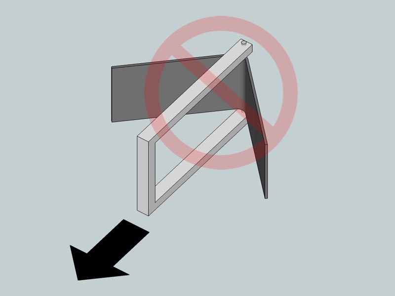

A kite is bowed so that if it tips to one side, air deflects off the rearward side, whereas the air hits the forward side with a straighter (thus more powerful) force which levels the kite out again. A flat-faced kite would never fly.
Dihedral does the same.
Picture having a metal plate that is bent in the center and pivoted on a bracket. Now drag that bracket through a pool of water. The plate will never be able to swing forward.
This is the exact same principle as how dihedral works (in fact, this IS dihedral)
This is why trainers often have a LOT of dihedral - to take advantage of its self-righting characteristics.

No, I am not saying that I cannot fly a trainer inverted, but thanks for the insult.
What I am saying is, an inverted plane with a lot of dihedral will fight to upright itself. It is a lot more difficult to fly inverted than a plane with little or no dihedral.
Regardless of airfoil.
What I am implying is that your implication is very misleading.
Your statement, "Dihedral make no difference as to whether or not you can fly a model inverted." implies that a plane will fly as easily inverted as it will upright.
CAN a person fly a high-dihedral winged plane inverted? Yes.
Can a beginner (who is most likely to be flying this type of plane) do it? Doubtful.
You can also stand on a beachball in a swimming pool, but it's not as easy as it sounds.

My point is, you said, "Dihedral make no difference"
Point a trainer straight an level and take your hands off the sticks. Will it continue to fly straight and level? Yes
Now flip it inverted and take your hands off the sticks. Will it continue to fly straight and level? No
Dihedral makes a difference.
That's why they put it there.

Minn, the under-cambered type - never seen it before. Which types of planes has that?
