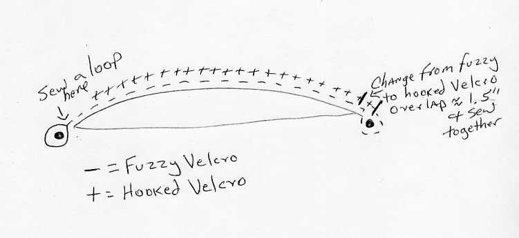

Its to simple - take a piece of string ann tie it to the back/rear peg that bands go on then lay wing on plane -now go over the top of the wing with string now run it under the front peg and back over the top of the wing - Now ya see how its done -Make a couple of Velcro strips the same way and just try to shake the wing off - Cant can ya -
Follow my other post on how to make velcro strips

I couldn't see the velcro on the planes I found in that thread. Actually I didn't even see any dowel rods on the plane. But, let me see if I figured this out. As I (poorly) drew in the attached pic you sew a loop for the rear peg with the "fuzzy" velcro (or I guess you could use the hooked) and then stretch the velcro over the top of the wing and under the front dowel rod. Then after coming out from under the front dowel sew the "fuzzy" velcro to the "hooked" velcro (overlap them about 1.5 inches) so the hooked can mesh with the fuzzy from that point on. Let them mesh all the way to almost the trailing edge of the wing.
I know I am repeating what you said but want to make sure I understand. The consequences of being wrong are kind of severe. Is that it?

That is dead on the drawing - pull it snug and good to go - it pulles off bu pulling up but to test - just stick them together in your hand and try to pull them apart long ways - you have to be superman to do it - Damm I think I started a revelalution - but not my Idea it came from the it came from the guus at Corks field - the plane you seen is not the one buy the way and they use white velcro - Hell red or striped works same
Give it a try - put it on a trainer or anything we do it on Sr telemasters and Sr Kadets
