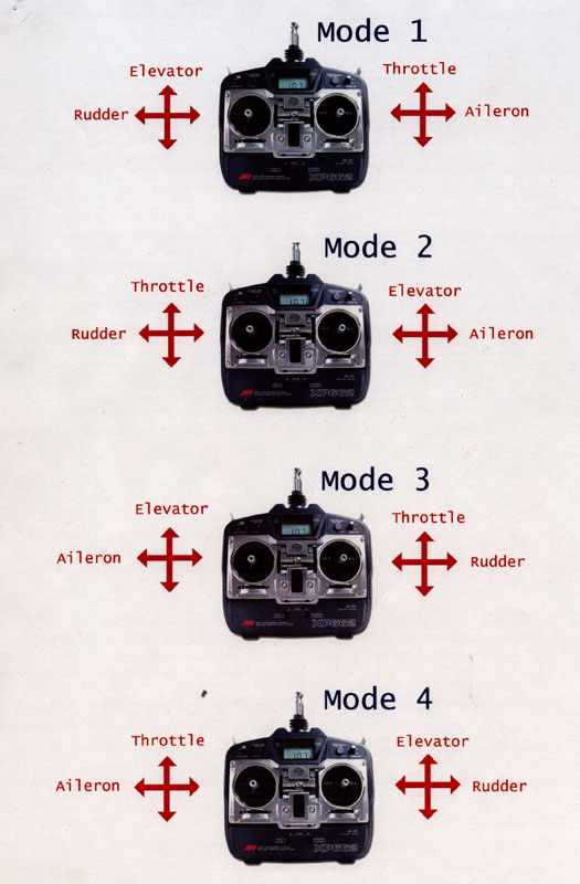

4ch question, basic
which stick is the rudder should be on?
i have only flown 3ch planes, so i am used to the rudder on the right.
on the dynam 4ch plane i just got, the rudder is on the left, with the throttle. is that common?
i think i want to switch the servo wires on the Rx, so that the rudder is where i am used to it being. rolling the plane when i mean to turn it is not good[:@]

Left Stick:
Left and Right : Rudder
Up and Down: Throttle
Right Stick:
Left and Right: Aileron
Up and Down: Elevator
It is common to be in this configuration because with a four channel plane, you want to make your turns mainly with the ailerons where as with a 3 channel plane you can only make your turns with rudder because thats all you have. It will be a little different at first when you taxi because to steer on the ground you will use only the left stick to turn. But, once you are airborn you want to turn left and right with the ailerons using the right stick (which is what your probably use to)

I second what david george says, at lest is mode for america. Sounds like you haven't had the pleasure of flying with airelons yet. Much smoother than rudder only.
There are 4 different modes for assigning channels to stick movements ...
We predominantly use Mode 2 in the US. Some of our club members that are into 3D&pattern competition prefer Mode 1. Some transmitters allow you to configure your Tx to any one of these different modes.

Mode 2 - North American Standard
Right stick - pitch and roll
Left stick - speed and yaw
Don't think surfaces, think function.
Right stick is pitch ( elevator,elevons or canard) and primary roll/turning surface (rudder, ailerons orelevons typically)
R/E Throttle airplane, - That primary roll/turning surface is the rudder - it goes on the right stick. The rudder works with the dihedral in the wings to bank/roll the plane.
On a 3 channel aileron/elevator/throttle plane, ailerons go on the right sitck. They are the primary roll/turning surface.
On an elevon airplane, lke a flying wing, there are neither ailerons or rudder, the rollfunction is on the right stick.
On a V tail(called ruddervators) throttle plane ( no ailerons or rudder) the roll/rudder function goes on the right stick.
What is the point? Don't think surfaces, think function.
The primary roll surface, whatever it is, goes on the right stick. You fly just as you always do regardless of what surface is on the right stick as long as it is the primary turn/roll surface. This way you NEVERhave to worry where the rudder is. THATis the right way to set up a plane in mode 2.

<blockquote><dl> <dt><font face="Arial">Mode 2 (also known as Mode B)
This is the "normal" mode that the majority of pilots use.</font> </dt> <dt><font face="Arial">This has pitch and roll control on the same (r/h side) stick, in a manner similar to the way the primary controls of an full size aircraft operate. The (l/h) side stick has the yaw and throttle controls. (see primary flight controls for an explanation of these terms) The perceived advantage is that as pitch and roll are the primary means of controlling the models flight path, having them on the same stick makes it easier to co-ordinate the two.</font> </dt></dl></blockquote>I'm guessing that this information is what prompted the disagreement. Like any unknown internet source it may or may not be gospel. If, however, you buy into to it as the basis for orienting the controls to the sticks - it places pitch and roll controls on the right side.Our club has a excellent instructor / aerobatic flyer that is no longer an instructor candidate - he has chosen mode 1 for benefits in flying aerobatic maneuvers. Our loss

Sure.
When you fly planes thathave both ailerons and rudder and make use of the rudder, it is normal to go for the righthand to roll and the left hand to yaw.
On my AVA for example, there is only the rudder which produces both roll and yaw.
Rather than having to remember which plane,what surfaces it hasand where they arelocated, Ican actually access the rudder from either hand. So if I am looking to bank the plane to turn I naturally do that with my right hand, banking the plane, then pulling elevator as needed, same as Iwould with ailerons or elevons.
My Futaba 9C allows me to mix controls in this fashion. Ihave the left stick set up at 50%so that Iget mostly yaw and less banking so I am less likely to over control the rudder when all Ireally want is the yaw effect. If I am looking to yaw the plane, such as on a landing,then I naturally go for the left hand.
So, both hands find what they want, even though I only have one surface doing the work.
I think function rather than surface. What do I want to do, not what surface do I want to use to do it.
BTW, on an elevon plane that has no rudder, like a flying wing, nothing gets mixed to the left hand as there is no yaw control on manyelevon planes. There is only pitch and roll.
