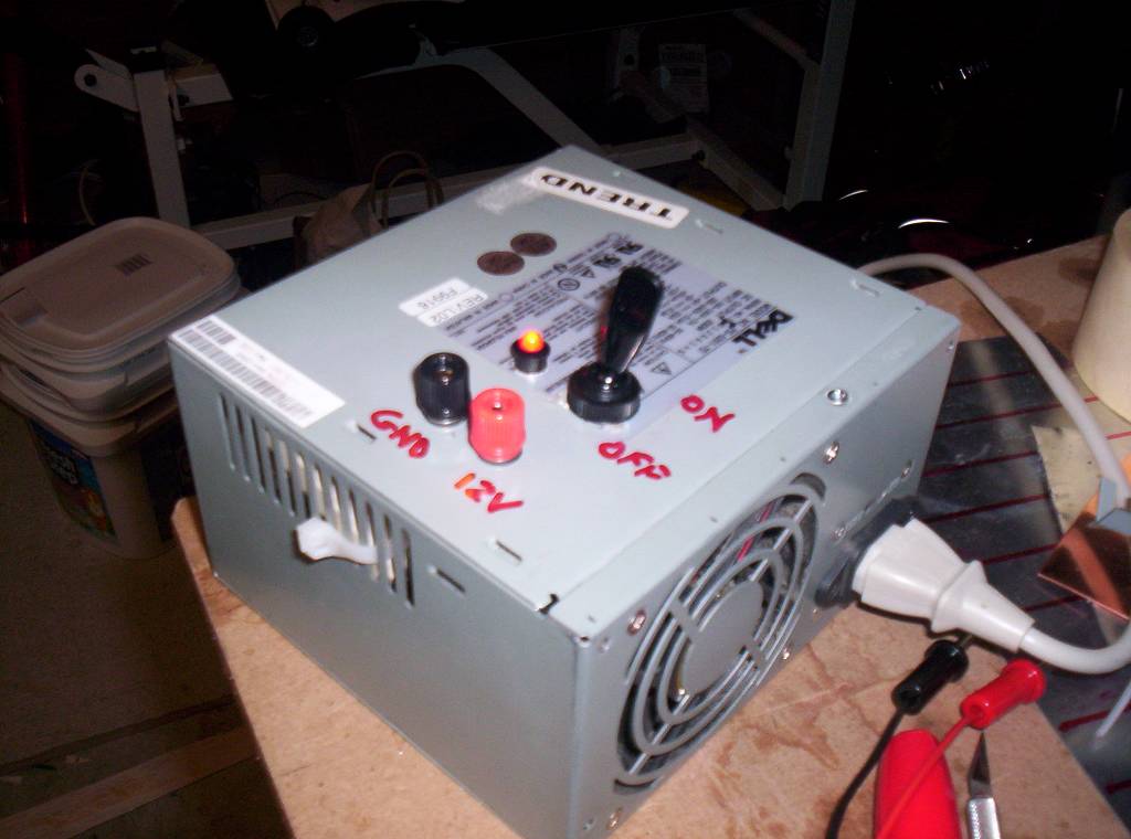

I have one of these and it works fine. Only $16:
http://www.hobbycity.com/hobbyking/s...ly_100~240v_5A
I also converted a PC power supply for about $5. It also works fine, but it's not much to look at.
Your car battery is really the best way to charge your LiPo's. I've topped off packs with my field box battery, but it doesn't last long doing that.

Here are the instructions I used for building my power supply:
http://web2.murraystate.edu/andy.bat...owersupply.htm
It's easier than it looks, especially if you only need 12V. I had an odd Dell PS that none of the colors matched, but I was able to sort it out with a voltmeter.
All you really need to buy is the resistor (2 for $1.85) and the banana jacks (about $1). The switch and the LED are not really necessary.

I also use a modified PC power supply. Here are the instructions.-BW
