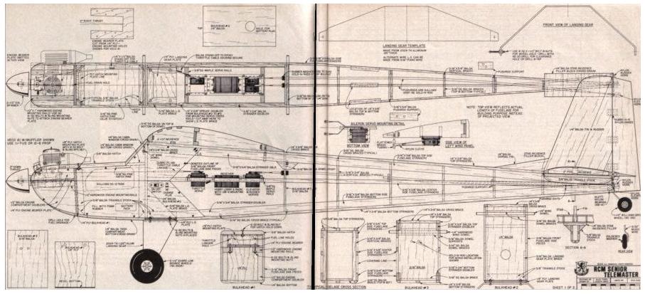

ORIGINAL: tripower222
I am going to keep my eye out for an old used Telemaster apperently they have a flat bottom airfoil stab. First I will see if it will even fly, dosent sound like it will. then I'll put a flat stab on it and see if it has a tendancy to gain more altitude with speed. Wonder why they did it on the Telemaster?
The Telemaster is not a typical design.
Check the attached scan of a plan.
Note that the wing and stabilizer incidence angles are given as 4.5 and 2 degrees; hence, the geometrical decalage = 2.5 degrees (which increases in flight due to downwash of the wing).
Those are more than 2.5 degrees of longitudinal dihedral; hence, the model is selfcorrecting and speed sensitive.
The AOA of the stabilizer is negative, althought the airfoil, being cambered, would lift more for positive AOA than for negative AOA.
This is suitable for models that have the CG aft the aerodynamic center of the wing, but still located ahead of the Neutral Point, according to Andy Lennon's book.
The engine firewall has 3 degrees down thrust and 2 degrees right thrust.
