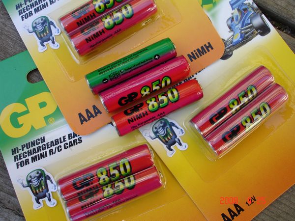

Hi!
But why use 1200mAh batteries when there are 2800mAh cells the same size (AA,R6)???
I have charged my 2200 and 2600mAh NiMH cells for years using my JR 50mAh wall chargers and it just works perfect. Just charge 24-30 hours...what's the problem with that ???
4,8-6V works equally well!
Soldering together a pack from individual batteries cells is easy! Just sand the battery plates and put some soldering acid on...then tin the end plates and then... quickly solder the presoldered cables to the end plates . This takes just one second with a good soldering iron (Weller 50W).
Pictures below shows GP:s 850mAh NiMH "High current" AA cells without soldering tabs (which aren't necessary). These cells are first Ca glued together and then wires are soldered on.
