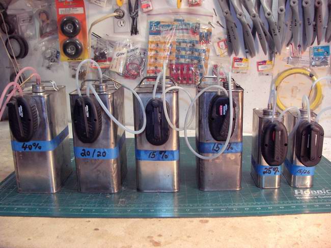

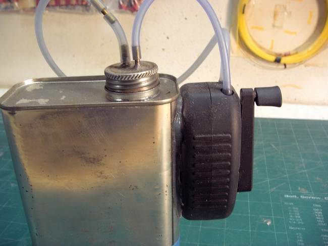

I use only geared manuals for all my glow powered stuff. Electric pumps and power panels are just stuff for the new guys to spend money on.
In addition manuals have the hugh advantage of making it simple to figure fuel consumption with simple habits of counting turns in and out. This is impossible with electric pumps.
John

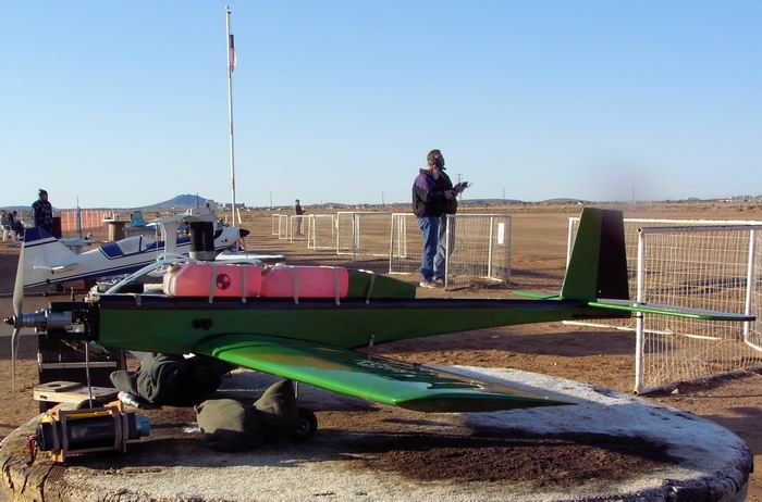

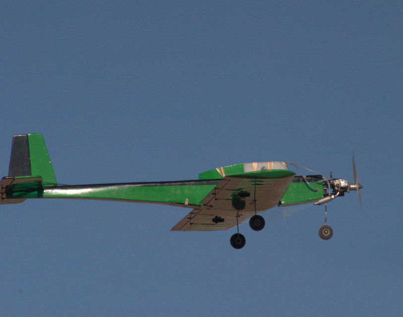

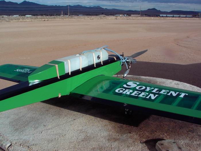

I routinely fuel and defuel this one with a grand total of 56 ounces in three tanks with no issues. The inability to count cranks would really mess things up.
John

I have to ask....wth is that, and why?

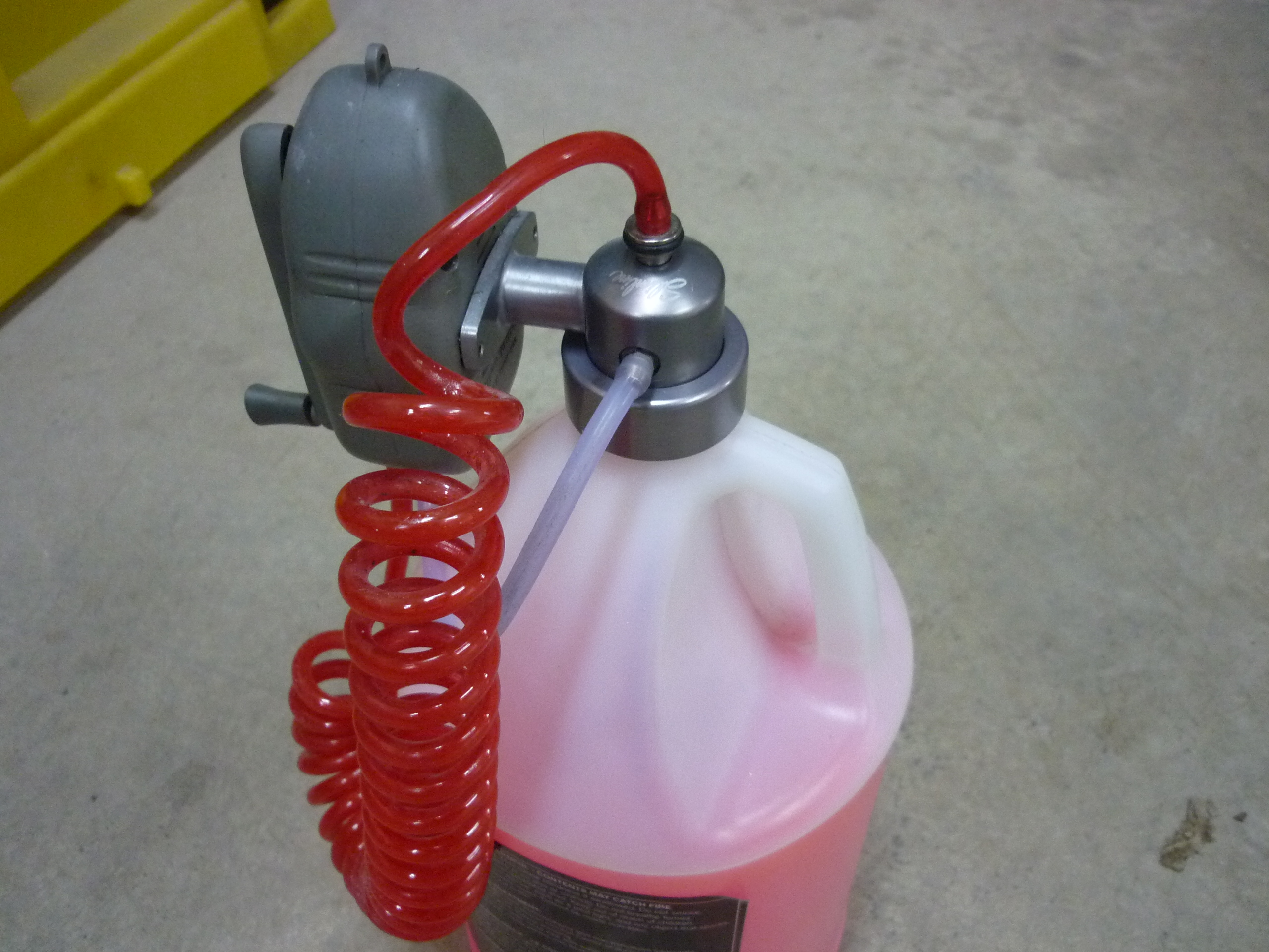

I use just the hobbico fuel pump, but I use the slim M4 manual fueling system. The hobbico fits on this also.
Jim
http://www.slimlineproducts.com/online_shop/m4_pump.htm

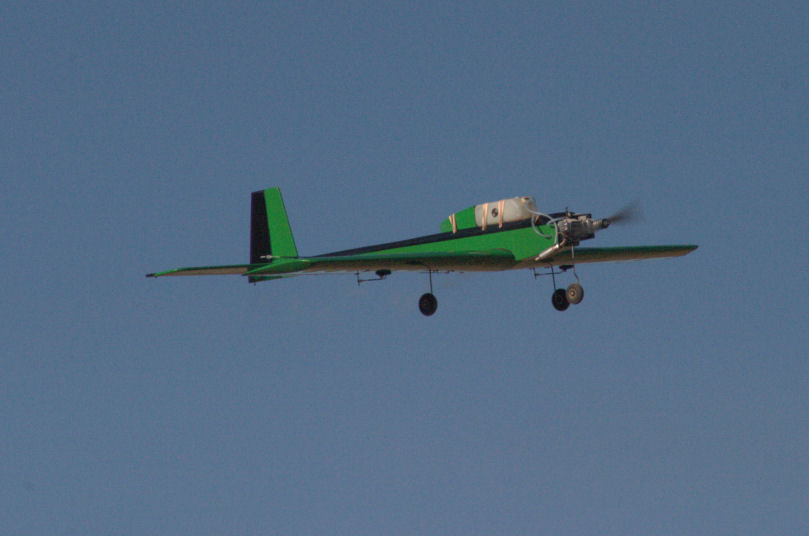

Sorry I forgot to quote txaggie08 and this is in response to a question in his post #13.
Its a Bridi Sun fly 3, an early pattern type with OS 70FS setup for cross country flight and with full tankage 56 ounces good for just over two hours. Fuselage servos are behind the wing and accessable through a rubber banded hatch as is the forward tank compartment. Fully expossed engine as are all wing linkages and nosewheel. All considerations when on the road.
John
