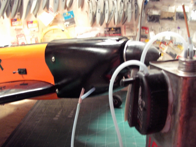

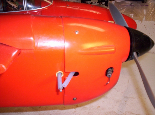

I would never use a fueling valve they are expensive and redundant as well as on occassion can cause running problems.
My preferred method is exactly as you do with your trainer except you make a brake in the carb line where it is accessable with a short piece of brass tube. That is where you fuel from. I have never found a glow plane yet with an unpumped fuel system that needed any more than a two line system. The exposed part of line supplies an easy place to allow pinch tuning of the engine.
John

if you have an open engine setup i would stick with two lines.... if you have a cowled set up i would use 3 lines (dual clunk).... one to fuel/defuel you would need a fuel dot http://www.hangar-9.com/Products/Def...?ProdID=HAN115 , a line to carb, and a line to the exhaust... the other option would be to use a y or t in the line...i try to stay away from that though...
