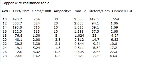

Some questions have come up about using extensions on servos, batteries, and so on for our RC aircraft. I got a PM from a forum member asking me about using extensions on digitgal servos and it got me thinking about it.
I found several charts defining various numbers for current for various gauge wires and came up with this one. I hope it helps.
These measurements were taken with standard copper wire at 72 degrees F or 22.2 degrees C.
Notice that the higher the AWG the smaller the wire is and the higher the internal resistance is and, of course, the less current it can carry.
CGr.

Nice chart CG, since servos have three wires, would we double the ohms per foot for the + and -, then calculate the signal wire at the value listed on the chart?

The current on the signal wire is so small that you can get by with anything physically strong enough to not break under use. The important wires are the positive and negative leads and even those pale in comparison the the problems a bad connector creates. If you have good gold plated connectors, you should be able to get by with 22 gauge wire in all cases. Be especially wary of connectors in servo extensions (avoid if at all possible). If you must use extensions solder in the necessary extra length by cutting the original cable in two and splicing in the extra length of wire.

Well, two wires are the power, black and red for some, black and white for others, and Spektrum/JR have their own color scheme, red and brown I believe.
The signal wire is not a current carrier, but I believe if you do get the HD version of the Hobbico servo extensions, all three wires are the same size or gauge. The main point would be the power or current carriers. They are equal in size and you don't have to figure the two-way current draw as the black - brown - whatever the neutral or ground wire is is the common for the power bus.
The original question was what size wires would be used for an extension for a digital servo that can draw as much as 3200 ma (3.2 Amps). Of course, that's not constant current, but worst case current draw and the Hobbico HD would probably be just fine.

I do not have a lot of the electronics reference books I use to, but I am thinking the numbers are for solid single strand wire, as a #10 multi-strand wire can handle a lot more current!

ByLoudDesign is correct, wire tables generally cover only solid wire. Stranded wire would have to be tested individually,
as all do not have the same number of strands or the same conductor diameter.

The gotcha with higher current draw servos is that the real limiting factor is the servo plugs. These "standard" plugs are typically not suited for higher current use due to their potential for higher resistance. The quality of servo plugs vary widely and you often get what you pay for. Good quality gold-plated plugs are best.

Srewinkel, I guess one main point here is that perhaps some don't understand how much current these wires can carry. When they start to get warm is when there begins to be a problem.. and the wires will get warm if there is to much current flow. Most of our applications will work just fine with what we have as basic, off the shelf components, with only the extreme examples, 3D, pattern, jets, large scale, & etc, planes that put heavier than standard load demands on the control surfaces, therefore, the servos and of course, the battery pack.

The "fusing" current of wire is much much higher than what your chart shows for normal operation and minimal voltage drops. Any amount of current "warms" the wire, just a matter of degree.
The problem for RC systems is that some receivers can lose the information in the RF processing section when current changes start modulating the voltage rail. I'm not sure if this is totally due to resistance or some inductance of the longer wires. Good reasons for heavier wire, higher voltage systems, and even an isolated battery pack for the receiver with a common grounding point.
