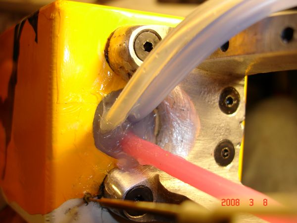

I have a Thunder Tiger Pro 46 that runs like a top at idle and full throttle and the transition is smooth. The problem is it is really difficult to start. Bring it in and gas up and same thing, it is still tough to get started. The "experts" in the club have played with it but can't get it to start like most of the others do...with a flip or two of the chicken stick. It takes 30 seconds or more with the electric starter to get it going. And often it floods and we have to pull the glow plug to clear it and try again. Once started, it purrs like a cat.

flooding? Sound like its too rich on the low end.
or you fuel tank is too high relative to the carb.
Also after every flight its worthwhile tipping the tlane on it side and drainingany excess fuel out via the exhaust. You'll be amazed at how much oil has accumulated in there if its too rich.

Idon't believe it is the engine nor do the experienced flyers. It runs like a top on the low and high ends once started and no problem in flight. So it would have to be fire or fuel. We replaced the glow plug but that didn't help and the plug glows ok when removed from the engine and hooked to the glow starter. But I am going to try the OS #8 plug as recommended in a post.
So it seems the problem would have to deal with fuel.
Now the centerline of the gas tank is nowhere nearly in line with the needle valve as I have read it should be. The needle is just a hair above the top of the gas tank and with the LT-40 there is no way to move it. But I don't think that is the problem either as there are other LT-40's and Senior Kadets running TT engines and they don't have a starting problem.
I don't know what it is but I am going to replace the whole fuel system (and pressure test it first which I did not do with this one).and see if that solves it. If not I will take you up on your offer because the engine is only a couple of months old.
Sure never expected a reply from you. One thing for sure, I will be looking at ACE for future supplies with this type of customer service.

Don't change the plug. The engine is already running fine!
Use clear fuel tubing from the tank and watch what happens to the fuel after you prime the engine.
I suspect the fuel is running back into the tank.
Also do you bring the throttle to idle immediately after priming? This helps prevent the fuel from siphoning back into the tank.

If you do not do so the fuel runs right back into the tank or fuel lines.
When you close the throttle this slows down the fuel movement preventing the fuel from siphoning back out.
Yes you prime at full throttle, then immediately bring the throttle down as you release the carb or exhaust.

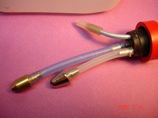

One thing I failed to mention. I crashed my LT-40 and the next time I flew it the engine would cut off on take off as soon as the nose got up. Turns out the crash knocked the pickup line off inside the fuel tank (it is a Dubro tank). I fixed it but did not pay attention to the holes in the stopper when I reassembled it and as a consequence opened up the 3rd hole. Of course when I tried to crank it at the field gas came streaming out. As a quick fix one of the guys put a machine screw in the open hole and it seemed to fix the problem.
It is not leaking gas but could this be the source of my problem?
Doubtful that's the problem as long as it's not leaking. Once you are running, there is positive pressure in your tank. So if the screw is leaking, then fuel will come out. From your description, I'm just about sure that your fuel is running back down your fuel line during the prime, not letting fuel into your engine. I have an Ultra Stick that does that because the nose sits up on the stand. It takes about 15 seconds for the starter to pull fuel up through the line to get it going normally and hand priming nearly impossible. But if I tip the nose down to level, it primes well and starts in a second or two. Tank position plays a huge role in how easy your engine is to start.

Why not use the third hole in the stopper for a second clunk ...like in a Uni-flow tank!Uni-flow will deliver a more even fuel flow.

The uniflow setup does do what it says, but it also sucks fuel back into your muffler when you let off the throttle. I had mine like that for a while as a beginner and gained 3 minutes of flight time when I changed over to a standard setup. Tuning wasn't any worse either.

We're in business.
I made a couple of small changes but I think it was mostly inexperience.
I replaced the stopper in the gas tank. I opened the 3rd hole earlier when a crash knocked the fuel line off. I plugged the hole with a screw and it seemed to do the job but I replaced the stopper anyway. I replaced the fuel line with clear so I could see the fuel as I primed it. Then I used the starting procedures as outlined by OPJOSE. I just touch it with the starter and it fires off........happy days.
Except, the first time I tried to start it after fueling I flooded it. As I attached the fuel line I noticed the line was completely full.
It would seem that the engine does not need as much priming immediately after fueling if the line is already full of fuel.
