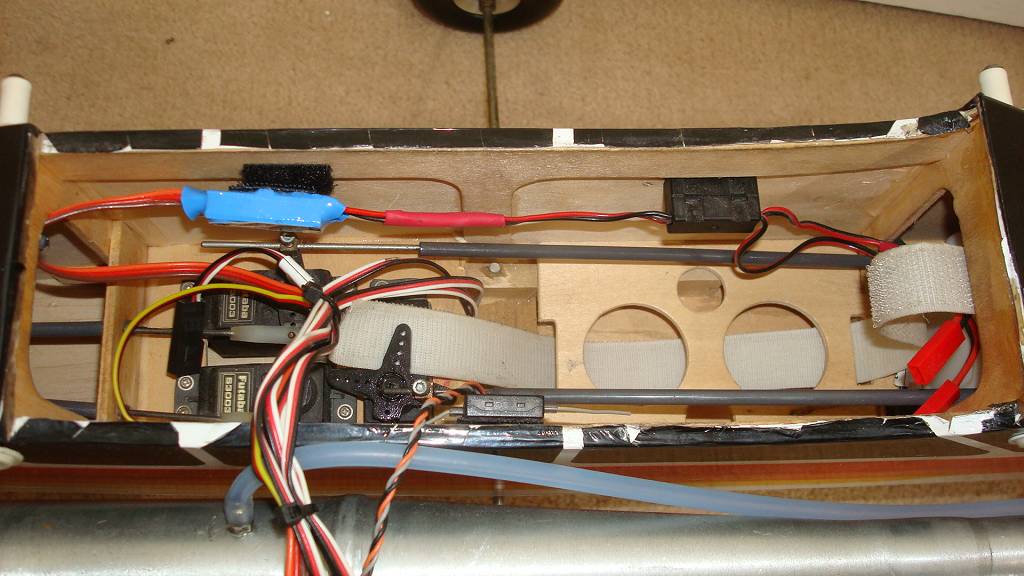

I can take some pics of mine but dont know how helpfull they will be.

1320Fastback's Avatar
Joined: May 2008
Posts: 998
From: Northern Occupied Mexico, CA
Default RE: Avistar Help!
I have modded mine to have Dual Ailerons so the wing tray is bigger than the stock set up but I kept the piece and took a picture of it also.
