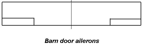

Does it have the strip ailerons or the barn door type?

Not sure what you mean by the stip ailerons or the barn door type. However I only have one servo in the middle.

Check these articles for wing repair:

Yeah.... typically, barn door relates to the size and shape of the ailerons. They are usually formed by building them, sort of like wing sections, but smaller. The strip ailerons consist of a single (on each side) strip of aileron shaped balsa that is in one piece and runs pretty much the entire length of one side of the wing (and of course, the other) as shown in the diagram LNEWQBAN posted.
We often refer to "barn door" as large sized control surfaces... not only for the ailerons, but for the rudder and elevator as well.

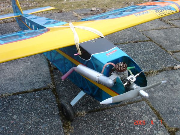

The only problem I would have with the ARF wing is getting it on the fuselage. My current one has 4 screws that holds it on and with the ARF needs rubber bands. Now that bring me to this question; What if or could I purchase some rubber band mounts and add them. So if I do this how would it affect flying the aircraft.

Rubber mounted wing is much better for a newbie!
In a crash the wing will get lose and hopefully will not destroy anything.
The only modification you have to do is drill holes in the fuselage for two 6 or 8mm dowels and glue them in.
In the pictures below you can see the dowels, in this case they are 6mm "Easton" arrow shafts, and let them protrude at least 3cm out from the fuselage on each side. Use at least six rubber bands!
