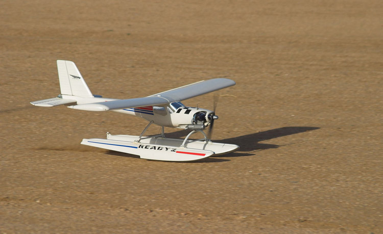

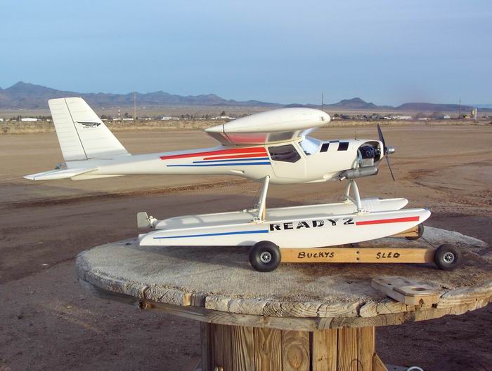

I have 2 Superstars, and 10" is the max you can run unless you extend the front gear and ran a little bigger tire. If you can get the front up a little bit, I would try a APC 11x4 or 11x5.
The LA 40 is the best running, easiest to tune .25 sized engine I ever owned.
I fly this airplane off desert hardpan and gravel with a well used LA-40 and a 11x4 prop, with no problems.
The trick is reducing the friction between the airplane and the ground for takeoff and in my case I stick some wheels between the two
Now what you need to do is reduce that friction between the airplane and the ground, just use big old wheels the biggest you can fit.
Big wheels, APC 11x4 and you will be fine.
