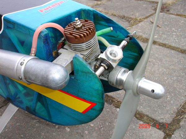

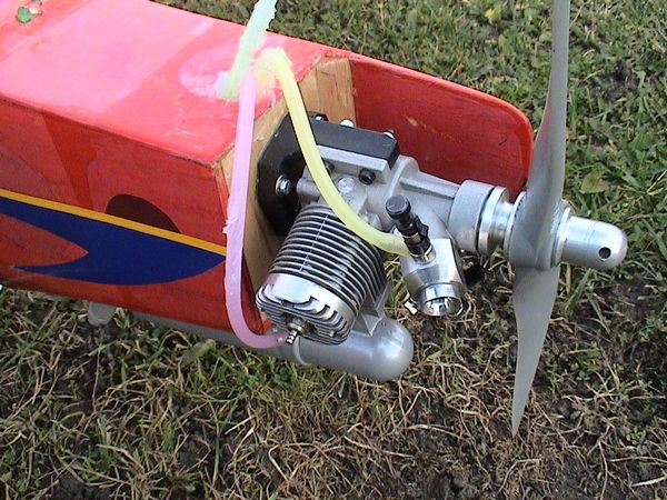

Hi!
You are running it too lean!!!
Some advise... get rid of that big plastic spinner and that no good MA prop. A much better solution is to use a spinner aluminum nut and a 11x6 APC or RAM prop. 10x6 prop is too small for a .46 two stroke unless it's for a Q-500 racer type airplane. A 10x6 will rew around 15000 rpm which is not desirable.
Do not use a too big tank! Use a 240-300cc tank (8oz-10oz).
Mount it according to the tank rule!
Use silencer pressure.
Set the engine by ear! If you can not ...get help from a friend!
Use 5-19% nitro fuel! Anything more is just a waste of money!
Use an Enya 3 or OS 8 glow plug.
