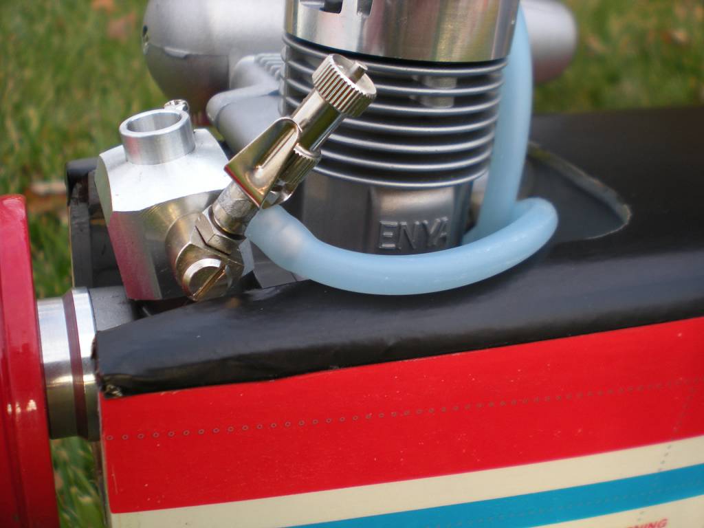

Here is the engine on my trainer:

Best tank to use, safest , with best fuel cap security of any available tanks is the Tettra tanks! The rubber expander that all of the other manufacturers use is no good in the long run! It will sooner or later leak.
