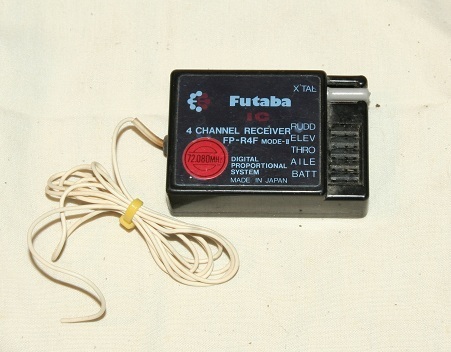

i just purchased 2 transmitters 1 hitec flash 5 fm. and<font class="Apple-style-span" face="Arial, Helvetica, sans-serif"><span class="Apple-style-span" style="font-size: small;">a futuba skysport t4vf tx. i got them really cheap and not sure if they will work with new recievers. i just learned that there a change in frequencies in the 90's. i hope this wasnt a waste of money. i also purchased futaba 4 channel reciever fp-r4f mode II. and 4 hitec HS-322 hd servos. the receiver is 72.080mhz i appreciate any help<font class="Apple-style-span" color="#333333" face="Arial, Verdana, sans-serif"><span class="Apple-style-span" style="line-height: 27px; font-size: large;">

well the hitec one is a computer base one it isprogrammable. so im assuming the receiver is somewhat up to date good thing is i only have 38 bucks in all of it.
72.080 Is not one of our hobby band channels and is illegal to use and became so long ago in 1991. Since the receiver has that crystal in it its likely the Rx is also an old wide band unit, is it Am or Fm ? if its Fm its probably not a dual conversion rx. probably should have been round filed years ago, You can check at the futaba website.
The Flash five is an older entry level computer Tx and legal to use as long as someone has not gone and switched crystals, you can only do that in receivers. That Tx untill fairly recently would have sold for perhaps twentyfive bucks around here but not anymore. Even old entry computer radios have become almost worthless.
The bottom line is at this time of change there is a flood of old crap being sold everywhere some acceptable and some even illegal and unless you are knowlegeable most people get burnt when trying to piecemeal a system together. get with your club or mentor before buying anything used. Heck for that matter anything new also!

That mistake is going to cost you dearly in the wallet and has already. That Rx is a vintage futaba AM rx and even without considering the fact that its almost certainly wideband (thats bad, very bad) it cannot ever work with either of those Tx's since they are FM units there can be no compatability.
Also those servos cannot plug to that RX no way! That relic was used in the days of the Futaba G plug that was 90 degree side plugging and had uneven pin spaceing, won,t work without a hugh hassel.
Trying to cobble up a package by sorting through all the crap that that is being peddled out there by people either ignorant of what they are selling (that sucks) or people who are just common cheats (thats worse) is certain to end up in failure.

Also as a past club safety officer I CAN NOT recomend a cabaged together system for a plane the size you are speaking of Care and caution need to be increased as the size of the aircraft increase. However I am a big fan of SPADS they are a ton of fun for the buck. GOING cheap on the radio is usually a poor experience though.
CG if you look carefully at the servo ports on the Rx the unequal spacing of the pins for the old 'G' plugs becomes apparent. Its a good thing to help in spotting the really dated stuff. Another point is that curious emblem with colored dots on the label puts the rx somewhere in the eighties.

so your saying the tx's would work fine with an up to date receiver? i onlt paid $6.00 for it so it a mistake i wont make again. i guess i kinda gothustled a little ive only got 38 in it all. it was a woman saying her kids were changing hobbies and was selling there stuff to pay for the new hobby. i think shestretchedit because if that thing is from the 80's then it is as old as i am. and i know my mom isnt paying for my hobbies anymore lol. well thanks for the advice. so what do you think i should use for the corocub?
The Flash five is by far the best of the two Transmitters I beleve it has five model memories and some basic computer functions The question of course is does it work and is it safe to use, I have no idea The battery pack could be questionable, is that safe to use I have no idea. A new pack is probably going to cost 40 to fifty dollars.
For a receiver you will need a negative modulation shift FM Rx. Can be either single or dual conversion but must have the appropriate dual or single conversion crystal that is the same channel number as your Tx. You can change receiver crystals but not Tx crystals.
Some Futaba Rx's that meet the above criteria will work with the Flash Five. Examples of Hitec Rxs which may or may not work depending upon whether or not they also meet the above Criteria: (Many were also produced as positive modulation shift and will not work with the Flash five as it is not shift selectable) Are the 535, 555, various Supremes, SuperSlim and Electron Six.
The servos will probably work you can count on at least one having been subtancial crash (note the broken lug) .
You also will need a suitable wall charger, a flight battery pack, a six inch extension and a switch harness isn't it amazing how we are now rivaling the cost of a brand new quality system?
You also need to be aware that buying a used Rx even more than Tx's is a complete crap shoot, best of luck.

The Flash Five is a good radio but the manual will be necessary as programming it is not intuitive. It is awkward. Hovever, if nobody has changed the crystal and the battery pack is good, it is a rock solid radio. Go for it.
ORIGINAL: mike.p
well the hitec one is a computer base one it is programmable . so im assuming the receiver is somewhat up to date good thing is i only have 38 bucks in all of it.
There are two versions of the Hitec Flash 5 transmitter. The original, and Flash 5 System X. I think yours is the original because I do not see a big "X" where it says Flash 5. I do not know all of the differences. The original has less features but I'm pretty sure it (or the Futaba) will work fine for a Cub style model.
If they have one in stock on the same frequncy as either transmitter, this is a super deal on a very good receiver
http://www3.towerhobbies.com/cgi-bin...I=LXMFU5**&P=0
$31.26 including the receiver crystal. It is compatible with the Hitec or Futaba transmitter.
Here is another option if the Hobbico is not available on your frequency.
Receiver $29.99 http://www3.towerhobbies.com/cgi-bin...?&I=LXKYK3&P=0
Crystal $7.59 http://www3.towerhobbies.com/cgi-bin...I=LXN503**&P=M
The servos in the picture will plug in to either of these receivers.

let me ask a dumb question. the crystals frequency are catorgized by channels ? if so why not just go by the frequency. so anynegative<span class="Apple-style-span" style="font-family: Verdana, Arial; font-size: 13px; -webkit-border-horizontal-spacing: 1px; -webkit-border-vertical-spacing: 1px; ">modulation shift reciever should work as long as it has the same frequency crystal. but why cant you change the crystal in the transmitter</span>
You cannot change the crystals in our transmitters without retuning by federal FCC regulation.
Remember concerning the frequency spectrum there is no 'middle of nowhere'. If you refuse to follow FCC regulation you indeed put our free and unlisensed use of the this band at risk as it coveted by many who will pay hugh lisense fees for its use.
I can only urge you to become a responsible member of the modeling community and do the right thing.
Frequency channels within a band and modulation shift are two entirely different issues. Agine for a tx and rx to be compatable, that means function with each other the both must be of the same modulation shift. Or either the Tx or Rx must be manual/auto selectable types so the same modulation shift can be selected (non of your stuff is manual/auto selectable)
Now there is also the separate matter that the Tx and Rx are both FM, AM or PCM If they are both not one of the three then agine no compatiblity with even more traps and snare if you get into PCM and propretary systems with those.
Finally of course the Rx frequency channel number must match your Flash five.
Trying to save a couple of bucks with used Rx's is just like Peeing down a dry well to find water!
You are already half way down that dry hole. Get local knowledgeable help before buying anything Its only gonna get worse and you will be wasting even more money.
