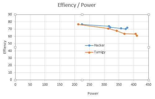

These are clearly not the same motors... These are just comparisons with charts and data range that do not make much sense.. True difference between the motors are seen in their effiency and at higher power levels. Better (and more expensive) motors with higher tolerances and better materials have better effiency. Smaller or cheaper motors have their effiency curves go up and down more earlier and therefore at lower power Turnigy is close to Hacker.
In other words smaller gaps (between stator and bell), better magnets and copper produce better effiency (but cost more to make..). Motors also have different bell design and Hacker's design looks to me like it's acting as fan too, which cools the motor when run longer periods which also improves the effiency on longer runs.
If you look at DrMotors measurements the "right way" you'll see that the Hacker has higher effiency at whole range. Higher effiency produces more power and less heat at same input power. Heat usually breaks the motors, so higher effiency motors produce more power per watt AND can take more input watts (without breaking up).
With biggest props (Highest watts) Hacker's effiency is at 71.9 % and Turnigy at mere 61,1%. That means that Turnigy produces over 30 % more heat at these levels (28.1 % vs 38,9 % of input power goes to heat the motor). Simply put, the Hacker can give more than 30 % more power out without breaking. Usually better (more expensive) motors use better materials which can resist more heat and have better design (airflow), so the difference might be even bigger.
DrMotors price comparison is on the wrong track as he is comparing prices in China without taxes and custom duties to local prices in EU with tax and custom duties included. To these chinese prices one needs to add shipping, custom duty and local VAT. Hacker is still more expensive, but it is also much better motor, so you get what you pay for.
These motors might even come from the same factory, but that doesn't matter as the factories make what the customer orders. If you order a 30 usd motor, they will make you a 30 usd motor. First question when designing a new product with a factory is the target price.. Same factories make different quality and different price range motors.
Here is a chart from DrMotors results with effiency / power.

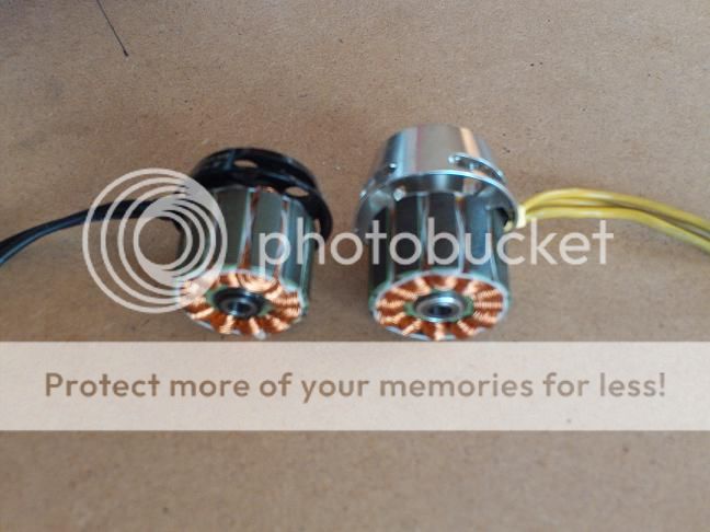

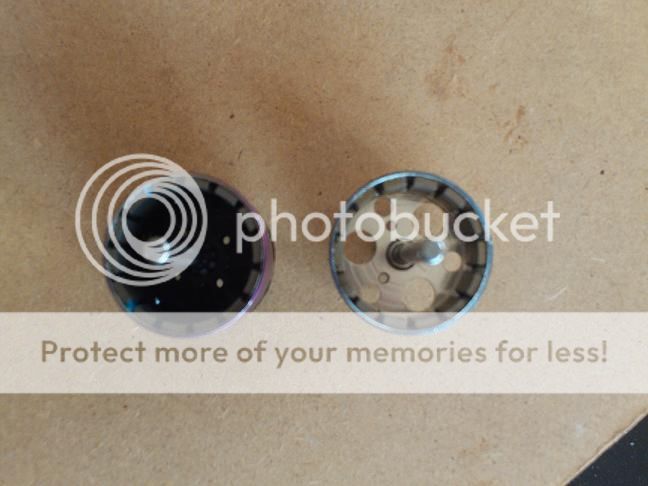

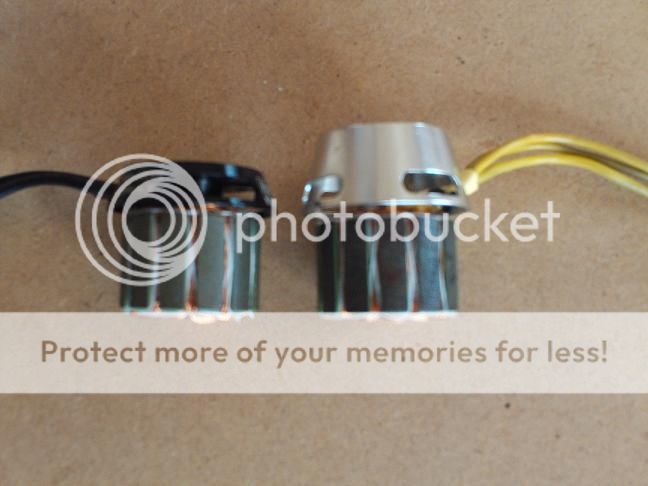

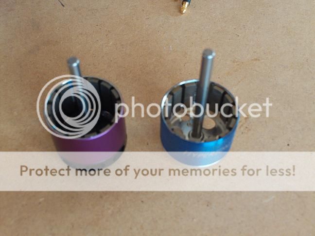

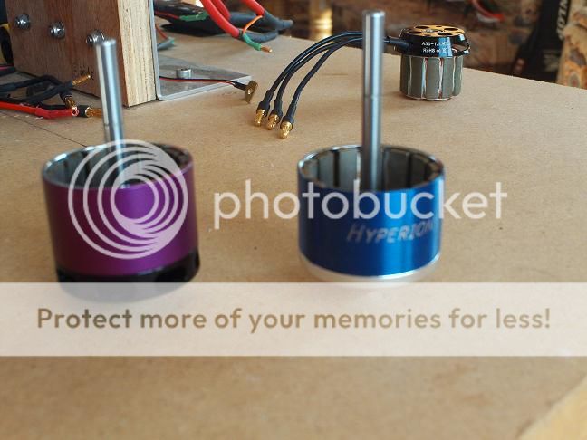

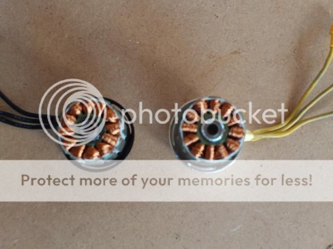

<span style="font-size: medium">PHOTOS COMPARING THE INSIDE OF THE HYPERION Z3019-12T and the Hacker A30-12 L</span></p>
Here are photos of the inside of the HYPERION and the Hacker motors, after the front circlip is removed, and the rotating can is removed from the stator. -As you can see, inside, these two motors are identical.</p>
a. They both have an identical 3020 (or “3019” stator … ). Both stators have 12 “arms” or “slots”. And both of the stators have the "white strands" on the outer surface of the stator, that has been mentined previously</p>
b. The stator is wound identically for both, and with the same copper wire.</p>
c. They have identical bearings.</p>
d. They have a very similar shaft -just that the Hyperion shaft is longer because of the longer nose of this motor.</p>
e. They have an identical diameter rotating can, both made with exactly the same thickness aluminium</p>
f. They both have 14 magnet “poles”, and the 20mm long magnets are identical in both motors.</p>
g. And both of the motors have CURVED MAGNETS -i.e. magnets which are curved on their interior surface.</p>
h. However, there were no blue deposits inside the Hyperion can, and there was no evidence that
the can balancing procedure has been performed.</p>
CONCLUSION: Once these two motors are taken apart, and we can see the inside of the motor -it becomes extremely obvious that the HYPERION Z3019-12T and the Hacker A30-12 L are actually the same basic motor.
And of course, this is precisely why the two motors produced the same readings on the Test Stand ...</p>
NOTE: We would never guess from the outside appearance of these two motors, that they are actually identical inside -or that they have exactly the same performance
