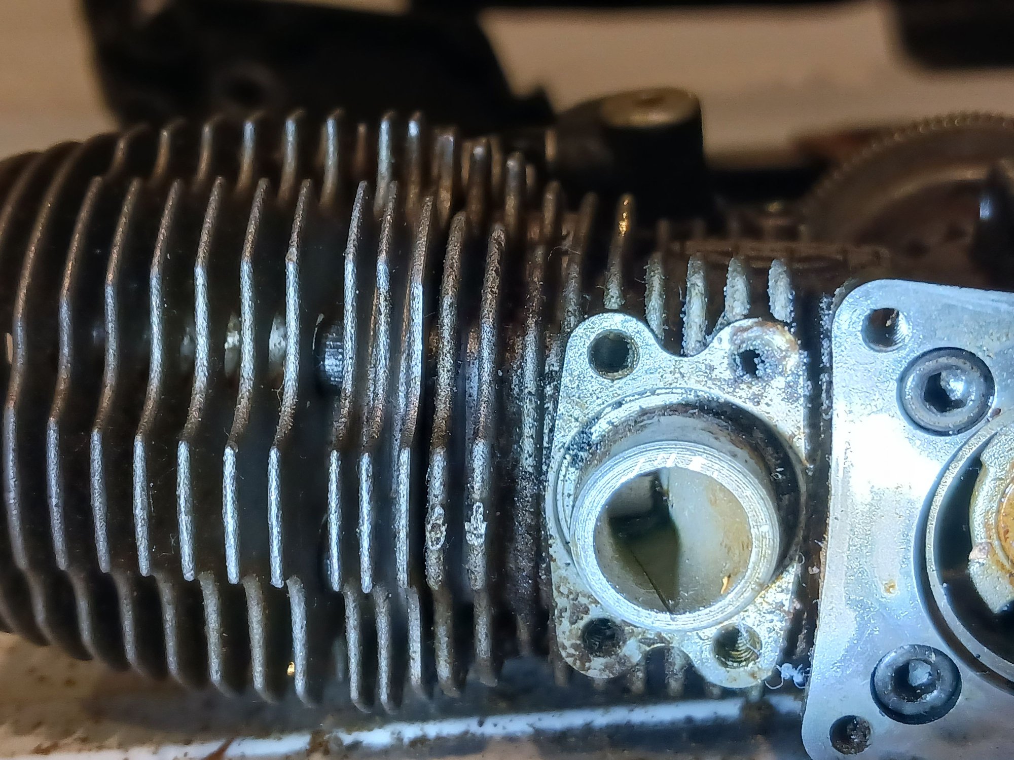

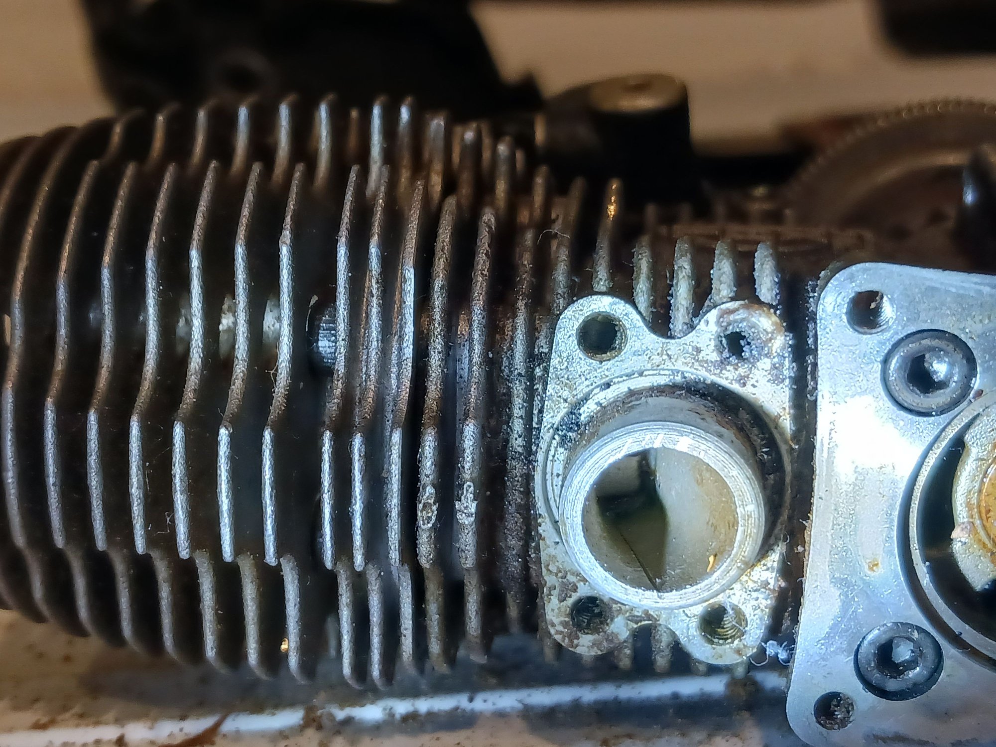

Hello.
I managed to get the Ez- start separated from the engine, & noticed a crack on the inside where the exhaust header attaches. There's a similar crack on the other side. I managed to unseize the Traxxas 2.5 engine yesterday afternoon using a heat gun & was really happy about. I see these cracks now & it has me concerned. I've got my ebay Traxxas rustler apart for a good cleaning, so I can make a shopping list for what I need.

Your pic is blurry. Where are these prospective cracks?

Sorry for the previous pictures. I went to a hobby shop this afternoon with the engine asking about the crack I noticed where the exhaust header attaches too. It is a crack as the shop employee pointed out & he said that I shouldn't worry about it. I have looked at Traxxas engines on ebay and other rc cars for sale which include an engine, as rc car engines at the hobby shops where I live are out of stock. I hope this helps.

That looks like a casting flaw to me; if it were a bonafide crack, the crack would manifest itself through the whole surface. I don’t see evidence of that; I see what appears like a superficial scratch in the internal surface only. That said, if it is indeed cracked all the way through, and the dirt and grime is masking it, replacing the crankcase would cure the trouble. I happen to have several 2.5 crankcases that I will never use. If you want them, you can have them for the cost of shipping.

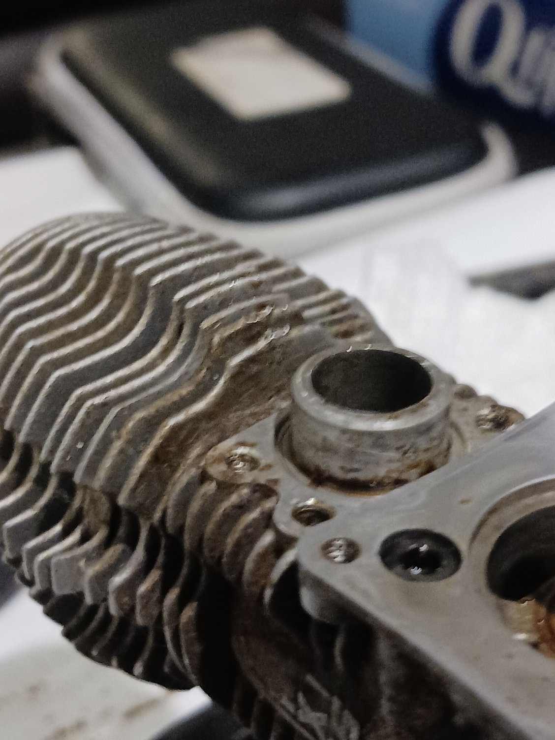

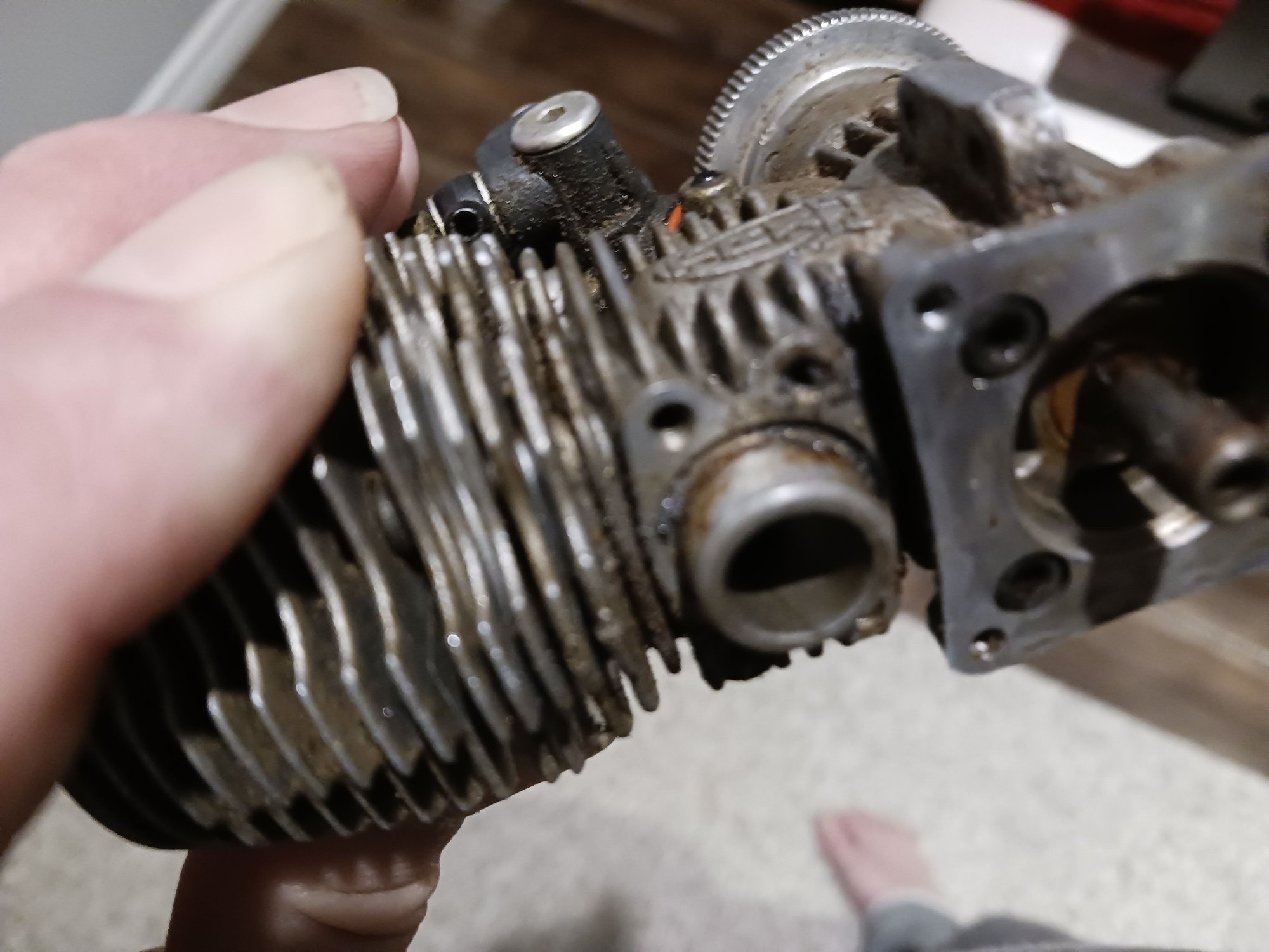

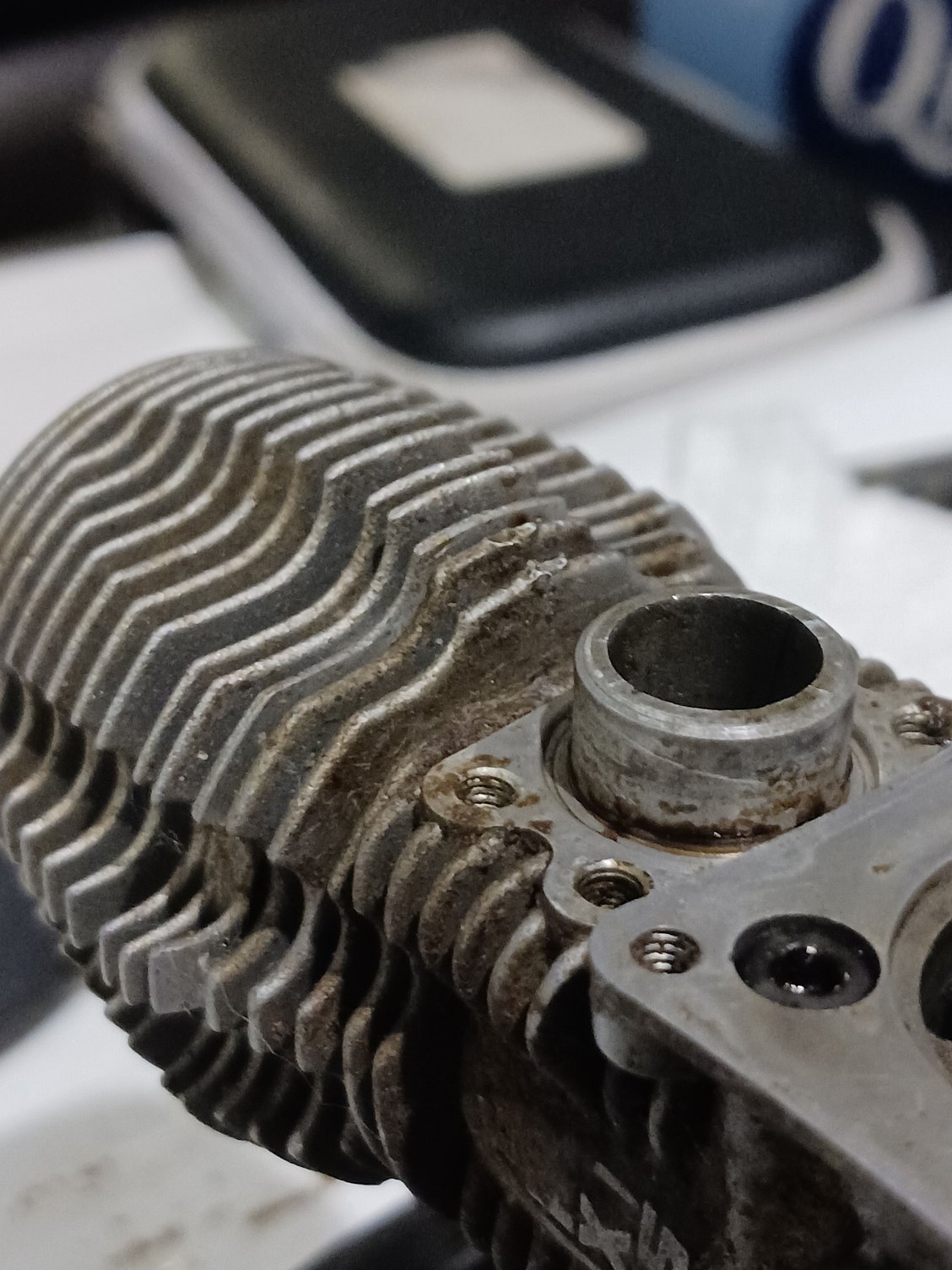

I cleaned the outside of the engine this afternoon and saw a scratch unless this is another crack. I looked at the anomaly further on the way home, & it starts at the top then goes down to where the backing plate would be. I have looked into a Traxxas parts car on ebay which includes an engine also.

I don’t see anything alarming other than the corrosion. If the manifold leaks when you run it, put a little RTV around the o-ring (looks like your case is missing the o-ring currently) before cinching the screws down. As long as it doesn’t leak, it should be just fine.
