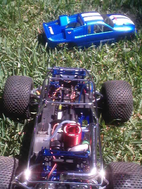

I'm ready to start my new fantom .18 in my t-maxx.The manual say's start and run in truck @ 5 to 10 sec blips,checking/setting the highspeed needle as you go.My question is,does it have to be running down the street,5 to 10 sec's and I'll be chashing her down the next subdivision,lol. Can I remove the tire's and breakin the engine on a stand? Would that not be better,no lost control,no running into stuff,easier to tune?How are you folk's breaking in your t-maxx engine's? Any help will be great!!!!!!

don't do that, the engine has to have a load on it when breaking it in, which is why they say to run it on the street, there won't be much lost control with an engine on break in, you should be running really rich, and the car won't pick up speed....also, a tip, we've gone over this a million times, so please search the forum about it...check out www.rbproducts.com and click on forum to see more ways on break in.
