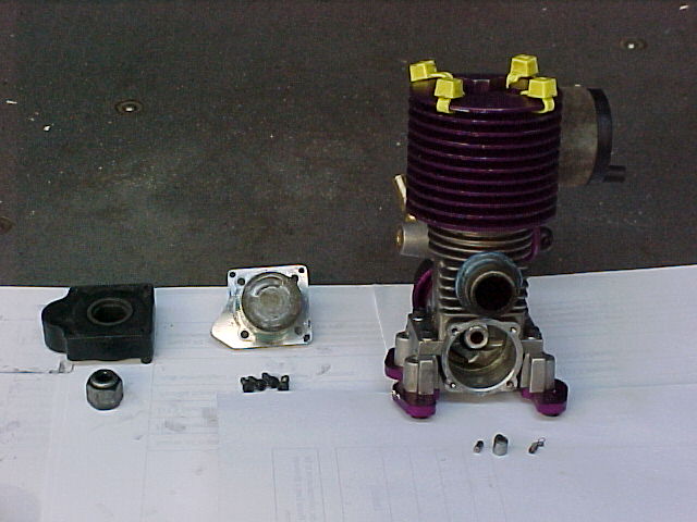

I have taken the engine out of the Buggie to have a good look at it. When I turned the engine over there is damage to the bottom of the engine from the inside, it looks like something has blown in there and tried to punch through the bottom of the engine, plus there is also a rattle inside the engine DOH. Well since I have only had the Buggie for 3 weeks I will take the engine back and see if they will replace it as I am sure that the engines are not meant to come apart like that on the inside ?

Ok have had a bit of a look and it seems the crank has snaped in half is this normal for a 3 week old engine with only 1 1/2 gallons of fuel run throught it or dose it sound like an engine fault.

That would be an engine fault lol. I dont think any amount of thrashing would do that. I should think there was a crack in the crank shaft. As they dont crack test them at the factory afaik. A crack in a shaft is dangerous due to the high torsional loadings on it, so it would fail quite easily. (i would go into the maths but i cant be ar$ed).
Sounds like a manufacturing fault, just hope the hobby shop understands...

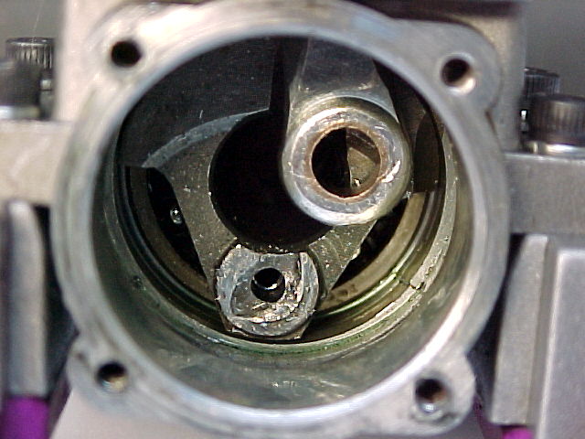

I have been to work today and took my engine back plate off and had a look and this is what I found.
I have tryed moving the Piston and it is free and moves ok, So all I can think of is that there was a fualt in the crank. Which cursed it to fail ? If anyone out there has a better idear on what could have happened? Plz can you put a post here as I am taking the engine into my LHS tommorow to see what they say.

If everything is free to move then i would just say that there was a fault (crack) in the crankshaft. Like i said the loadings on the shaft are large. I didnt realise it was the pin that was broken, the forces on this are different but again large.
There is no reason why that should happen on a good crank shaft, you would have to give it some hell of abuse! I would certainly say its a manufacturing fault...IMO

Well I took the eninge into the LHS that I got my Lightning2rr RTR from and the first thing he said was "where was the rest of the buggie" as I had taken only the engine with me. He then told me that the warrenty might be void since I had taken the engine off myself and he had not ?

I have just been told that my engine will be replaced under warenty butthey want to try and fix the old one first and if they cant they will send a new one.
