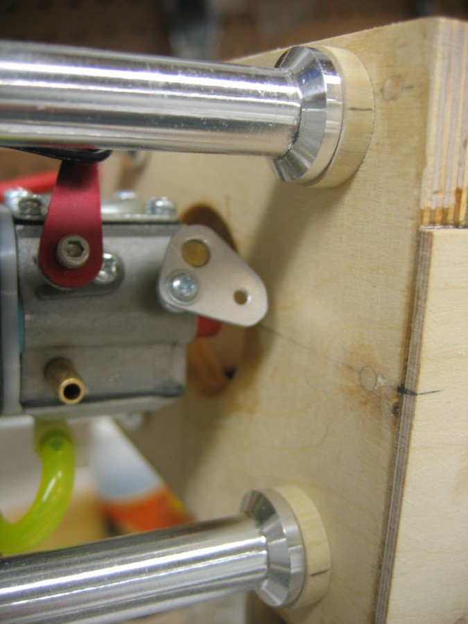

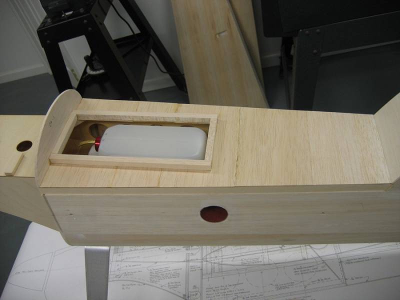

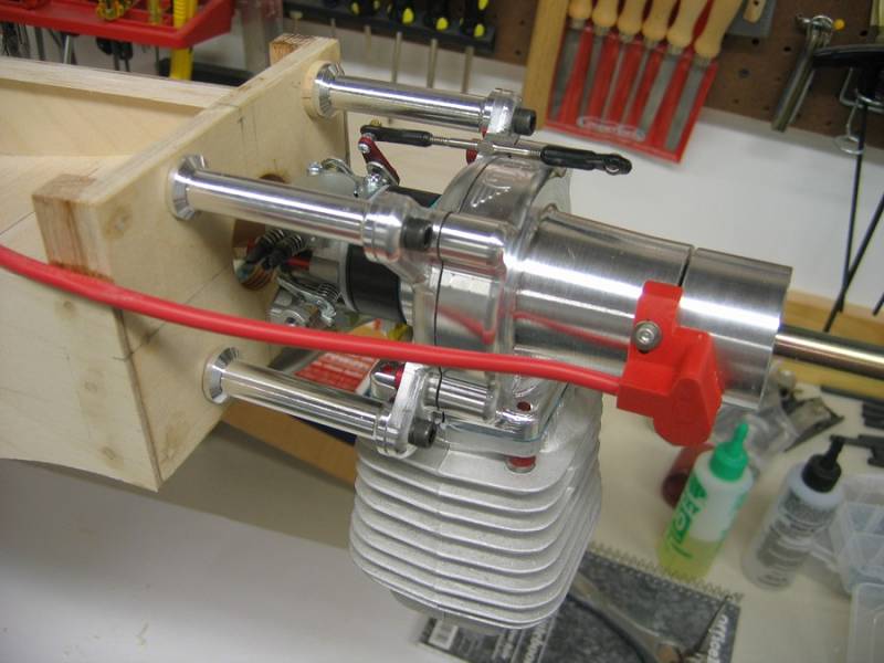

last night I made the 2 1/2 degree wooden standoffs that give the engine the right amount of offset.
and today I got the engine mounted...Everything is looking good so far.
Steve

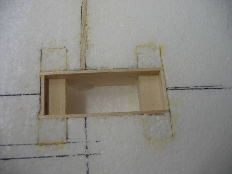

Old 06-14-2006 | 07:09 PM
  #34
My Feedback: (10)
Joined: Oct 2003
Posts: 450
From: Mohnton, PA
Default RE: Another Cuda Build

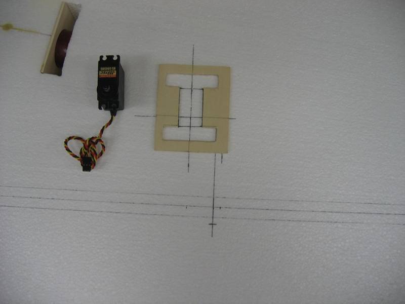

Back to the wings.

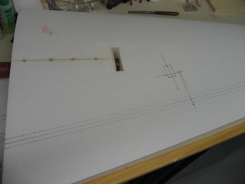

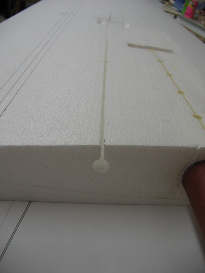

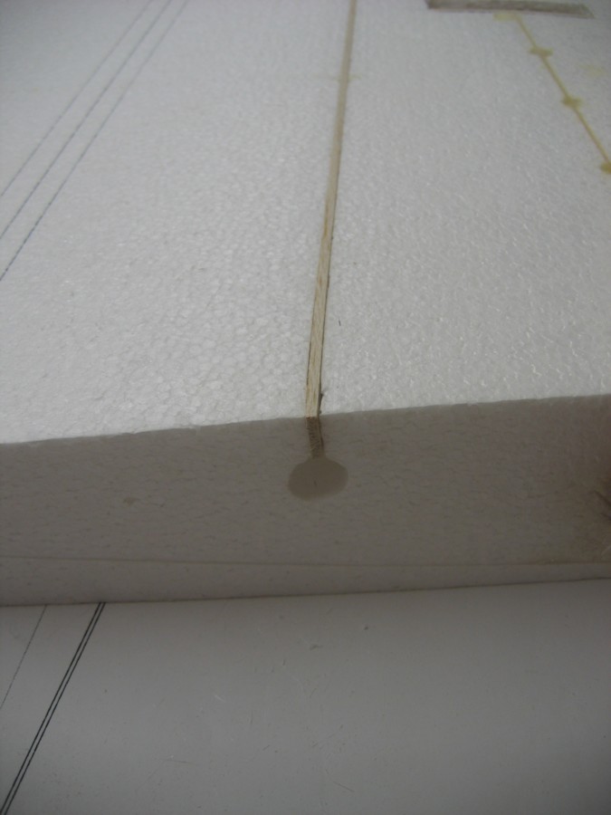

Tonight I laid out the aileron and servo locations on the wings.
I use a plywood template and bend copper wire that I put in my solder gun to cut out the foam.
the last two pictures show the "tunnel" for the servo wire. After I melt the tunnel out I back fill the slot in surface of the wing
with sheet balsa sanded down to fit the slot.
The 1/4 x 1/2 servo rails have been expoxied in place. I will back fill extended sides with scrap foam, give the wings a light sanding and they will be ready to be sheeted this weekend
Steve

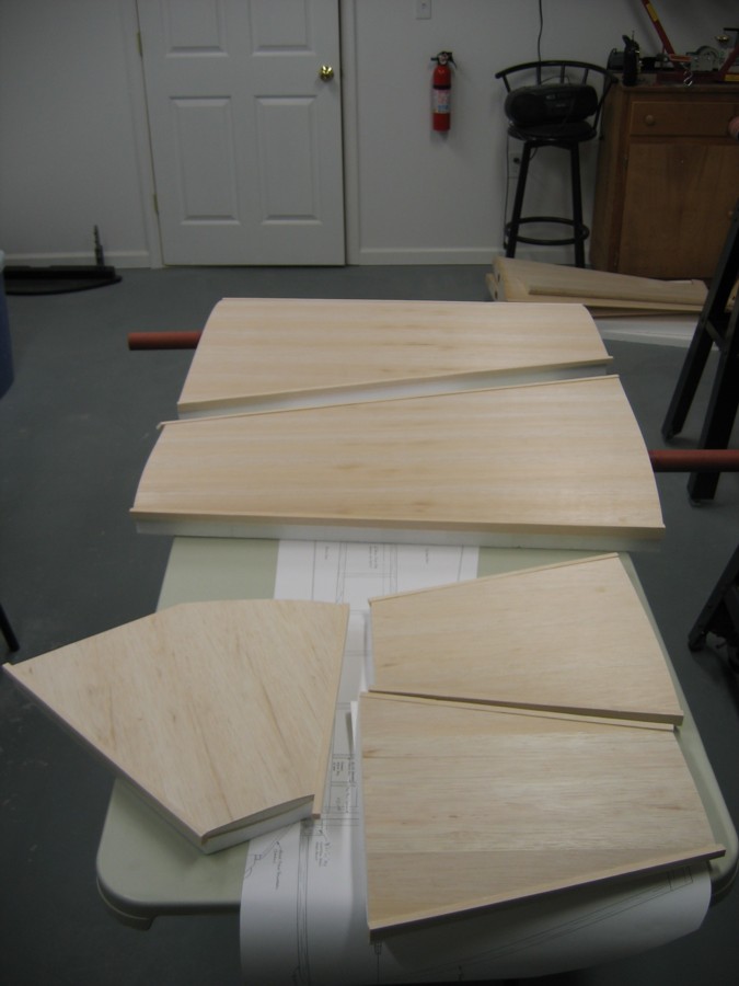

All the foam has been sheeted and the leading edges installed and planed / sanded.
Next up, cutting out the ailerons, elevators and rudder.

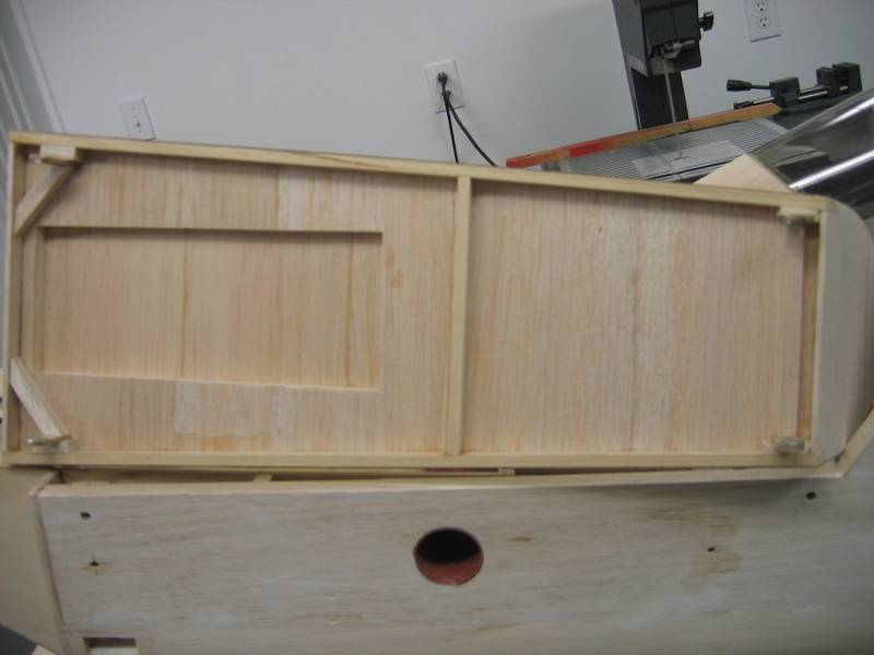

Old 06-26-2006 | 07:17 PM
  #37
My Feedback: (10)
Joined: Oct 2003
Posts: 450
From: Mohnton, PA
All of the control surfaces have been cut out. I added the leading and trailing edges to them and planed and sanded them flush to the surface.
Next I drew center lines and hinge locations. I also drew the angle of bevel on the end caps and line contecting them from end to end as guide when I plane and sand the bevel into leading and trailing edges. I then made the holes for Robart hinges and checked the fit and did some touch up sanding. Take the time make sure you have a nice tight fit with the hinges installed. It's hard to go back and fix once you cut the angle into the edges.
In these pictures the hinges have been inserted (but not glued) into all the surfaces. Tomorrow I will get to work on beveling all the surfaces.
Steve

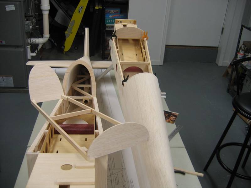

Old 07-06-2006 | 07:27 PM
  #42
My Feedback: (10)
Joined: Oct 2003
Posts: 450
From: Mohnton, PA

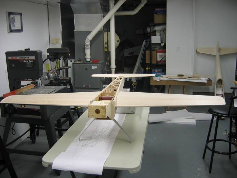

Today I got the horizontal stab installed on the fuse.
Here is pic with the wings and stab waiting for the fin and then the top deck...my Cuda is waiting in the background
Steve

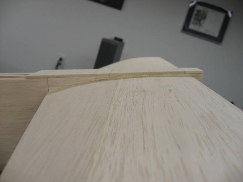

Old 07-09-2006 | 06:38 PM
  #43
My Feedback: (10)
Joined: Oct 2003
Posts: 450
From: Mohnton, PA

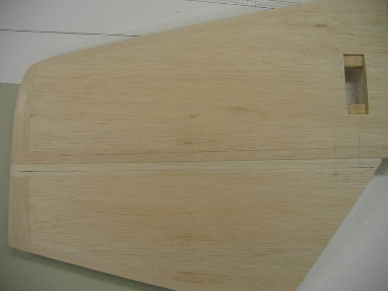

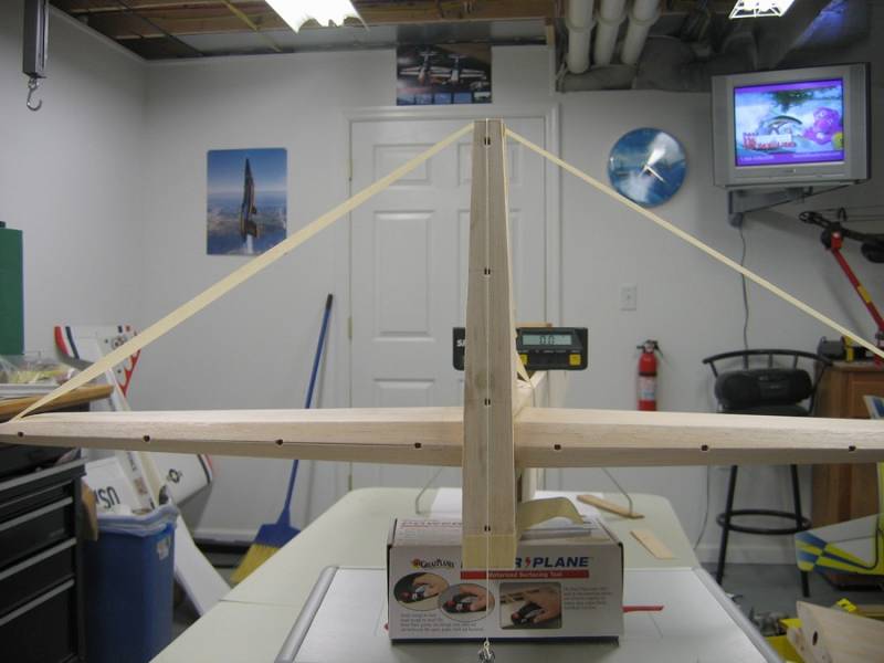

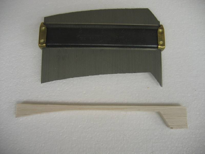

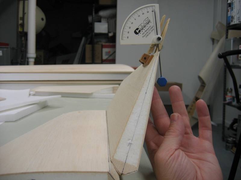

Once the stab is installed you need to rebuild the top of the fuse previously cut out to install the stab.
I use left over 3/8" sheet and a contour tool. Some careful shaping and sanding and you can get a nice tight fit.
After that, you add some 1/8" sheet to the top of the fuse and then install the fin.
I use 2 different references to get the fin square. (1) I draw a center line down the fin and I tape a weighted string to the top of the fuse.
make sure the fuse and horizontal stab is 0 degrees side to side and the string will hang right down the line on the fin when it is square.
I also measure from the tip of each stab to the top center of the fin. Make sure they are equal and the string is still right down the line and that's about as square and true as I know how to make it.
Steve

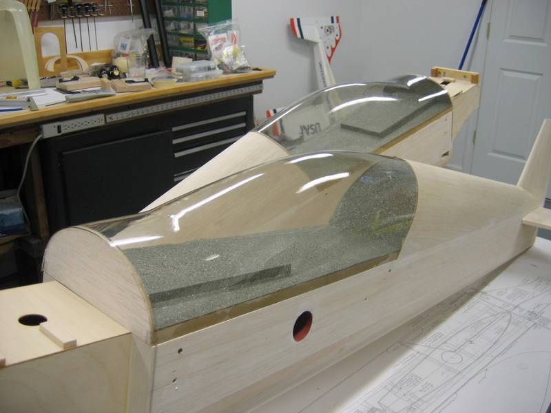

Old 07-21-2006 | 06:56 PM
  #47
My Feedback: (10)
Joined: Oct 2003
Posts: 450
From: Mohnton, PA
Got the canopy frames finished and sprayed with speckle paint.
I tried to tint the canopys but the the plastic did not take the dye at all. They came out with a very very light smoke color.
definately not worth the time and money.
I'll get the canopys glued to the frame tomorrow and the cowls mounted.
this pic shows the frame before it's finished with a little raised area to clear the gas tank
Steve
