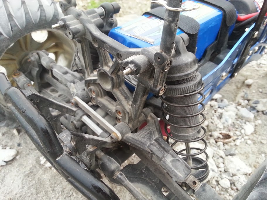

Well, between 2 kids, a job and a girlfriend...I've found the time to make this mod.
As I have converted the truck using CENs conversion kit, I wanted to save as much weight as possible, keep the truck as hardcore as possible and if possible, even make it look better.
It turned out to be quite simple.
You need the following:
4 x LST shocks - ebay is a cheap way to get them, fully assembled
2 x LOSB2900 plastic shock parts - the bonus here is that you also get spaces and other extra parts you may need if the driving gets too rough
1 x LOSA6242 caphead screws
1 x 3mm threaded rod at least 28cm long
8 x spacers/standoffs at least 7mm thick. 8mm and thick enough is the optimal solution
8 x washers 1mm thick - these are needed IF the standoffs are not wide enough to stop the shocks from travelling all the way to the tower
The rear area (where there is a hump at the end) of both TVPs need to be cut down to make space for the broader springs
EDIT: Hold on with the cutting of the TVPs. I'm looking at another solution so the rear shocks can be configured more freely.
Pros
Weight saving
It looks damn sweet
Cons
Mounting configurations are limited due to lack of space
The front shocks are exposed to the rocky elements - a fix to mount them behind the arms appears to be quite a challenge with, perhaps, reversing C-hubs, longer toe links etc etc etc
How did I do it?<ul>[*]Shave/cut/grind the rear ends of the TVPs in order to fit the shocks. Check the first picture for a better "explanation".[*]The original long screws can be reused for the lower mounting holes.[*]Cut the threaded rod into 4 x 7cm pieces. These are needed for the upper mounting posts.[*]Put everything together...[*]You can reduce the length of the threaded rods if you want a cleaner look. Around 6.5cm is probably the minimum length.[/list]

Here is a size comparison.
Savage vs Losi LST vs CEN Genesis

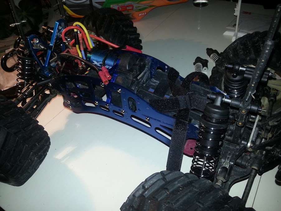

I will weigh the shocks again soon but I recall the LSTs are much lighter than 2 CEN shocks. This includes oil of course.
I don't have easy access to various large shocks so had no idea the Matrix shocks were an option. I just had a peak at them 5 min ago and see they are 16,5mm wide where the LSTs are 34,5mm. I think I will still keep the LSTs. You are welcome to send me 4 Matrix shocks for testing
As I am not totally finished with building the truck (may pop a 1850kv outrunner in it instead due to the Tenshock getting warm at the moment) I will also wait with the final weigh-in.
Another item that definitely needs changing, are the springs. I am searching for stiffer springs and I think ravenrc are the winners at the moment. The standard LST springs sag quite a bit and aren't as springy as when they are mounted on the actual LST which is also much lighter than the CEN mega beast.
The conversion is straightforward and rather simple, however it can be noted: mount the center diff, then mount the battery holder, then the ESC plate - it's a mission doing it the other way round.
A few irritations I have with the conversion kit is that CEN could lower the price even more by just including a mockup so we can drill the 4 holes required in the TVPs ourselves. It's also a bit sad that the TVPs have not been "cleaned" up so they are only for brushless systems. They are pure copies of the standard TVPs, with 4 extra holes...
If I wanted a nitro motor in it again, I would just use the old TVPs.
One issue I had, while testing on 4S, the rear outdrive from the center diff twisted and broke!! I'll upload a pic soon, but I was quite amazed as the load was low and the item was brand spanking new
I am using 100k diff oil but it still feels easier to turn the outdrives than the original center diff from the nitro gearbox so I don't think the internal load is too harsh.
*****EDIT!!!!*****I would like to apologise to CEN for the above, it appears I chose the wrong setting on my program card for the forward/reverse settings. The motor went from forward directly to reverse
. It appears the outdrives can't handle this power shift
After waiting 2 months!!!!! it appears CEN will finally be sending my part 2 of 1 package this week. When it arrives, I'll be cutting my own motor/diff mount and building the 2nd Genesis I have in pieces at the moment.
Anyway, that was todays rant...I'll be back with more details for you, as soon as possible.

<div>Powered by:</div><div>Turnigy 600 H37402 Brushless Outrunner 1760kv</div><div>11T Topcad pinion</div><div>66T CEN Matrix spur</div><div>Turnigy TrackStar 150A ESC</div><div>1 x 6S Turnigy 5000Mah lipo</div><div>2 x 3S Turnigy 5000Mah lipos</div><div>Sävox SC-1256TG 20kg steering servo</div><div>Turnigy GTX3 AFHDS 2.4ghz 3 channel transmitter</div><div>Waterproofed HobbyKing GT-2 3 channel receiver</div><div>Standard CEN Racing 23mm hex wheels and tyres</div><div></div><div>Top speed</div><div>61.9kmt</div><div></div><div>Size</div><div>1/8</div><div>Length: 587mm</div><div>Width: 467mm</div><div>Wheelbase: 397mm</div><div></div><div>Weight</div><div>7.5kg without batteries</div><div></div><div>Extra gear</div><div>CEN Racing brushless conversion kit</div><div>Center diff cross-pins</div><div>Xtreme-Cross-Racing front aluminium shock tower</div><div>Losi LST shocks with RCRavenInc Dual Rate stiff springs</div><div>Receiver and ESC have been waterproofed with plastidip</div><div>CEN Racing 23mm hex wheels and Sniper tyres</div><div></div><div>Notes</div><div>Big thanks and kudos to Kristian L for both inspiration and LoAdS of help with the rebuild 8)</div><div>Build thread can be read here: http://rc-forum.dk/index.php/topic,397.0.html</div><div>Front and rear center diff outdrives were mashed during initial testing. Older versions are in use and new ones have arrived, thanks CEN
</div><div>To be installed:</div><div>8 LED light-set (sorry Savage… )</div><div>Home-brew wheeliebar</div><div>Home-brew center skid plate
