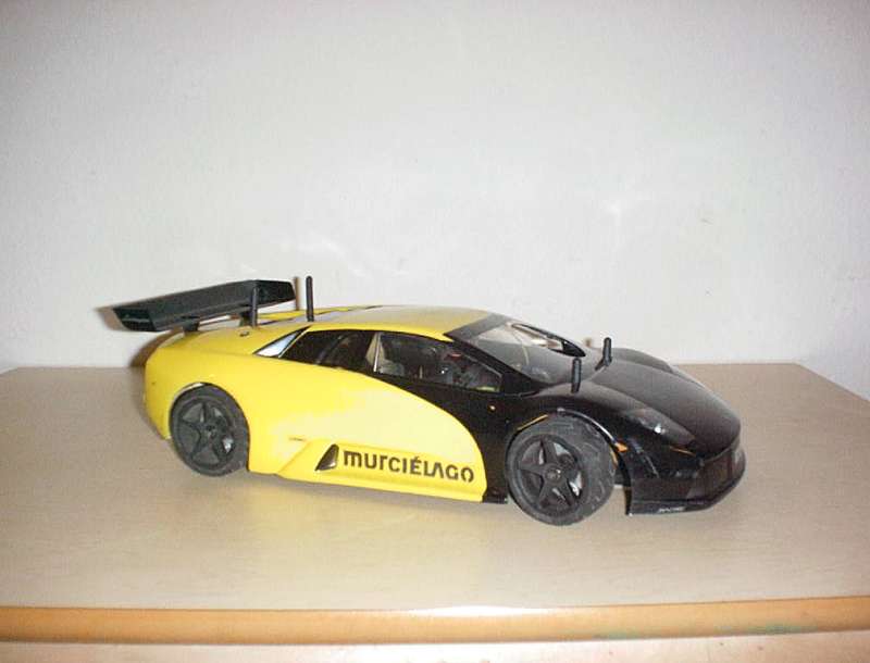

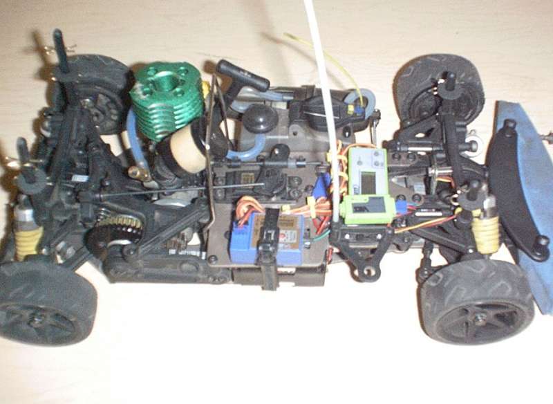

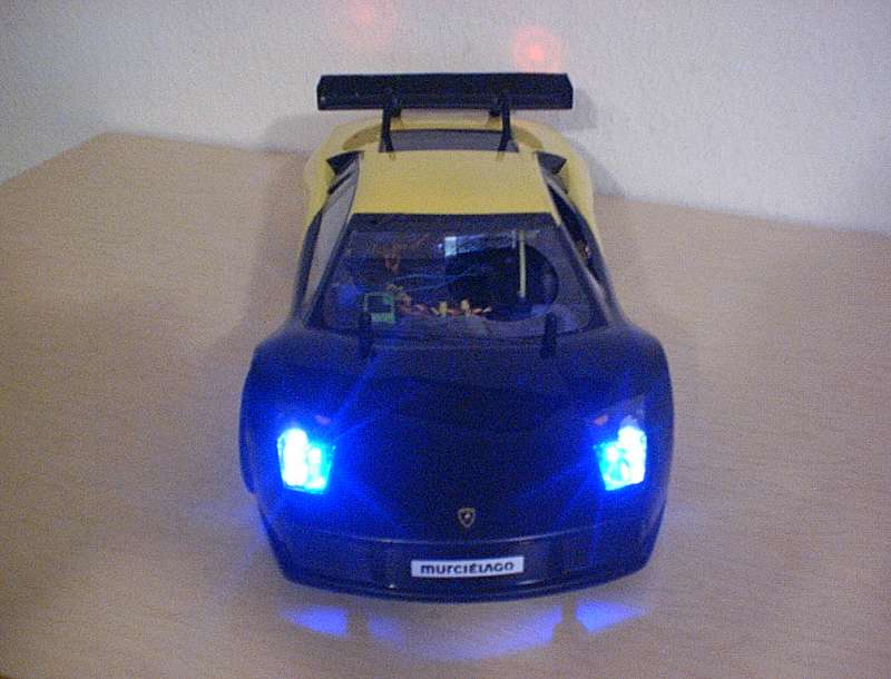

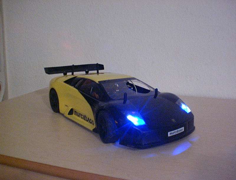

New pics. I repainted the front end on my Murcielago body, due to a 30+ mph head-on into a wall, and added some new parts and up-grades to my CT4S.
Parts and up-grades... MX-3S Radio; Metal Brake Disk; Metal 43T Spur Gear; Hitec 625 BB Servo; Light Kit; Hyper-Valve; Venom Speed meter; and Venom Fail Safe. More to come later...

Most important! WHERE DO I GET THOSE LIGHTS? i live in australia, and have been trying to get lights for the under side of the body to get that Fast and the Furious effect, but headlights will do. i have got a 200mm HPI Lambo shell and painted it HOT ORANGE, looks great but would be better with some lights. got any tips?

Using the 16T pulleys in place of the 25T pulleys will really help in acceleration. You will also have to change out both the main drive belt and the rear belt if you want to do this swap. (Main belt would be CT019 and rear belt would be CT011) I am not sure what the Competition drive train consites of, but its part number is CT045. I will be getting this part eventually.
The aluminum pulleys are great for better pulley strength and will last a lot longer than the plasic pulleys. (CTS16 for the 16T; CTS17 for the 17T; and CTS29 for the 25T Aluminum pulleys)
If you look for "CEN Racing", he has made quit a few posts on up-grades for the CT4S. If you look up parts numbers for the CT4S and the part numbers letter ends in "S", most cases its an up-graded part. "CEN Racing" is a real big help in all CEN products. He accually works for CEN RACING.
I replaced the 42T plastic spur gear (the green gear) with the 43T metal spur gear from the Genesis. I got tired of replacing the 42T spur gear. You may want to look into getting this gear.
I got my light kit off of E-Bay. I paid about $30, US. I will try and find the persons sight on E-Bay that I got my kit from.

thanks for that info. much appreciated. and if you could find out about those lights, i would be even happier. i have seen the CEN racing guy's name around. i will try to track him down and see what he recommends as well. thanks again.

mmm interesting i think i need the pulleys done on mine have u got a list of all needed components to do this acceleration conversion plz...
p.s. ur lambo shell looks HOT!!!
oh i forgot! what size shell fit best on the CT4s is it 200mm or 190mm??

I forgot to answer your other question stall1on. The CT4S uses the 200mm bodys. You might beable to us the 190mm depending on the type of body you us. The Lamborgini body I am using is a 200mm and it fits tight. I would stay with the 200mm bodies.

good cos i got a murcielago shell 190mm and it fits but not well could b the key to the success eh!! i'll now try a 200mm
wel ur one looks proper fatt as we say in London!!

There is not a metal spur gear set for the CT4S/R. But you can use the metal 43T Spur gear from the Genesis. Part #GS087. You will be replace the 42T plastic spur gear. The second gear from the Genesis will not work. But I have not had any problems with the plastic second gear. It was only the first gear that kept on losing teeth. Look at toyhaus.com for parts.
