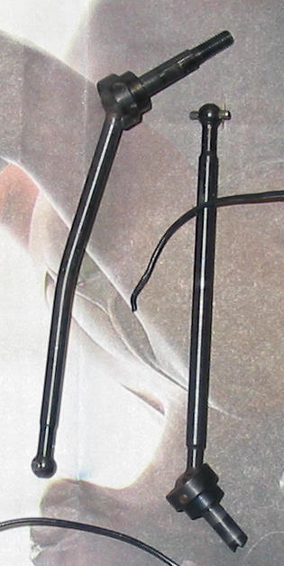

Is there a substitution for this part that will not break at the wheel so easy? I have read how to strengthen
at the cup but not at the wheel.
Thanks as always
Thanks as always
I dont think there are any aftermarket options other than CENs' own replacement cvds'. If you keep track of the thread titled 'Tmaxx wheels have arrived', Poor Judgement is experimenting with different cvds from HPI. I am sure he will update everyone with any progress he makes. Until then you could always try to straighten them.
I have tried to find a replacement but not successful yet.... I'll wait till poor judgement's findings to continue with mine... what did you hit to bend the drive shaft like that.. usually bend at ends.... that is easy to bend back as the metal cen uses is fairly bendable... at around $30.00 for the pair make them last...

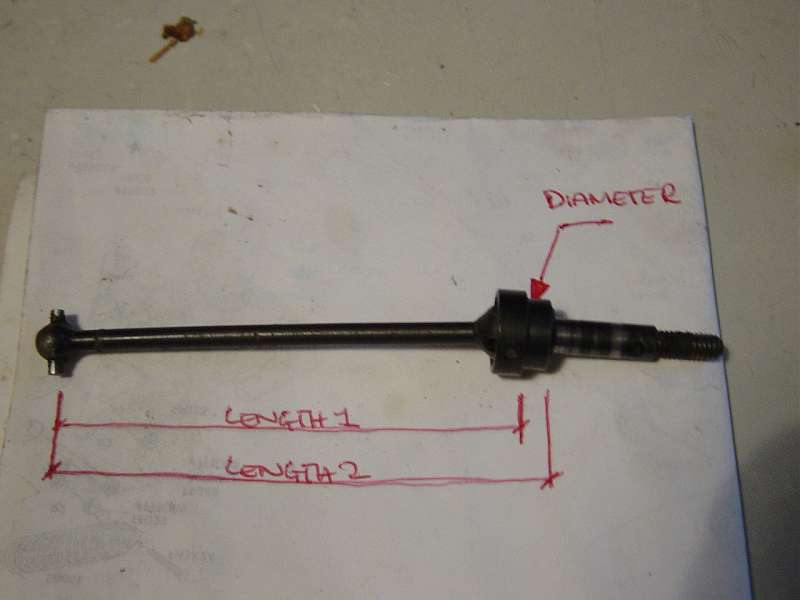

while we are back on the shaft subject - could someone measure up the cen mt shafts, and post the measurements on here, as, embarrasingly, i still only have the rally shafts here. the more info i have to work with - the better.
My MT shaft measures (from drive pin center) as follows: Length 1 = 89.55mm, Length 2 = 92.75mm, Diameter = 9.95mm.
I believe the rally shafts are more resistant to torsion than the MTs because they are shorter.

thanks for that mate - i am gettin there slowly in the hpi forum in the monster truck section - well... i think im gettin somewhere
thats just the info i needed. thanks for takin the time to do that.
and yea, the rally shafts dont suffer as much, but with my .18 engine, i am suffering with twisted rally shafts as it is, so, like u say, i expect more trouble with the mt shafts unfortunately, which is mainly why i havent paid for any yet - besides the fact that they are way over priced for the quality of them...

I hate to bring up an old thread. But, looking back to the first post here I notice that the shaft is bent and broken. Now, the break more than likely happened b/c of a bend in the shaft itself. I had a pin at the cv break off and I fabbed a new pin out of a small nail. When I put it back together I noticed the shaft was bent a little from a previous wreck I had. I straightened the shaft on a flat surface w/ a small hammer and used a short ruler for a straight edge. The pin broke b/c I did not notice the shaft was bent after the wreck. I have ran 4 tanks through since I fixed it and no problems. I can't help but think that a lot of these shafts breaking is caused by people not checking their shafts for straightness on a regular basis. These shafts can be straightened very easily and replaced if you can't straighten them. If you repair them b/4 they break you will lessen the chance of breaking a diff cup. Vibration is the worst enemy for these components. If you have had a front end wreck make sure to check the shafts for straightness. All you have to do is hold the truck in the air and spin the wheels slowly. You will be able to see the shaft dip a bit if it is bent. If it is replace it or fix it b/4 you drive again.
I have found this truck to be pretty strong but there are some spots that need stiffening. I don't think these shafts or the diff cup are weak spots at all. But if you don't keep an eye on them they will become weak.
The stock motor or even one that has the .18 conversion in it does not need the bigger cooling head.
The bigger cooling head over cools the motor and leads to tuning issues, and the cvd's and the diff cups are definitely weak spots.
I had some pretty bad crashes with my truck and have never broken an axle there.

And with the CVD's its the same story when they break right up by the universal, again take a look at exactly how much metal was actually holding it together, with the CVD the slot they machine into it on the ball part actually weakens it substantially as the slot pertrudes all the way into the main shaft.
As for them twisting and breaking (at the dogbone end) this is caused by them being too weak because of: a. the materials used or b. the overall thickness of the shaft (although the thickness can be overcome if the material used is stronger).
As well as this you have the company admitting they are weak! What more do you need!!!
