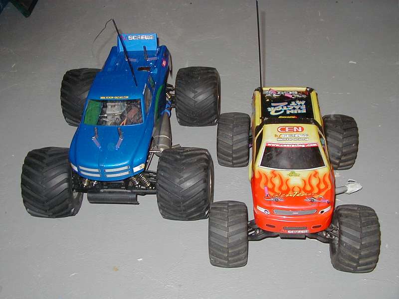

I finally figured out a way to make the rear brake seat and gears solid without spending a fortune or having to machine anything... I used a two traxxas rustler steering arms and traxxas revo ball ends.... what I did was cut each arm down to length and spin the ball ends onto each... connect one side to the throttle servo mount and the other end to the brake seat plate... use the adjustment nut to set the tension... I haven't torture tested it yet, but I will this weekend... I tried to wiggle back and forth and it is rock solid.... Will post pics after I'm sure it works.... Total cost..............$4.00 dollars... total time.... 30 minutes...... Best of all... looks stock!!!!!!!
can substitute threaded rod for tie rods but I liked the look and the adjusting nut.....

beat the piss out of the truck thursday and early this morning... specifically landing jumps tail first today to see what would happen.... the spur gears were fine... no unusual wear at all... didn't have to bend the chassis back into place either... very happy with outcome.. can't wait for the r/c track to dry to give it a good thrashing.... It snowed 6 inches wed night and everything is soft... going to run again Easter sunday at the in-laws house.. will set up a few good jumps.... I'm confident it will stay together... As soon as I find my download cable for my dig camera I will post pics of the mods.......

well , here is the mod that I promised as well as a picture of the mt2 and another of my trucks.. A usa-1 nitro crusher... also, a funny picture of a nitro snowball
