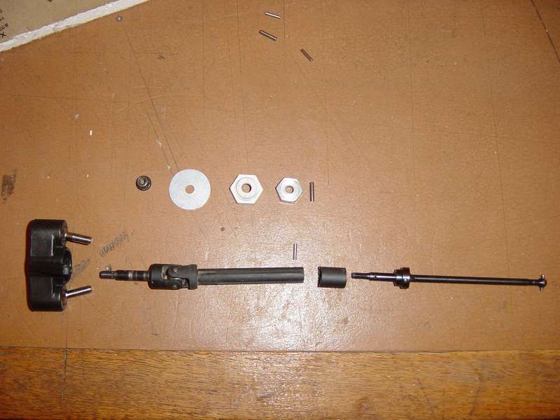

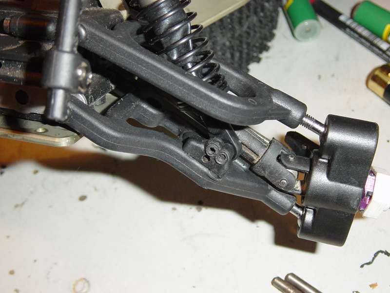

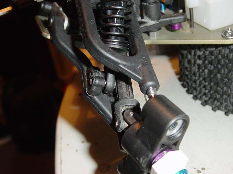

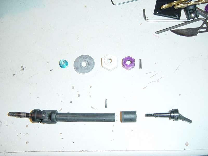

wahey - i just found a cam lead!
i havent done the rear tmaxx/cen shafts yet, but i have some pics of the fronts as i built them up, not a step by step guide, but here is what i have on the cam. its a bit of work, but it seems to work ok so far...
ID:	259870   Click image for larger version
ID:	259871   Click image for larger version
ID:	259872   Click image for larger version

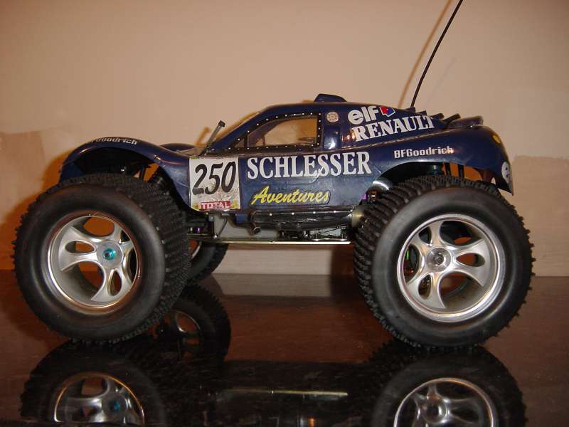

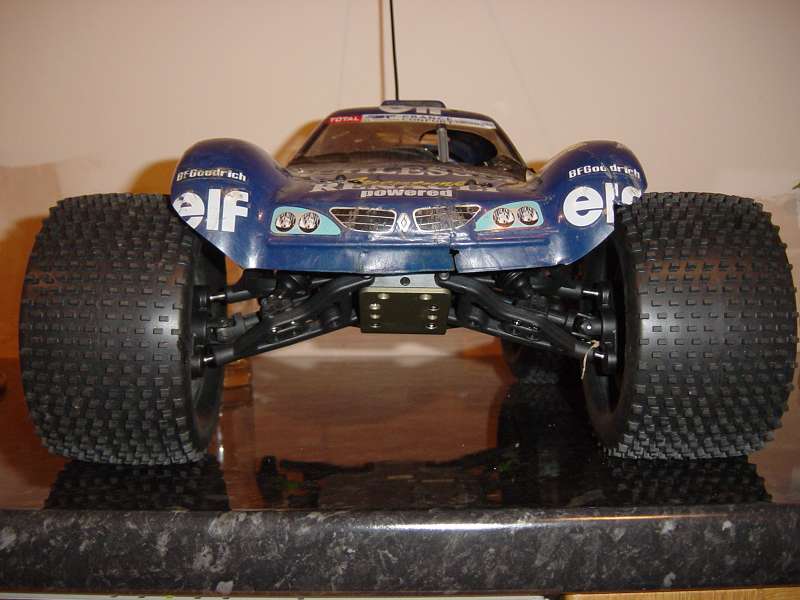

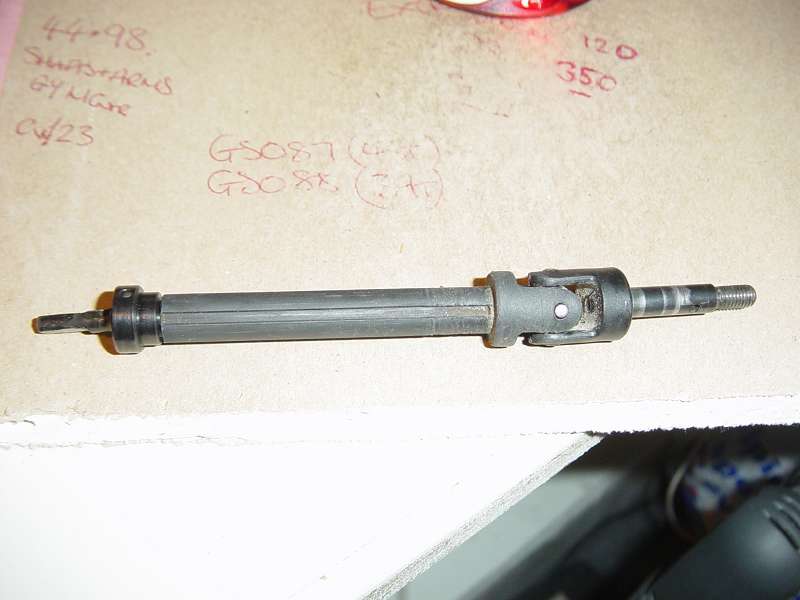

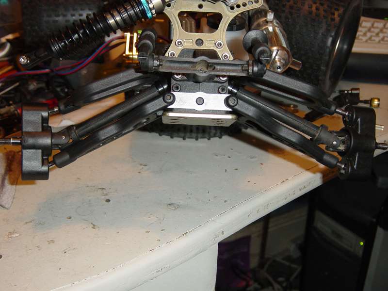

more...
u may be able to figure out exactly what ive done from those, if not, no worries, i will post the step by step of the rears as i do them. u can see what i did with the shock mount tho, to give clearance for the shaft when steering, and the finished look may give u guys a bit more inspiration to do the mod! i love the look of it meself...
ID:	259874   Click image for larger version
ID:	259875   Click image for larger version
ID:	259876   Click image for larger version

Poor Judgement... I think your my hero.... This is exactly what I'm looking to do... I hope the inner cvd between the diff and the maxx axle shaft is strong enough... Please let me know asap... my truck is down and I would use this to fix it instead of throwing money into stock...

Default RE: oops... I broke it again....
well the fronts held up for 2 tanks while i retuned the motor, but the cen shafts gave up as soon as i nailed the throttle once tuned a bit better. my only real concern is that the inner cvs are not joined by a pin thru the diff like the cen diff cups... i will run it as much as possible as i just moved house right next to a park. i am quite busy with the house n all that, but i will do my best to keep u informed over the next few weeks mate.
the shafts have absolutely no slop at all, the wheels are so well located compared to the cen setup, it really puts the cen shafts to shame.
now why the hell didnt someone at cen do something like this? we have been crying out for it for long enough...
i have never had the actual cv fail on me, altho the pins in them sometimes work loose... the pin thru the shaft to hold them on looks fine, as does the plastic shaft around where the pin sits - only 2 tanks on it so far tho, but i am pretty confident.
if u had driven it the other day, u would be converted!! the thing goes anywhere i choose with those wheels and shocks.
