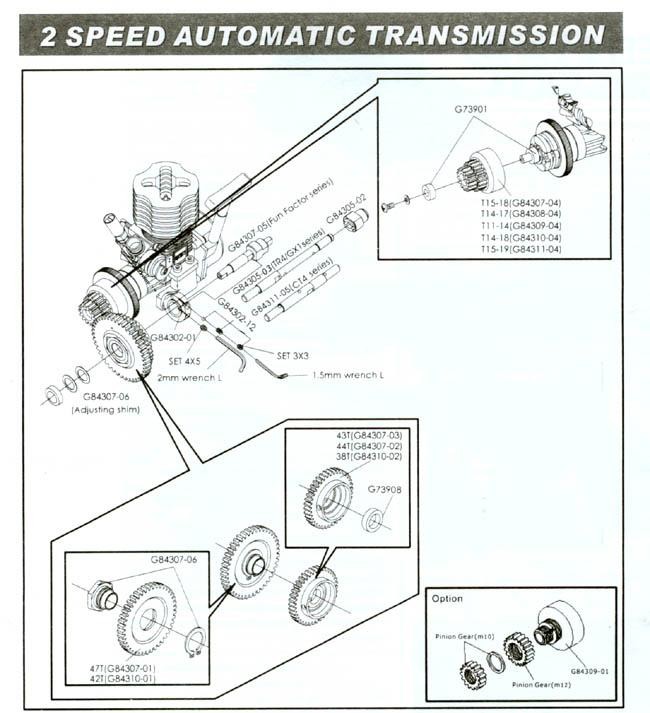

I can't get my MT to shift into second. I have taken the spurs out a couple of times and checked everything out. It all seems fine. I have the adjustment screw turned out about 4 turns. I started at 1 turn and worked my way out a 1/4 turn at the time. I didn't go any farther b/c it started to feel loose and I didn't want it to fall out. It hasn't shifted since I have owned it for about 3 months now. I switched from the MT tires to some Proline Dirt Hawg AT tires that are a lot shorter. You would think with the lower gear ratio from the tires it would shift early but still nothing. I am kind of wondering if it is in second gear to start with. If I remove the engine are the gears supposed to turn together or seperately?

they move together but will engage at different times... check to make sure you are turning the correct set screw for 2nd gear... it is the angled one not the straight one.. start in and work out... not the other way around... I don't think the tires are the problem.. I believe its the 2nd gear setting or the engine isn't tuned for speed... When you said you felt the screw was loose and was starting tome out, I think you may be working with the wrong screws... let me know...

There are 2 screws the 2mm wrench size that is the set screw and the 1.5mm wrench size adjustment screw.
Another thing to check is to make sure that it is installed the right way.
Here is a scan of the assembly sheet. You might need to save the pic and use another program to enlarge it to see the detail.

How long have you had the truck... another possibility is the little arm on the shifter isn't engaging the gear.. Mine is doing that right now, but since I don't need the speed, its not a problem.. the reason for my problem is the lip on 2nd gear is worn smooth so the arm misses it.. I have many more gears, just not in the mood to change it right now...
You said something interesting.. It will shift when you hold it up... leads me to believe that your problem is tuning related or maybe...... running on grass... even with my engine running great.. it would rarely shift in the grass... even short grass and you are only running a short 100 feet...

I don't tune an engine for temp as you are doing because you may not be reaching the full potential of the motor... Tune for smoke and sound... you want a little smoke trail and alot of rpm's.... I use my venom temp meter to check and see where I am... thats all.. If you are getting the full revs from the motor, then your problem lies in the shift mechanism itself.. make sure you turn the screw out from down... also, you may have to take apart and make sure the gear for 2nd isn't worn out on the inside... lastly, make sure the shifter arm isn't installed backwards... its very easy to do..

There is also the possibility that the set screw has backed of enough to cause the shift unit to slip on the shaft.

Well, I pulled the 2spd apart. Here is the problem. The bearing on the 2nd spur is worn causing the spur to wobble a bit. This caused the arm to slip around on the inside of the spur and not shift. Guess that was the ratcheting sound I was hearing when I topped out first gear. Thanks for all the replies guys.
