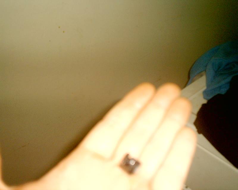

i own a cen genesis and lately its been over heaten but it is to the setings that r in my booklet that came with the truck i finally got mad and started to locate the problem it waz air leaking around the carb. the carb body broke loose and waz moven and allowing twice as much air in the motor causen it to over heat i went to pop the carb out and found that the turn-n-lock pin waz jamed in the hole cause a big problem maken the sleeve that the carb body slides into to get damned when removen it do u just sell the sleeve for the carb and or do i need to buy the hole new carb body to get just that lil part thanks hope this is understandable

its not bad enough for that to be replaced motor as whicked compression still just u could tell when the motor waz gettin hot. i dont no for sure about were u live but if the motor gets to a certain temp down here u can watch the power drop and as soon and i heard it stop reving up i shut it down right away and checked the temp at 270 pretty hot for that big motor but i found and tried to correct the problem and i dont know if i said it or not in the first post but the pin waz jamed it had to be forced out it had gotten jamed in its hole sum how and wouldnt move causen worse problems in the removen of it which when i say that i mean it bent it in and the metal is to soft to rebend it back in place

how long is the warrenty ?? 90 days right?? its not the carb body it is the lil barrel the carb slides into its two piece carb , the carb body and the carb barrel then the locken pin i need the barrel other wise the rest is in great shape sum how

Any way you can post a pic. I am not that familiar with the Genesis part in question.

that is the peace i need the carb slides in to it and when u turn ur lock pin that holds the carb tight so no extra air can get around the bottom of the carb and the peace is missen a chunk and i ? the lhs and they said the only way waz to do what i did pry that out then pop the pin and bore the hole enough to let the pin slip but not to make it were it would be to loose i got all that done but with out that barrel im sol
