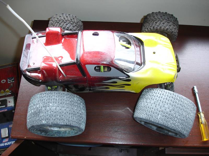

PJ,
You inspired me to weigh my standard MT2 wheels (with only a little mud) and my Savage wheels (wider offset than standard with dirt bonz tyres) and you will all be pleased to know that the Savage setup came in 200grams (nearly 1/2lb) lighter overall (4 wheels and tyres) so thats 50 grams an axle! Sweet!!
Tho the axles will probably still be under the same if not more strain because of the offset needed.
Some pics...

I like the look of those Dirt Bonz on the MT2 and they will definitely grip better. My MT2 slides all over the place with the stock tires.

haha azzman your mt looks mean with them wheels [sm=bananahead.gif]

azzman - looking nice mate, suppose im gonna have to get a fancy paint job now... ffs...
re the wheel weights - really? wow, thats a bit of a surprise to say the least, those cen wheels n tyres, look so small next to the savages ones.

is that a RC10GT shell?
