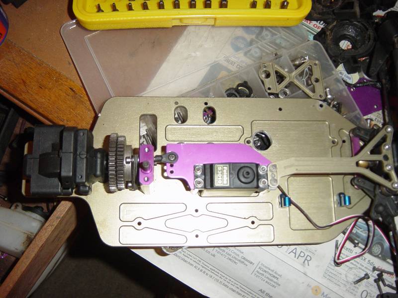

it was just a thought i had re the brace, while i was putting my truck back together. its a bit tricky to get a good design for it as the throttle servo linkage can get in the way if ur not careful. a few people have done it different ways, but nearly all involve an accurate bending of a piece of alloy - would the bending cause a problem DrH?
ive been bouncing ideas about and bolting some scrap bits in mine to see what works - heres a pic of it at the mo, not quite what i want, but u get the idea - it needs a brace between the brake seat and the throttle servo mounts. a single piece, complete top plate that runs right to the front diff would be ideal, but is asking a bit much i reckon (unless we do a full chassis redesign...) [X(]
tbh mine isnt the best to work from due to the lack of stock parts - cmon guys, give us ur brace pics please!

On the JT chassis I don't really see the need for a chassis brace. There is some flex in the chassis but not enough to be concerened about.
On the stock chassis there is allot of flex that should be addressed. I believe that the main reason for the flex on the stock chassis is because it is a 2 piece chassis. It would be hard to eliminate it without a complete top deck or some form of roll cage.
The JT chassis is longer than the stock chassis so 2 different parts would have to be made depending on which chassis is used.
Poor Judgment, if you are not using the stock batt/reciever box try bolting a piece of aluminum in its place to limit the flex. The chassis flexes a considerable amount more if there isn't any thing bolted there.
im getting a fair bit of movement when i hit the brake, pushing the seat backwards. if i can stop it moving then that force can be used to apply the brake instead of bending the chassis, save my batts etc. these wheels take some stopping from speed.
i have a new seat to fit, ill see if it makes any difference, the old one had dodgy threads on one side... oh and new diff cases too, it all counts i guess.
i hear u on the other points tho, rolland, im just bouncing ideas about.

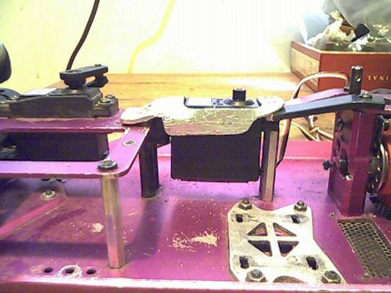

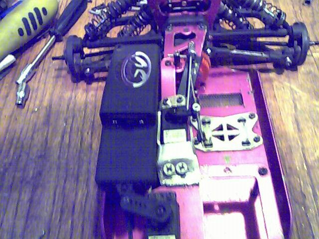

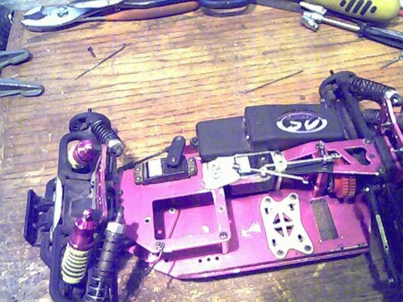

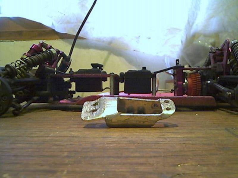

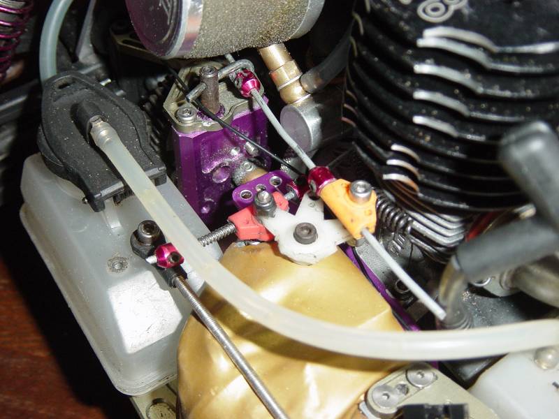

Heres my servo/chassis brace It's alot better than my last attempt THICKER metal this time. I had a old duratrax mt chassis. This brace takes out all chassis flex and protects the servo! If the hole in the middle was cut larger, would be good for servo reverseing.

Modder - thats the kind of support I was meaning - from the brake seat to the radio tray mount is ideal i reckon.

Poor judgement ... I still have my chassis brace set up the same way from when I originally did it and it works very well... No flex at all.... I only have tow steering links cut down with du-bro ball ends at each end... simple and cheap to make and works great... The last time I stripped a spur gear was when the engine got loose, not the chassis...
Modder... Is there any reason your steering servo is upside down? Looks like a severe angle for the linkage to work... Just a thought..

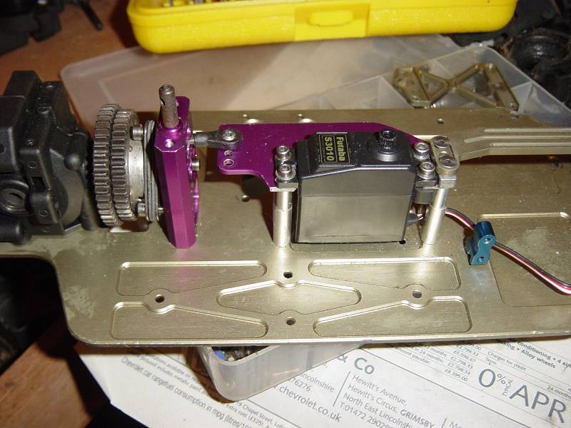

Cenracer - thanks for that. I have drilled and tapped a couple of holes in the front side of the brake seat for a similar kind of thing. My servo is too low to do it ur way, unfortunately.

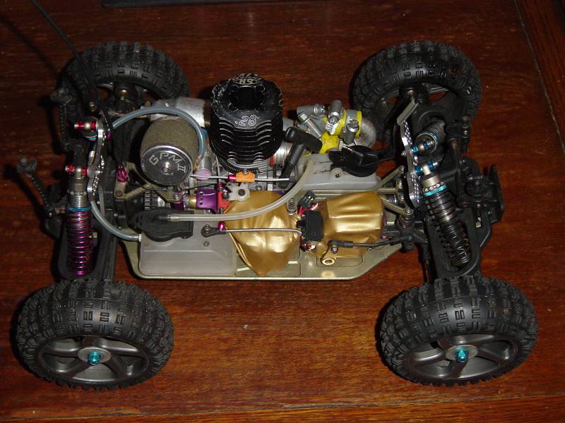

I have been thinking about trying to make a low profile brace the would go from the back shock tower to the screw holes in front of the throttle servo. That would tie the rear shock tower and the top plate together. I have the New Era rollbar on my MT2 so it is good, but I really need something for the ATX. When i hit the brakes you can see the rear shock tower move, that can't be good.

Cenracer - u got a pic of ur brace?
Old 11-15-2005 | 07:31 PM
Joined: Oct 2004
Posts: 2,042
From: hackettstown, NJ
Default RE: New chassis brace from ARO Products?

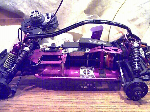

I have it on disc at my house... I'm still at work here.. hardly working tonight... I'll try and get a picture on the computer tonight if I can ... here is a crappy old one with the original engine... its not great, but its a start...

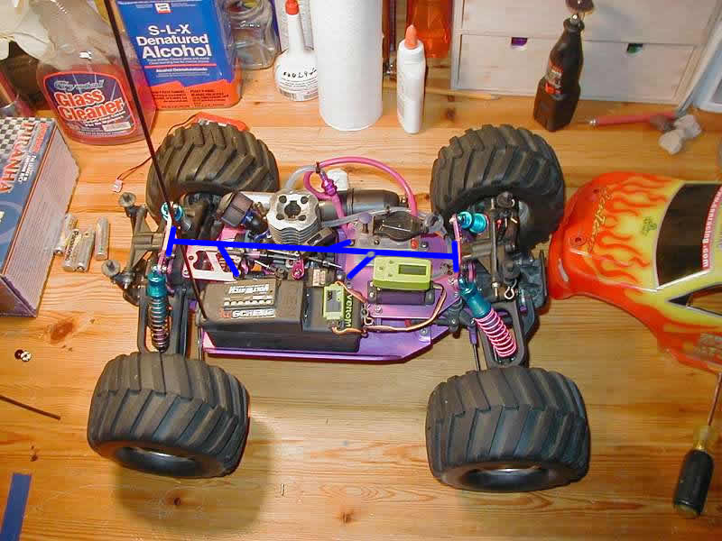

Sorry for using your pic cenracer... to lazy to take my own
I have been thinking of trying out my old ally welding again and making a tube ally brace... could be VERY light and strong and i might be able to make it into a role bar like the new era one but will also brace the shock towers
Heres what im thinking about...

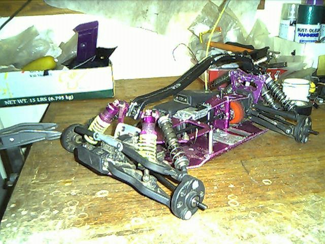

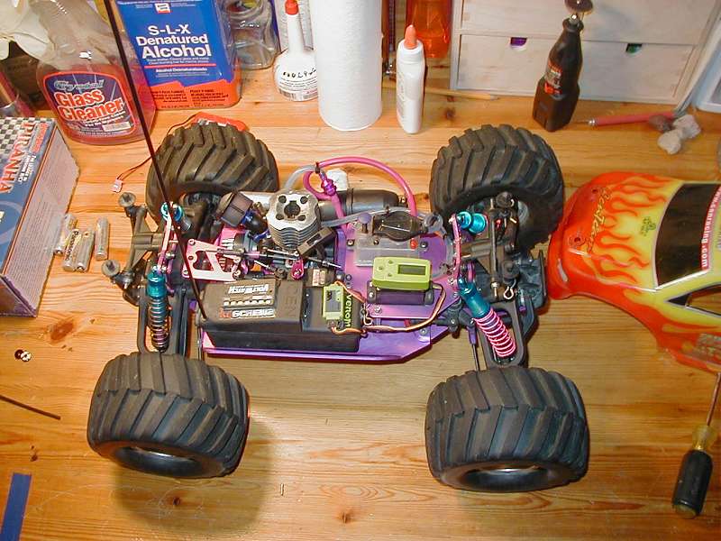

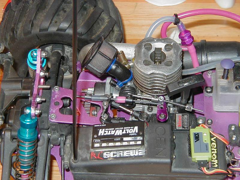

ok - heres whats on my desk at the mo, just about got it all back together - why do some parts have to hide from u...?
I like a clean look
erm... ah, well, mine aint the best to get clean looking ideas from... but here u go - u can just make out the bracing points that im going to use on the seat and servo plate. (just to keep it on topic )
craig - im not keen on bracing between the towers, theres too much leverage on the towers that can bend them quite easily for my liking. with some more supports from the chassis it may be better tho - try it, see what happens man.

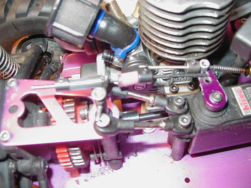

Cenracer 1 I have'nt had any problems with sterring linkage I did it to lower center of gravity without laying servo down cus I like the servo horn to have same travel as sterring horn, hope makes sense. As for braceing I'm finally done after finding one of my hideing parts (cutoff of top plate replaceing that black piece between brake seat and servo looks alot cleaner) Have'nt tryed this rear shock set up yet but it seems to have alot smoother travel then last attempt. How does a 17/20 pinions 41/38 spurs setup sound. I'll let you know how it turns out. I also agree with pj about braceing between towers. Find a way to tie top plates together. My chassis's are as stiff as a board now, I can't flex them at all and thats with pushing it into the corner of the table holding it hand at each end.

neat job on the brace.
not that it was me askin about ur steering... but the servo mounts to mount the steering servo laid down are very cheap on ebay - rc10 or b4 servo mounts are what to look for, iirc.

Poor Judgement,
the towers wont be taking any stress from the chassis
It will be just like the new era one but with bits the support the towers from bending

here is a better pic of what I was talking about... Modder, I was asking about the servo, but I see why you did it... to lower c/g..
PJ.. I am a neat freak when it comes to my r/c stuff.. just like it clean ... can't say the same for the dishes

looks pretty neat that does... good work!
