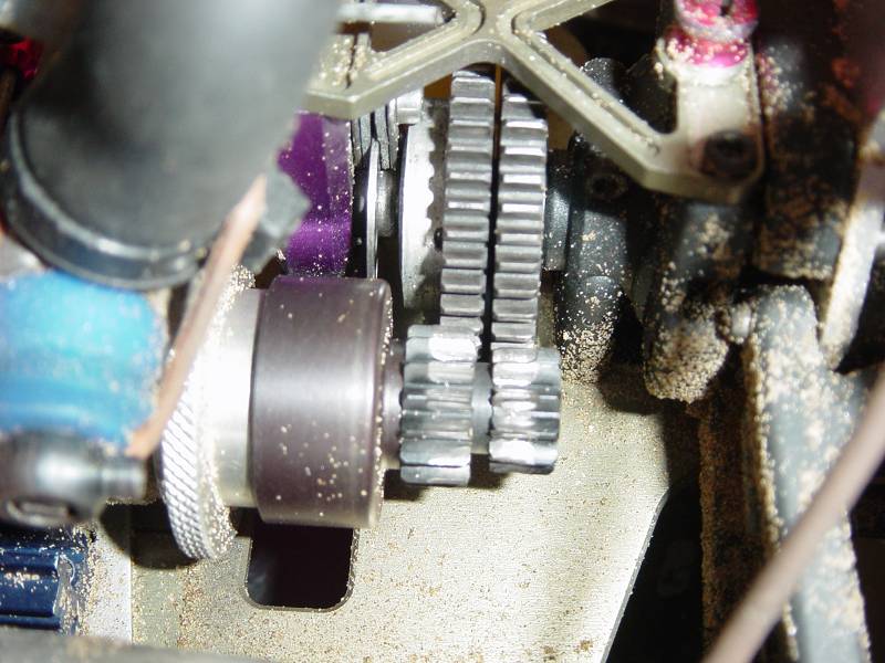

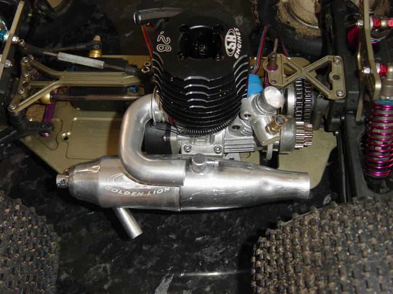

the genesis ones, hardly any signs of wear after nearly 2 gallons now, and most of that is on the beach with hardened ofna pinions and custom mounts (been thru a good few ofna pinion sets tho...)
had to spam some pics - its been too long! 2nd pic has the cen 14/18 clutch bell that i mentioned

the os18 doesnt seem to care too much about the weight of the gears, its more the ratio that u are running - the gen gears are smaller than the stock mt ones, so it will loose some acceleration thru that mostly. also as u will want to use 11/15 pinions, u may well have to shave the brake block to clear the flywheel.
good luck in finding some steel spurs that small that will work with the cen mounts... might be easier to make or mod some mounts so u can use ofnas steel 11/15 bell - just a thought
