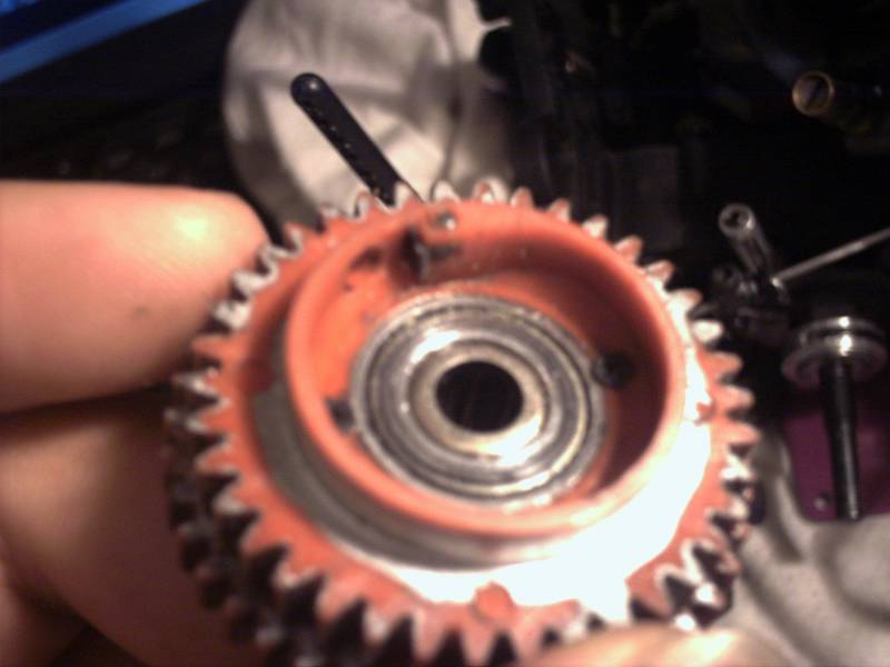

ok here are the pix u requested......now these first 2 pix are of the spur gear......now that lil black stuff u see is some kind of epoxy i bought that my friend recommended but its just temporary to see if that was the problem.
now the other 2 are of the clutch..... do u see the way im openeing the shoe.....is that the way it is suppose to open up?? because if i spin the tires going forward then the clutch spins clockwise like in the pic u can see me lifting up the shoe a lilttle bit.
wut do u think??

SPur has a bit of wear but nothing major. Your clutch is on backwards lol. That "shoe" Should open up so that it snags that piece inside the seond speed spur. Just take that whole alum clutch assembly and put it on the other way. It only takes one grub screw.
Should work me thinks!
Only one way to find out, but from the pics i'm sure thats it.

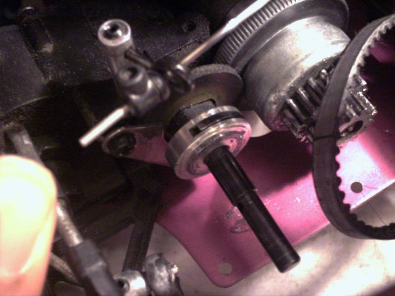

I realized from looking at your pics tah you have a ct4s or ct5. My subaru is a Funfactor rally. The gears are the same though, just going in different directions.
heres a pic of the back end of my car with the clutch showing which way it opens (proped open with a hex key lol)
Keep in mind that my spurs will be turning Counter clockwise.

Another thing that you may have overlooked is can the arm move out. i had it on mine that the arm siezed and wouldnt move out. Took me ages to realise what i should have first checked.
Just to confirm the way that it is on your picture is the wrong way round. The long section of the arm (measured from the pin) should face the flat on the spur so when the arm is forced out it the spur grips the arm. Having it on the wrong way is probably what has caused the damage to the spur.

hummm.... I have just been looking at your pics and it looks like the clutch was the right way round in your pictures.
ALSO the wear on the step on the spur shows that the clutch has opened and making the car go into second gear. and another thing that shows it was the right way round is when it is put in the wrong way as the shoe comes out it will rub the inside of spur making a big black line inside that lip... or removing it all together. (and i would think you might hear a very fast clicking sound as the shoe bounces on the pin)
So if you have flipped that clutch over put it back.
so to me it sounds like the second gear is coming in to early... which i have done before!
It wont sound like its going into second because the lower RPM the engine is turning... so try turning the screw in little at a time.
Just make sure the engine is upto running temps and running good before messing.
