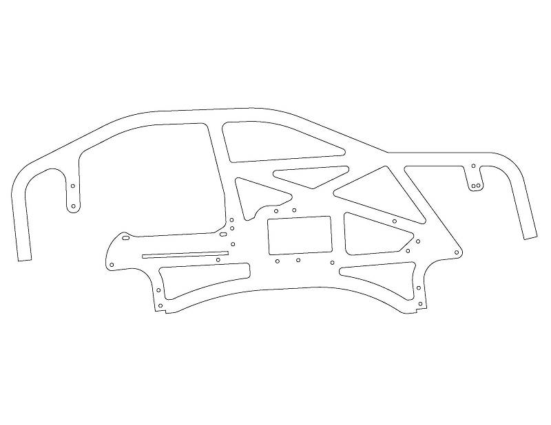

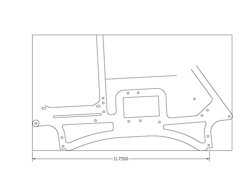

Something the waterjet is going to love!!! When I finish it....Want one????

Ok, know what it is yet??
A hint,, A much needed improvement to Nemesis bashing!!!
Any Q's or suggestions before the wet stuff gets to it??

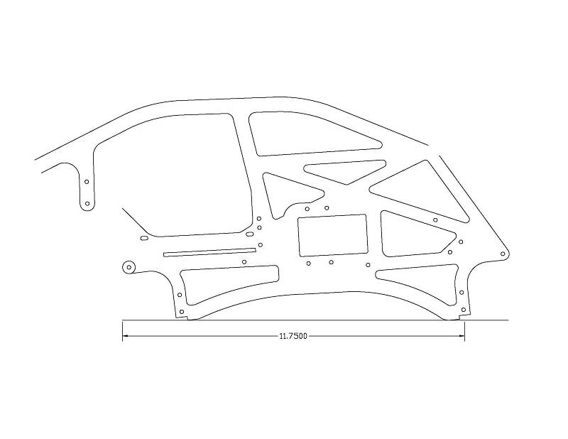

oooh, is it a chassis with a kind of roll bar built in???

I am JEALOUS! You have a waterjet? [X(] I gotta see what it looks like installed!
Oh yeah one thing to consider, you are gonna want to cross-brace the two halves near front and rear and the top for integrity, maybe just some aluminum rod. If it takes a shot at either of those places I think it's gonna bend in toward the chassis. It's going to need to be rigid unless maybe you use Ti or 7075-T6. A carbon fiber cross braced ones would be awesome! Strength and light weight.

Actually, I have several different types of CNC machines at my disposal The water jet is new..
The first prototype is going to be cut on a router type Point to Point and on 1/4" Acrylic just to be sure of the fit and size before I cut the all Mighty alloy. Then if it goes well, off to the Nested base water jet to make several on one sheet. I still need more testing and developement Before I comit to several but you will be the first to know about it!!
I am starting the drawings for the Lower Center Of Gravity(LCG) version of the OEM Dual Verticle Plates(DVP) Just to see How well is handles and jumps..
At the very least, I get one bashing Chassis And 1 Racing Chassis

I might Even be able get past the cooling problem with some very well placed shapes Maybe.. Looking to get some ideas on that and any other problem that can be thought of
So suggestions are very welcome... As my posts will be step by step, so you guys can see the developements and make suggestions.
I think I can get as much as 25mm Lower Center Of Gravity..

Jason, The Dual Verticle Plates(DVP's) will be 1 piece however with the rigorous testing and developement planned there will be some very strong X-bracing(Carbon Fiber, Delrin, Titanium, whatever works best) so breakage will be impossible for the DVP's. But some bending "might" be possible but I doubt it. Well Will See.......
