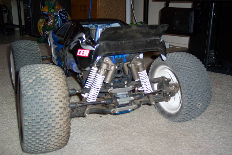

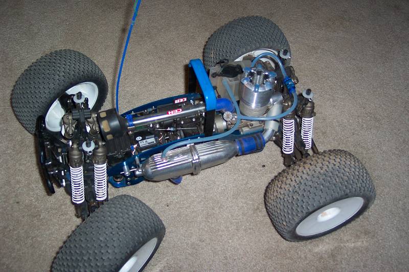

Archer,
That is exactly what I did(6v Battery Pack and moved linkage out to next hole on Arm)Until my Hitec HS5955MG Arrives. The first run the OEM servo stripped the gears. Replaced with Reverse servo since I dont use reverse. But that mod works pretty well to improve steering until a better set-up arrives
