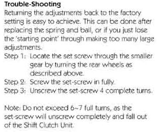

I know I had one of these posts up a couple of months ago. BUt I have just received my new clutch spring and bearing as recommeded by CraigB..
This is all fitted, but cannot find what the standard setup if for the clutch.
Anyone know?

Stolen from cen!
(hope this is what you need)

spot on.
its worth adding a tiny bit of threadlock to the adjustment screw - and i mean just a tiny bit
