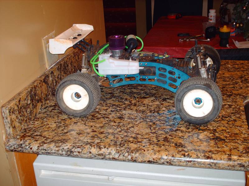

Ok fellas, I've got it solved!!!! A check valve is the answer!! I tried several. I was about to give up when I ran across this filter primer setup for an Ofna!! I was skeptical but had to try. I mounted the filter and took it out for a tuning session. With alitttle leaning on the high speed side and less leaning on the low side, this thing no longer flames out at half tank. And it idles forever without heating up. Woot Woot!!!

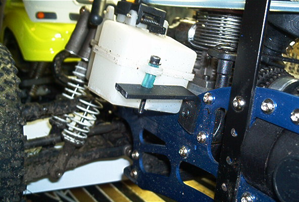

There are two issues I noticed with the nemesis and genesis tank. The first is the half tank lean issue and the second one is that the tank sucks in air because the o-ring on the tank lid does'nt seal very well. I solved both issues buy switching to a smaller tank. I used a xtm x-factor tank. The runs times are not as long,but the trucks runs consistantly now

I believe its 125cc. I used it because I had a couple of extras. I also put one on my tnx 3.0, the tanks on those are notorious for sucking in air

I haven't tried this but one of my friends owns a nemesis and he removed the baffle out of the pipe to cure the half tank lean issue, I guess the baffle restricts the pressure.

I noticed that after a couple gallons, the reddish o-ring on the tank cap no longer seated correctly and the tank would actually leak fuel. Also, when I jumped, the truck would occasionally stall on landing, probably because the tank cap would pop open briefly. There were traces of the o-ring on the matching part of the tank and I think the o-ring was swelling and dissolving. While at the Toyota dealership, I was looking through their cheap tool bin and found a blister pack of all sizes of o-rings. Sure enough, one fit perfectly in place of the stock one and the cap closes tight and leak-proof every time now. I was worried the new one would dissolve or tear, but haven't seen any evidence of that a couple gallons later. I'm sure you could get the same blister pack at a tool store such as Harbor Freight or maybe even Lowes.

Are you placing check valve on muffler line and which direction for flow. I would assume that you are using to block fuel from going back in the tank so flow direct would be twords muffler inlet. could you please clarify. would greatly apreciate it.
#73
Flow direction is to the tank to allow exhaust gas into the tank to pressurize the tank and when you let off the throttle, the valve closes to hold the pressure in the tank so there is more consistant pressure in the tank..
Clear?
