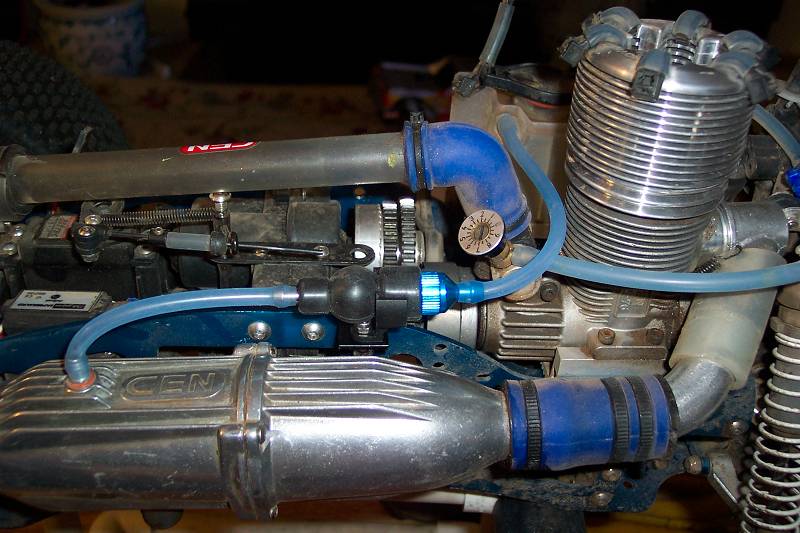

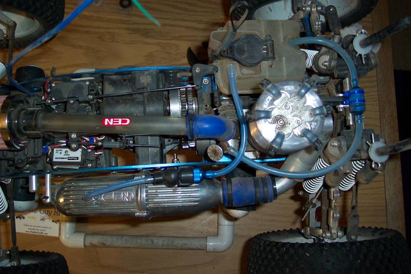

Ok fellas, I've got it solved!!!! A check valve is the answer!! I tried several. I was about to give up when I ran across this filter primer setup for an Ofna!! I was skeptical but had to try. I mounted the filter and took it out for a tuning session. With alitttle leaning on the high speed side and less leaning on the low side, this thing no longer flames out at half tank. And it idles forever without heating up. Woot Woot!!!
Oh yeah cant forget the addition runtime...gotta get numbers for ya...

Sweet... dogman you rule!
ordering one right now. this tank thing has been my only issue with the gen.
btw, cool intake. notice any difference over stock?
or are you setting it up as a snorkle?

Thanks Dustin, the intake tube helps with the dust and dirt I get out here in the desert. When Running the stock air filter I was cleaning it after every run but as soon as I put in the snorkle/cold air tube and moved the filter forward, I can go several runs without worring about it..so long in fact sometimes I forget to clean it!!!!lol
