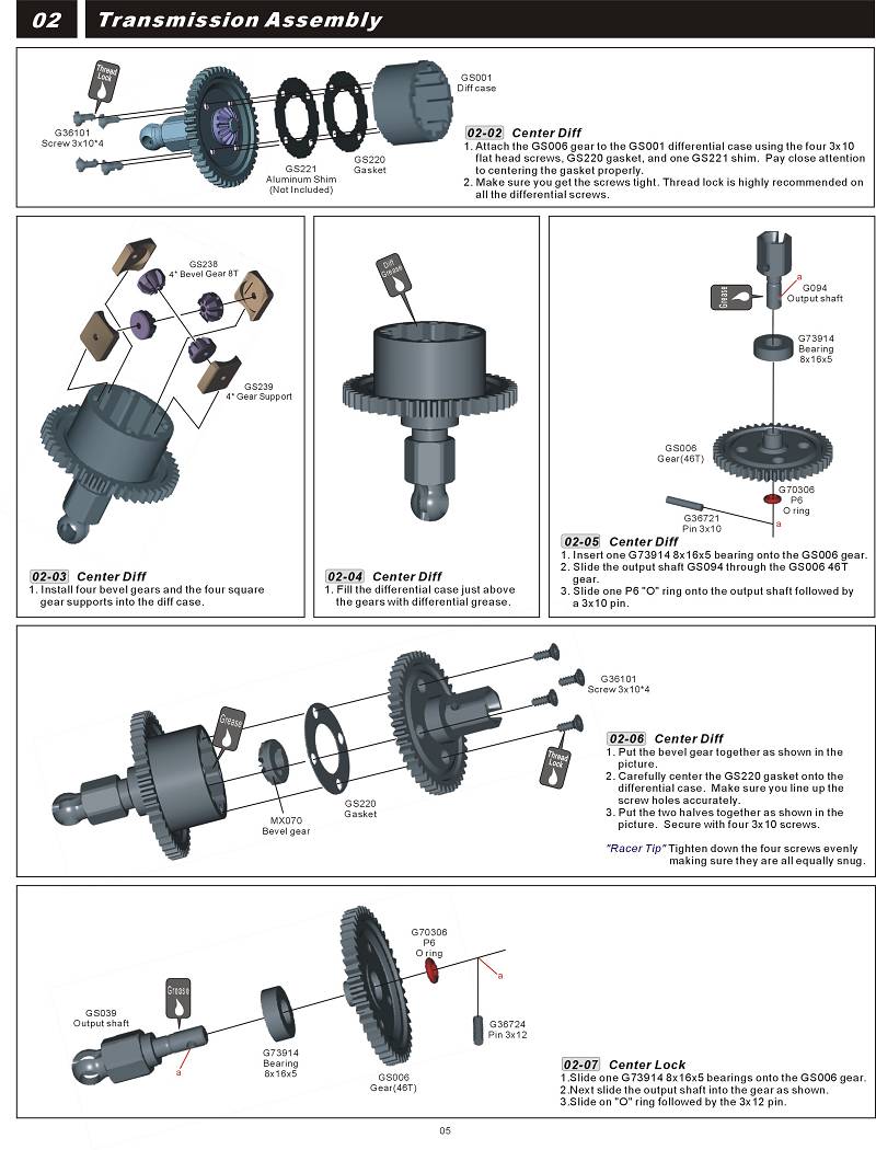

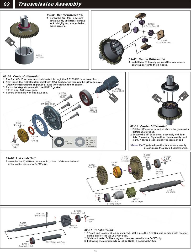

I am not positive, but I do believe the output shafts for the genesis GS039 are a much smaller than the GS208 output shafts. The inner diameter of the bearing is a 12mm for the Nemesis Differentials (page 05 of the Nemesis manual), whereas the Genesis/GST ones are the 8mm inner diameter bearing(also on page 05 of the GST manual).
To do the conversion I think you will need the GS060 Diff case cover for the smaller ID bearing, and then GS006 the spur gear for the smaller bearing. You might want to check the manual as I could be wrong.

Hey Blackrain, Love your work great direction to go... However, s5lin is right.. unless you have changed the center diff that out put is not going to just "bolt-on". The Center diff on the nemesis tranny is bigger and beefier. You will need to change the tranny or just the diff if you can get the spacers required to fit the genesis or gst diff in the nemesis tranny case..

i looked at the gst exploded view again it showed a 8-16-5 bearing on both sides of diff and my nemesis manual shows the same thing

Well Blackrain, My nemesis Manual shows Part#G73921 to be a Bearing 12 x 21 x 5, and my GST manual I got from the 'Bay shows the Part#G73914 to be a Bearing 8 x 16 x 5 The first image is the GST manual page 5 and the second is the Nemesis manual page 5. As you can see all of the parts except the bevel gears(the most expensive to manufacture) are different. Just see for yourself...

hay i realized what you guys were saying was right luckily i was able to stop my shipment and order some aluminum shocks instead. doing a plastic driveline would be more realistic and less costly if i had a Gst or Genesis instead just to many things to change out. im just going to do aluminum shocks with no piggy backs carbon fiber chassie, and plastic diff cups and weigh it again and see were i stand before i try anything else
