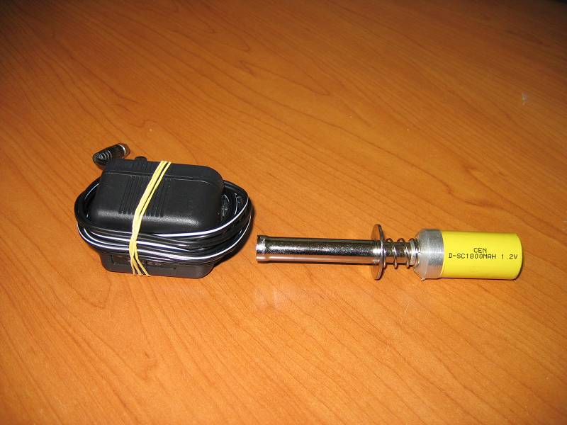

OK, hands up, I'm completely new to the RC scene. My new GST arrived intact and huge on Friday 13th...hmmmm. Had done some research so I thought I was ready to get things ( the truck! ) moving on my own. Seems as though I've things to learn. Two main issues here folks. 1. How the heck do you get the transmitter - the lovely and I'm sure very excellent Skyion DSK - to communicate with the GST. I have to say I don't find the manual good for beginners at all. All CEN provide are a few books and charts showing how the truck fits together...fine if I want to repair it. It also includes a small booklet on the basic transmitter settings, but for someone with no experience it's not enough. For example on page 7 it states that the transmitter crystal must be paired with the receiver crystal. Now with a bit of work I might be able to work out the transmitter bit but sorry I looked all over the receiver pack and can't see where you would match the radio....in fact what are crystals??? 2. CEN supplied a few basic tools and they included what I presume is a glow plug....yellow base and metal shaft and a charger...please what is the charger for. I can’t see anything that it might fit into. Does the glow plug have to be charged or do I need to get an additional item which I haven't been supplied with. I realise I'm ridiculously basic in my queries but until I get some help the lovely (and it's lovely isn't it) truck will remain a feature on the kitchen floor. Good people guide me to GST glory!!! Thanks.

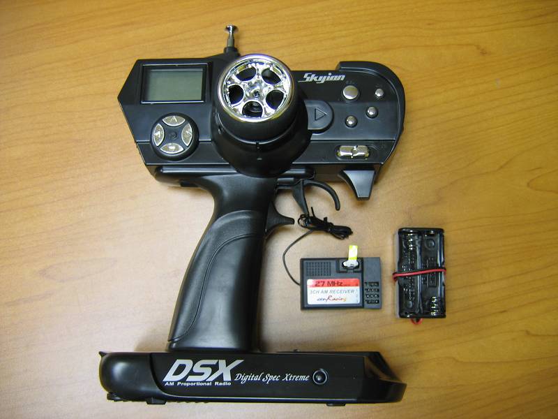

The crystsal will not be next to the battery, it will be in the reciever box sticking out of the reciver. The crystal is a part that carries the frequency. If you look at the crystal ,there will be a number on it just like the one in the radio. You should'nt need to do anything since the transmitter and reciver will both have the same crystals( same frequency). IF you look at the box with the antena coming out, that is where you will find the reciver crystal.

ok, the glow starter. I am assuming that you are talking about the things in the pictures below V
the steel shaft has a wide lip and a spring on it, pull the lip towards the yellow part and then press the end of the charger into the end of the shaft (as pictured) V
This is your glow starter, it is needed to warm up the glow plug to start the truck. It needs to charge for about 8 hours before you use it.
Did your truck come with a CEN Nitro handbook? If so, please read it thoroughly. Also check out http://www.cenracing.com/faq.html#cc

Radio crystals are these http://www.rc-airplane-world.com/ima...s/crystals.jpg
By "matching them" that just means that they both need to be the same frequency (same numbers on the tags) Which they SHOULD be, but it doesnt hurt to double check. Also make sure they are pressed in tight on the reciever and transmitter.
Just to clarify: look at the third pic below. V from left to right, There is the transmitter (pistol shape), reciever ( with the antenna), and reciever battery pack (usually referred to as reciever pack)
To make the radio system work, all you should have to do is install 4 AA batteries in the 4 cell battery holder, then, on the bottom of the truck there is a battery compartment. I am not sure if the wires will be routed correctly on the truck or not, but there should be a female wire end sticking into that compartment for you to plug the battery pack into.
Once you plug the batteries in, turn on the transmitter (batteries installed) and turn on the switch on the bottom of the truck, you should be able to move the throttle servo and steering servo be squeezing the trigger, or turning the wheel on the transmitter. (note: the wheels may not turn well with the truck on the ground due to its weight)
