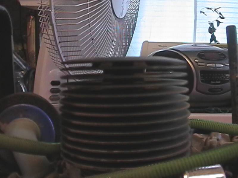

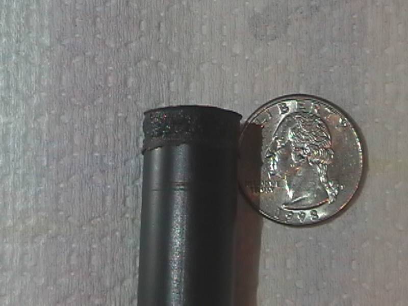

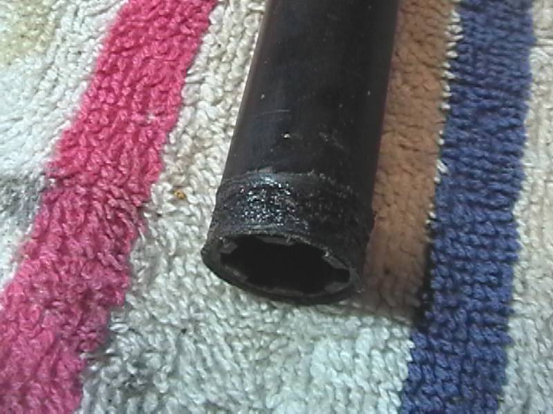

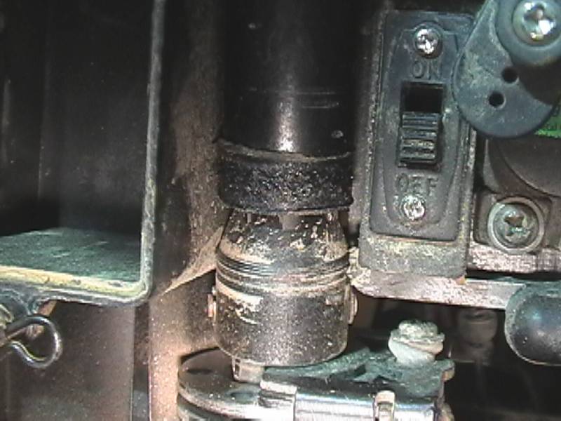

how did this happen...did i get a rock up there...man that sucks...
took my truck to the track for the first time today...only jumped...well...13 or 15 times...3 bad landings. only ran half a tank only because the parking lot is bigger and I could open her up and drift. could a cinder of done that? stupid plastic front shaft. that's my luck. the mud took some of the plastic off the other half...man that's crap

Hey poo, Thanx for the pics, helps emensly. Anyway, first thing is the tolerence between the radio box and Plastic shaft is so tight that shaft will rub on the radio box, I had to "trim" my radio box with the dremel and large drum sander. However, your problem looks like it got some help from an extra piece of debris wedged in there. Thats actually why I changed my Genesis plastic front shaft to the Nemesis steel front shaft. No more critters caught in there, and better clearance.. So trim your radio box and watch for debris getting wedged, or Swap the shaft..
Hope this helps!!

I don't get it...it's all clear...not a mark on it...now i'm really lost here

Well burning, you obviously had a hunk of poo(get it burning,,, poo) wedged in there that it now gone... are very rare occurence. unless you run in alot of mud. the mud prolly help the poo in but let go right after you stopped or went into reverse, the point is, it did the damage and now gone. Your front drive shaft is not ruined, it will function, but....
good clean-up btw

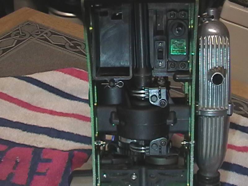

Ok that pin that is at the center diff is what has broke/fallen out on my truck. Now I have not taken anything apart yet but my question is will i have to do more to it than slide the pin in or does that barrel screw need to be replace? Can that have fallen out?

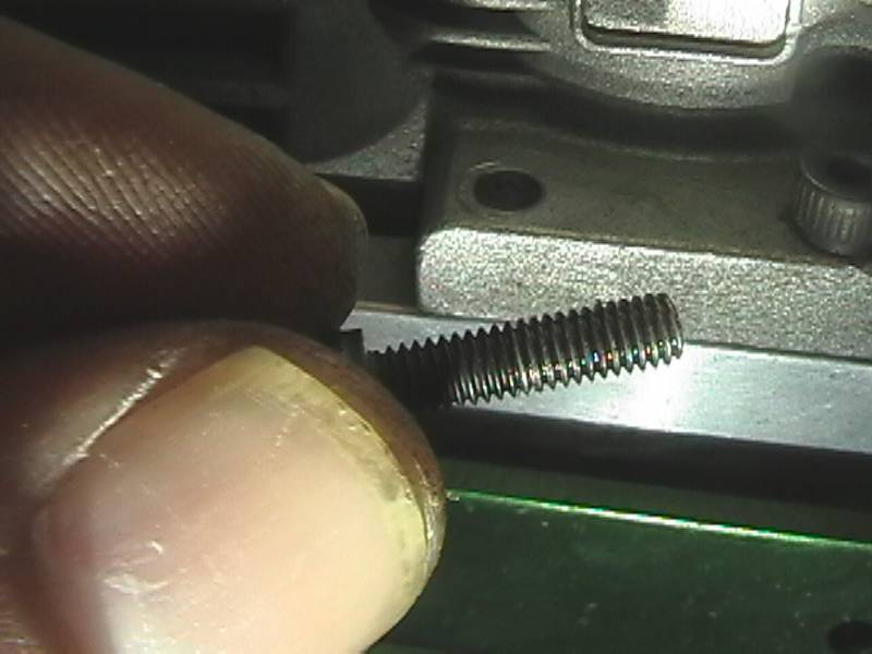

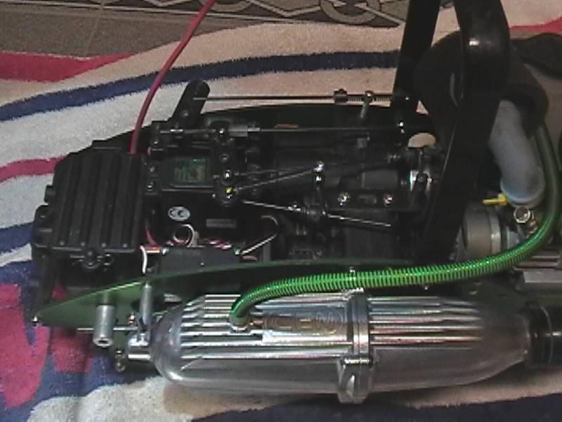

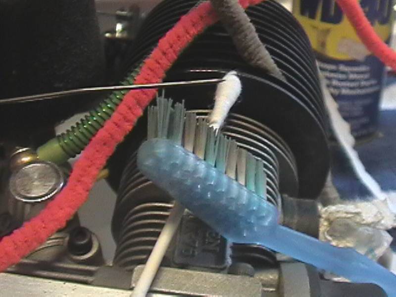

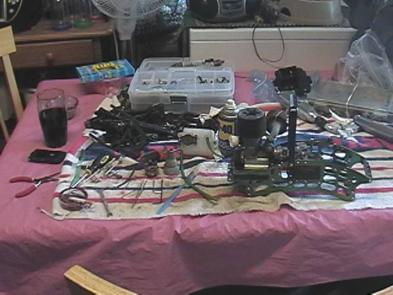

tools of a mad man...I spent 2 hours cleaning the engin...truck don't look the same anymore...
watch out for the tailpipe spring...took a nice chunk of skin when it hooked me from fully stretched...
and there was no tread lock on my engin screws....
and I bent my top fin with some nice air and some bad control

Pipe cleaners - good idea.
An old paint brush is a useful cleaning device.... e.g. can brush the dirty off the top without harming the linkages and possibly get into places the toothbrush won't.

Be sure the brakes are fully engaged, then grab one front wheel and try to rotate the other front wheel. If it spins freely and the drive shaft does not spin then your front diff is hosed, it spins and your drive DOES spin and the brakes are fully engaged then your tranny has issues.
If either the front dif is hosed or your tranny needs work and you find the diff in the tranny broke, then I would suggest getting some gloves and a heat source that will get up to 300 degrees and heat the diff to soften the Locktight that is used on the screws holding the diff side plates on. Make sure you have a good quality hex driver. Be very careful and patient while attempting to crack the diff open it can be a PITA but heat is the trick.
Good luck and let us know how it goes!!

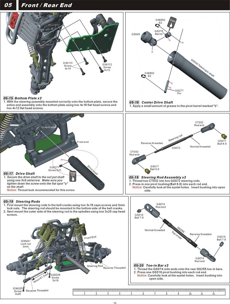

Ok Jarlin one more thing to look at is the grub screw on the side of the input shaft at the front diff. That screw is notorious for not being set on the flat of the pinion shaft and breaking free allowing the diff and pinion to spin inside the front input(identified in your manual on page 15 as GS043). Take that screw out and look thru the hole to see if it is aligned with the flat spot in the pinion shaft(the manual calls it the output shaft, I dont agree) if not than rotate until it does, add a drop of locktight and tighten grubscrew down as tight as you can get it without damaging the hex inside the screw.
Hope that is the problem, easier to fix.

Jarlin I am referring to the center driveshaft as seen below
