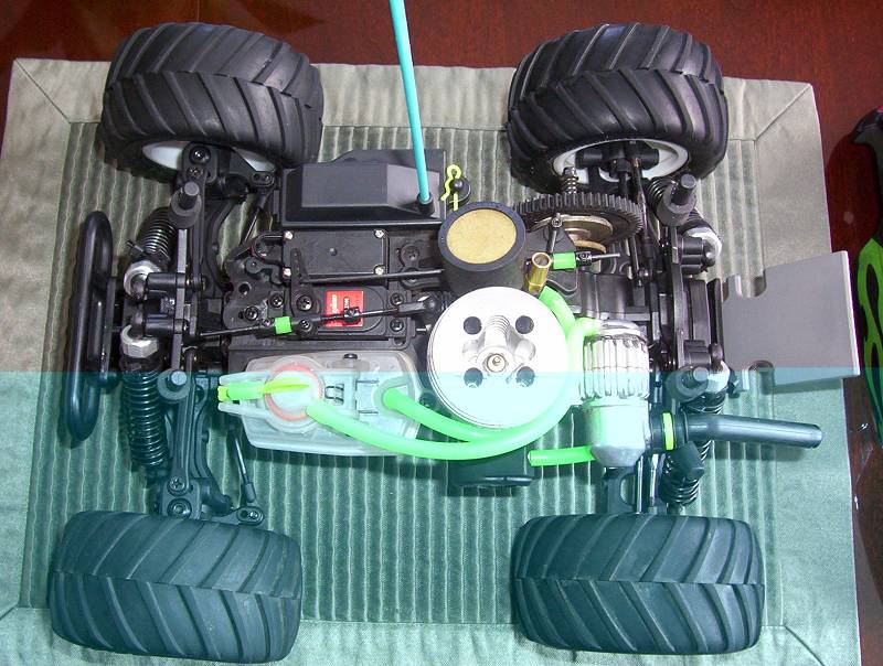

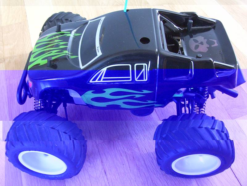

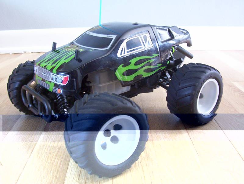

If any body is looking for a new body for these just take the stock one with some 20% fuel and some steel wool and about 20 min. later you have a crystal clear pre cut shell to paint . I did mine all black with green flames and added all green fuel tubing every where even on the pull start and it came out really good. I have had about a half gallon through mine and it runs great beats t maxx and nitro evader. My radio sucked so i have another radio and upgraded the steering servo, put in bearings, 5 aaa batt. mod, traxxas skid plate as a wheelie bar, rear turnbuckles of a nitro evader, flipped exauhst to reach the lsn, painted body now im waiting on new meats. Fun little trucks and mine just screams like my cvr .12 and had a differnt cooling head than anyone elses ?

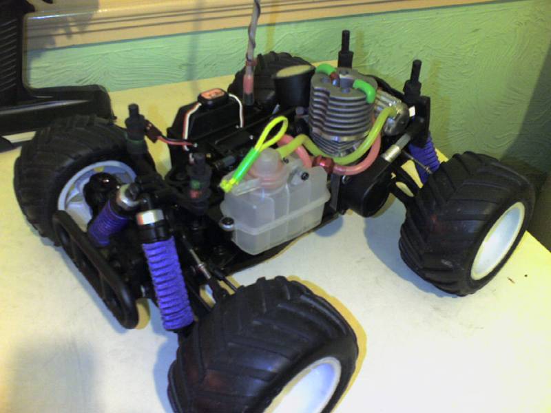

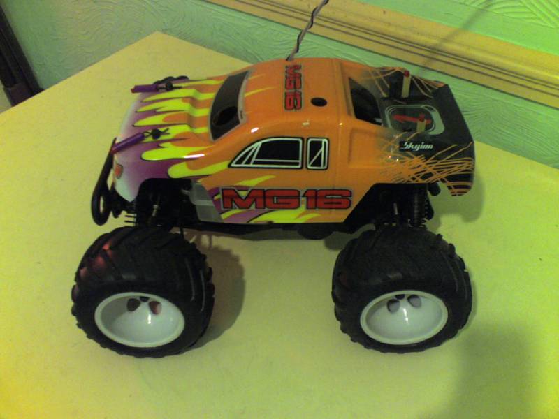

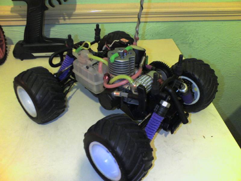

That looks excellent matey,them flames set it off nicely and a great find too.I noticed the white cover paint on the shell inside runs and comes off really easily with fuel but my shells way too far gone to even think of respraying it lol .I'll have a go when I get a new shell,may get 2 and leave one standard and one for show and the old one for bashing.I've quite a few RC models and this little bandit is by far my favourite at the moment.I've done the bearings with Avid ceramic outers and rubber sealed inners,5 cell 1100mah Pack I made,front and rear adjustable top arms and replaced fuel tube and replaced the pullstart handle and fittings with one from a Hyper 7 buggy engine....My wife has one too and its basically the same now except for the pullstart...**EDIT**Whats the Traxass skid plate from that your using as a wheelie bar buddy..? It looks smart...

it is a t-maxx rear skid plate. I have seen a few people use them. Some like it others say it is too soft.
Nice Job 88, that really does help the look! Also for your FYI. Associated makes a plastic wing like what the jato stock body uses that you can bolt on to the stock body. I will see if i can find the part number tonight.
