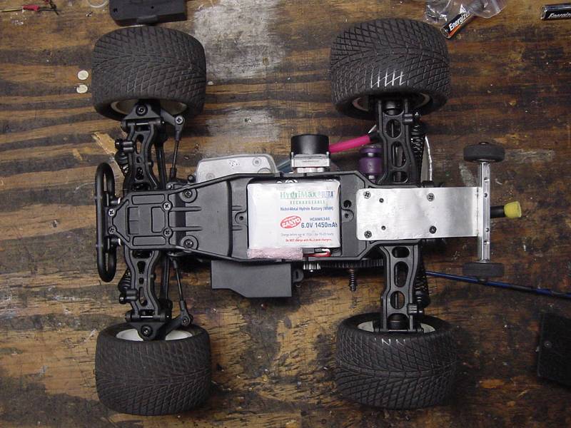

My new MG16 did not seem to perform very well for a .15 engine so I tried changing out the stock exhaust to see if that would help. I found an old exhaust manifold from a CEN Sedan (G70322) that fit in the chassis and added a one piece CD3 pipe. The original can type exhaust system had major oil leaks because there was no sealing in the pipe chamber. I took it to a local test track to see if these changes would help. What I found was the power almost doubled from the same engine. Now the MG16 is fun to drive.
The left rear doesnt hit the pipe?
Ya done good! I was wondering how I could add a tuned pipe to mine, too late now though, Ive got it for sale in the classifieds...
The left rear tire does not contact the exhaust pipe. Luckily the suspension travel limiter stops it first and the tires being used are a little smaller in diameter. The body will fit with this setup with a small amount of trimming. A Tsais nitro devil type exhaust would probably fit up better. Next I am working on finding a 6v 5 cell NiMH battery that will fit in the battery box with minimal trimming. So far the Hobbico6346 looks good.

I am very much looking forward to your pics. I just picked up a MG16 on ebay and it should be here friday.
2 things i want to change are the exhaust and battery.
I was thinking side exhaust but i wanted it to look good too.
I tried searching towers for the pack and it came up blank... got a link?
The Hobbico 1400MAH (HCAM6346) NiMH battery can be bought at ServoCity or Toyhaus .com. The battery works fine so I went ahead and made a cover/retainer for it so that it can remain securely in place. A side exhaust might fit using a very small pipe like the Tower one for the ST15 (#9205). CEN really should let us know what other exhaust set-ups might work in their upcoming up-grades. Also it would be great if a larger .18 engine could fit in this chassis or the MG10TR. Right now I do not see how any other small block engine will fit the MG16 or MG10 chassis due to the CEN .15 having a unusually small diameter flywheel, close transmission/engine brace and an oddly extended SG crankshaft design.

I have been doing some measuring and i think a stock .15 nitro stampede exhaust system will work. I am watching one on ebay to win. Keep you postedon what i find.

Muck76 you were correct that the .15 nitro stampede exhaust would fit up. It looks and fits like original! I will try it out this weekend to see how much it helps. Another thing to try to gain a little more speed is to remove the metal wheel bushings and install wheel bearings. I was wondering way the truggy had trouble coasting. The MG16 will gain more acceleration and top speed changing out the bushings to bearings. My Hobbico 1450 MAH battery and custom flat plastic cover works great!

Thanks for the heads up Digout. Glad to see my idea of the pede pipe fits. Definetly let us know how it performs. I am hoping to see some better bottom end out of it due to a little more flow.
So i have to ask, is that pipe the one that was on ebay? I was watching one till pay day and i see it went before i could jump on it.

I am using the stock MG16 CB for now with a clutch spring from a Magnum 10. An upgrade Magnum CB for a single speed trany will work. The Magnum and MG16 does use the same clutch spring except that all my MG16s springs were bad from the beginning.

The pede pipe did not do much for the engine according to Digout.
My experiences with the TC3 pipe off the back was also too much stuff that would scrape when it wheelied. My current set up of dual stock muffler seemed to work the best for me. The link i Pm'd you has that info in it.
but if you want to try it, all the parts are available threw Tower Hobbies, ebay, and your local LHS. every thing besides ebay is separate parts and you would just have to go threw the list of parts to find it. Other wise hop on traxxas' site and down load the rear end parts page. It should have the part numbers on it.
