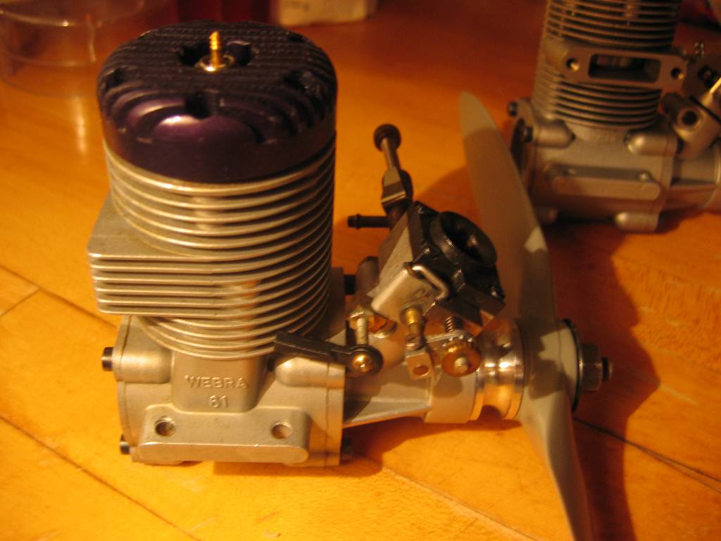

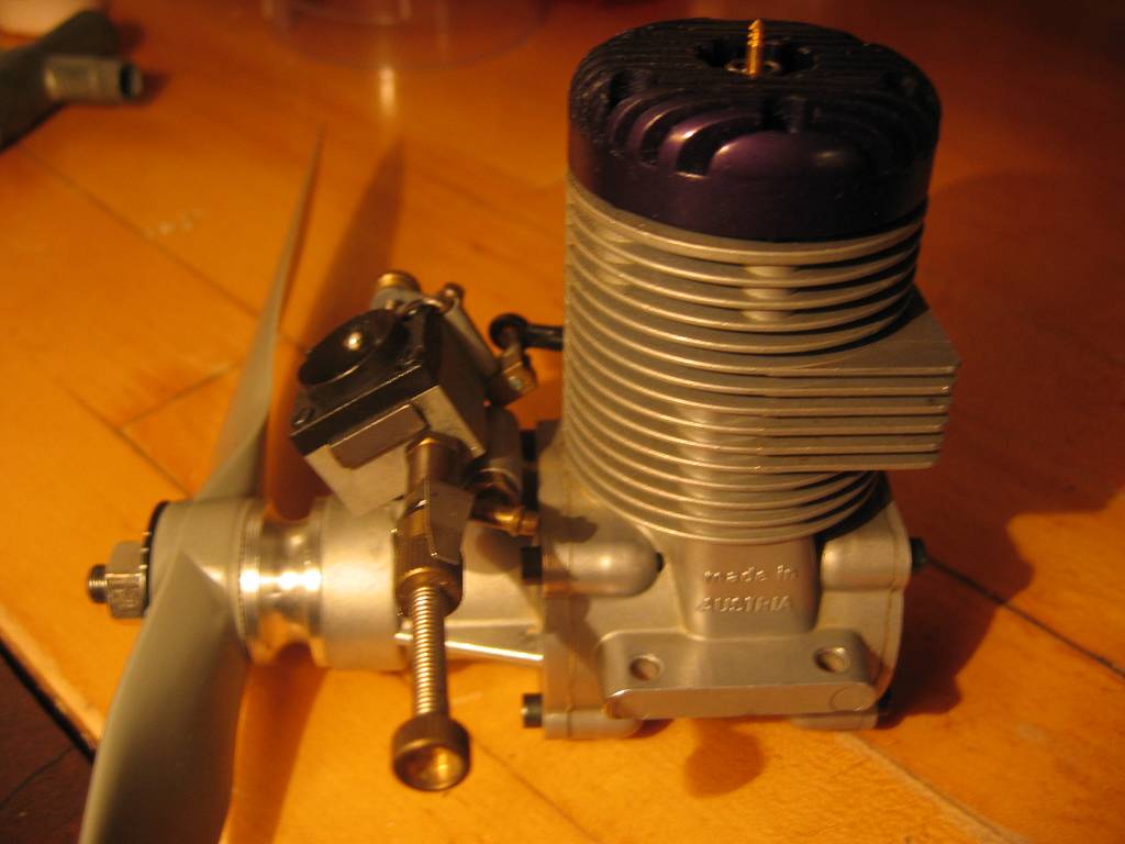

This Xmas I was fortunate to come by two vintage classic engines:
[ul][*] A Webra Speed 61-F ABC "Racing" (RE)[*] A Webra Speed 80-F ABC "Champion" (SE)
[/ul]
I've always wanted a RE European brute and aside from the somewhat tamer ST X61 I'm using on a Calypso on the bench, this is the only RE European engine I have available. The Webra 80-F ABC came along for the ride as it was being sold along side. This latter has massive compression and is essentially a bored out Speed 61 as the crankcase and cylinder is the same size as the 61.
So now, what remains is to decide what to build for them. Any suggestions?
David.

A SBA Speeda for the Speed 80-F ABC!!!!

Excellent suggestion Mike! Might she be a tad... fast!?

I vote for an EU-1 for the Speed 61-F ABC!

Hey David, I know it's not a euopean design, but that Webra speed with the dynamix carb would be perfect for a Bootlegger!

If the Webra 61 is the LS (Long Stroke) it would fit like a glove in a Matt "Saphir 1" if you can find one:

Bo, thanks for reminding me of the good match between the Saphir and the Webra. Mine is not the long stroke version but I see no problem with using the short stroke on the model. Webra specs actually mention that power output between the two versions is identical.
Thanks also for reminding me of that thread. Since August I actually have bought a Model Tech Saphir I ARC. Given the model is readily available for me to build, I may just go with your suggestion. Besides, the Calypso with the ST X61 I'm building and the Saphir with the Webra 61R will make a nice pair.
The only question remaining is how well these un-pumped engines will perform in their inverted installation.
All other excellent suggestions may have to wait. The Speeda for the Speed 80 does sound mighty tempting. Will have to inquire with Don as to the state of his core cutting for the various fuses he has molded.

The Speed 80 shown in the photos above is much more recent in terms of production. It is also a 13x10 turner so I have to select an airframe that can handle that prop and power both in size and in clearance.

Yep, that are the diagrams I was thinking about. Note the longstroke 61 Racing was not intended to rev more than 13.5K.
The Arrow of Wolfgang Matt would be perfect match for this 61R short stroke - a low drag design which deserves to be flown fast. Matt´s Saphir has totally different character and asks for the long stroke powerplant, in my humble opinion.
The 80F was told to have less elaborate mass balancing of the crankshaft, conrod and piston - due to be of massively overbored design. Even the tungsten carbide counterweigths in the crankshaft web were not fully able to cure this. This engine won´t feel weel at higher rpm.
