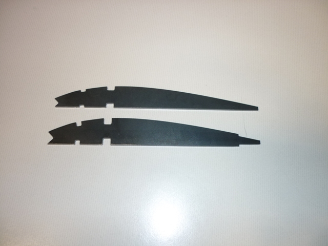

What's wrong with a laser cut profile. 1/2A LST Trainer ribs.
ORIGINAL: Jim_Purcha
Great a composite aluminum template more expensive and stronger to cut a pattern for "balsa wood". Seems like overkill. What about a 16 ga crs laser cut pattern.
Jim
ORIGINAL: dhal22
ORIGINAL: Rendegade
um, what's composite aluminium?
i wondered that myself. here is the 1st link i found. going back for more.
http://www.tgdaily.com/trendwatch-fe...n-carbon-fiber
They look perfectly fine to me...
I guess I don't understand what's behind your question.
Brian

Default RE: Template heaven!
Just showing as an example.
Jim
