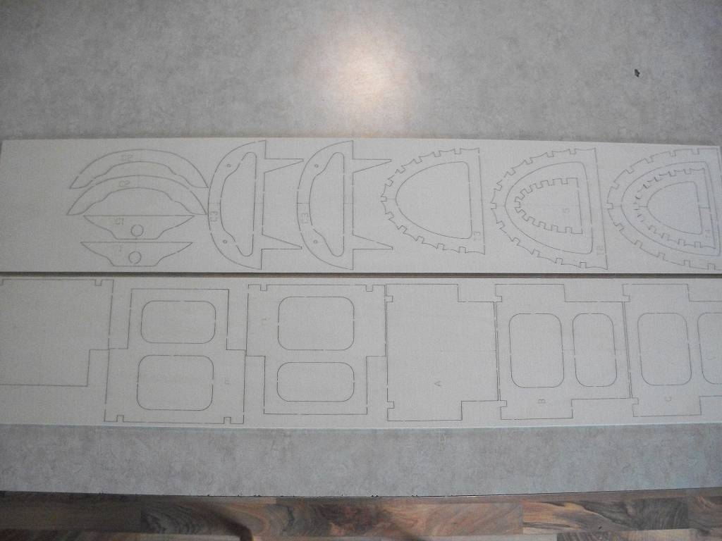

Here is a pic of the laser cut parts. Kinda hard to see, so I will get them out of the sheets today and post another pic.

Laser cut formers.

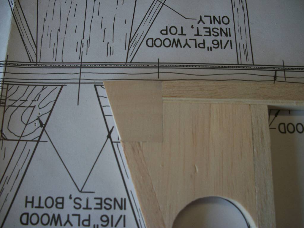

Up next, I cut 12 pieces of 1/16" ply for the elevator control horn plates, (I know the pic shows 10, but I have installed 2). The balsa and a small portion of the 1/8" ply must be removed so the plates are flush with the top and bottom of the elevator.

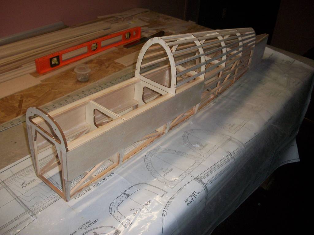

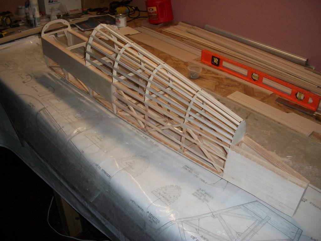

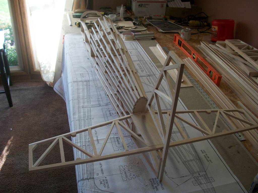

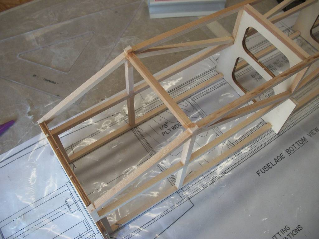

FINALLY!!!! After a bit of a delay, my spruce order arrived on Friday and it was time to get back to building.
First up was the stabilizers. It only took about 1 hour to get the 3 of them built. They are mostly built out of 3/8" square balsa, with one piece of 3/8" square spruce for the trailing edges and a couple of 3/8" spruce for the tail wire braces.
Next is the fuselage. The main "box" structure is built-up out of 1/4" square spruce. The turtledeck formers are 1/8" ply with 1/4" square balsa stringers. 3/16" balsa is then added to the sides of the fuse to give it it's shape.
I am having problems getting pictures down loaded. I will keep trying though.

some pics of the fuse.

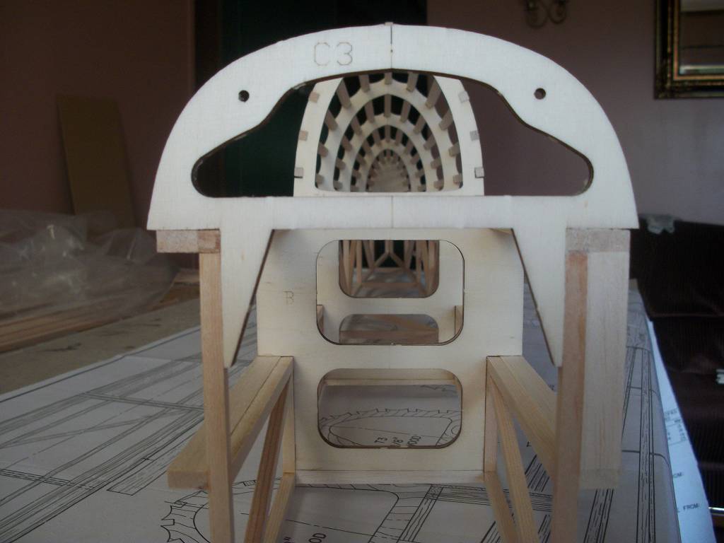

A little more progress today. This is fuse number two. This one will be the geardrive version, as I have built the firewall into this fuse.
Photo's are of the fuse upside down, with the only 3 formers that are built into the basic box structure. After the formers are added, I work my way to the rear of the fuse adding all of the 1/4" spruce cross bracing.

Couple more pics of the #2 fuse...

Default RE: Classic TOC Laser 200 build!!
Well......after a late night lastnight, I was able to complete fuselage #1, and get fuse #2 to the stage where the outside balsa pieces will be added to give it it's final shape.
