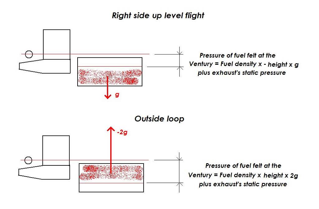

During an outside loop, the fuel level moves around and relocates just like during inverted flight respect to the carb's height.
I believe that the engine cannot just hold more than few seconds at idle while inverted, when the muffler pressure is minimum.
If the centerline of the tank is too far from the needle height in normal position, the carb feels a dramatic change in fuel level when inverted.
If that is your case, and relocating the height of the tank is not practical, a compromise in tuning the low end between upside down and right side up may be a solution.

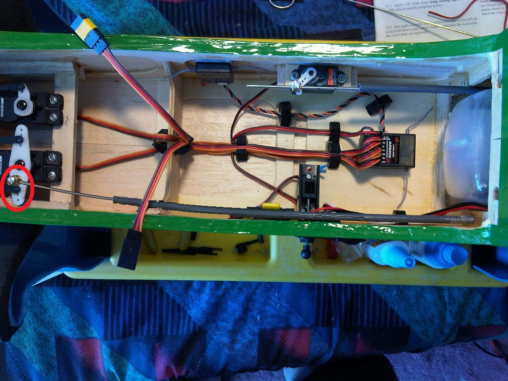

Ed,
When we see the side view of a Kaos we see the tank already has a low position related to the spray bar and that can give some troubles. (red arrows picture 2) Too rich fuel /air mixture ratio inverted.
When I look at the pictures of your Kaos (picture 3), it looks like you also did make the nose longer and did mount the engine in a more forward position, see the grey sketch and orange questionmark in picture 2. Maybe because of the back plate mounted mixture needle valve?
Can you make a sketch showing us the distances and dimensions? Especially the distance between the front side of the tank and the back plate of the engine. (blue arrows)
When you do not use a fuel pressure regulator or pump it is important to keep that distance as short as possible.
If not, I think the engine can get too much fuel in nose down going directions as result of the hydrostatic pressure. (of course until the moment during flight the clunk will be above the fuel level and the line is empty in short time!!) Remember you adjust the engine in nose up position so the mixture ratio already will be rich in horizontal ATTITUDE.

I actually built the planes to plans and didnt modify the nose at all. maybe the Tower Kaos is different.

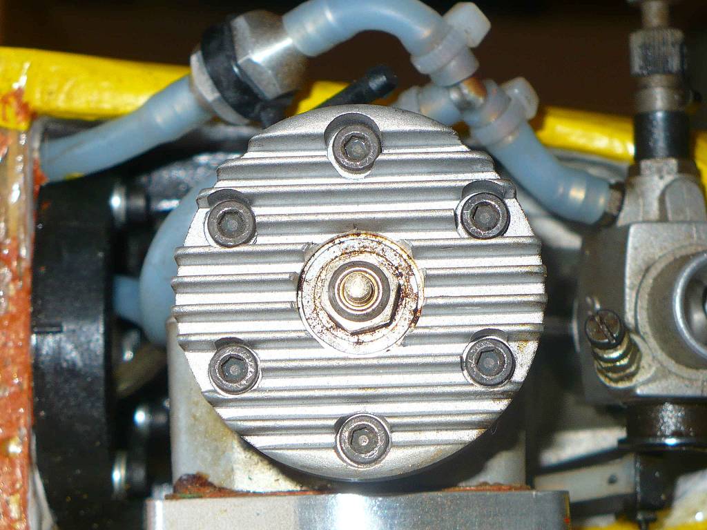

B: Back pressure. This engine (and the 1.00, too) is especially sensitive to muffler pressure, and IF you have an aftermarket muffler you will have to reduce the outlet area. This will help make your low end rock solid, along with A and C.
C: This may sound crazy, but bear with me- I have fiddled with several of these Evo 60's for a long time. Hook up a temporary on board glow, and see if it fixes the problem. I have found difficulty in getting the 60NT to run well CONSISTANTLY when mounted inverted, especially at low throttle conditions. I know, I know, most two strokes are a bit more irritating when inverted. However, I have had many success stories with inverted mountings, but this engine is different in some mysterious way.
Lean or rich, it didn't matter. Tank position was good, with nice & short tubing. This is my theory and opinion, but I think there is a connection with this and the glow plug position in the head (evolutions are canted towards the back somewhat) and poor reliability in some attitudes and throttle settings... maybe fuel droplets in the intake charge... heck, I don't know. You may try to verify this by doing some other negative G maneuvers at low throttle or idle and see if it does the same thing. I could adjust the engine to a perfect low & high mixture when sideways or upright, then turn it over and it wouldn't idle well and the problems would start. Different brand 60 did not have the slightest problem with the same plug. I know your engine is upright, but perhaps your negative G maneuver is bringing out this trait in your situation? Just a guess, but I will bet a 6 pack on it- IF your plumbing is right!
I put an on-board glow on this engine and the problem of quitting stopped, and the engine ran like a scalded dog inverted. I later repositioned to a side mounted engine configuration and took off the on board glow with success as well. Runs awesome to this day!

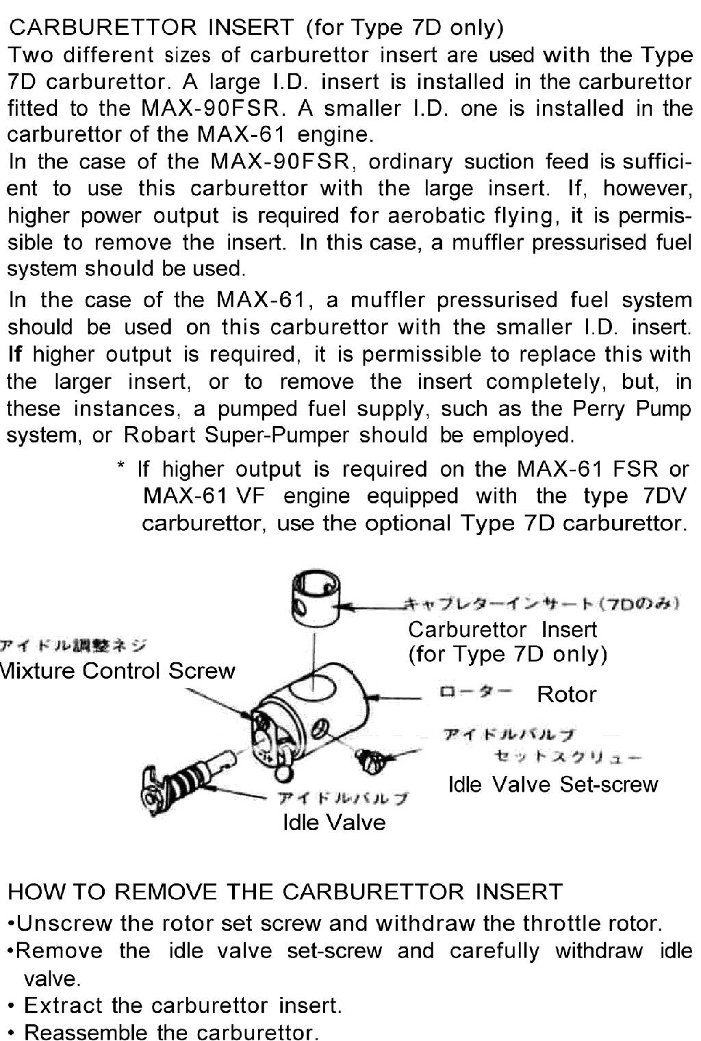

It sounds to me like the engine is running lean atlow throttle when performing the neg G maneuver. The conditionyou and Firepower are experiencing sounds like what happens when the throttle barrel bore of the carburator is to large for the engine. e.g. not enough air speed past the carb venturi to drawfuel into the carb.
Have you been able to verify if the engine is running rich or lean during the inverted portion?
If lean the following may help to understand what is happening.
The OSMax7D carb has this problem on the 61FSR when the brass insert is missing form the throttle barrel of the carb. (see insert pic) The 7D was offered 3 different ways depending on which engine it was used on. When the 7D was used on the 61FSR thebrass insertutilizedmade the throttle barrelbore 8.5mm. On the 90 FSR a larger insert was used for 9.5mm throttle bore. The last 7D carb I purchased from my LHS was labeled for use with the 108FSR and had no insert for a throttle bore of 10.5mm. Point of all this is it sounds like your engines carb throat is borderline on the large side and the problem only shows up when doing negative G maneuvers.

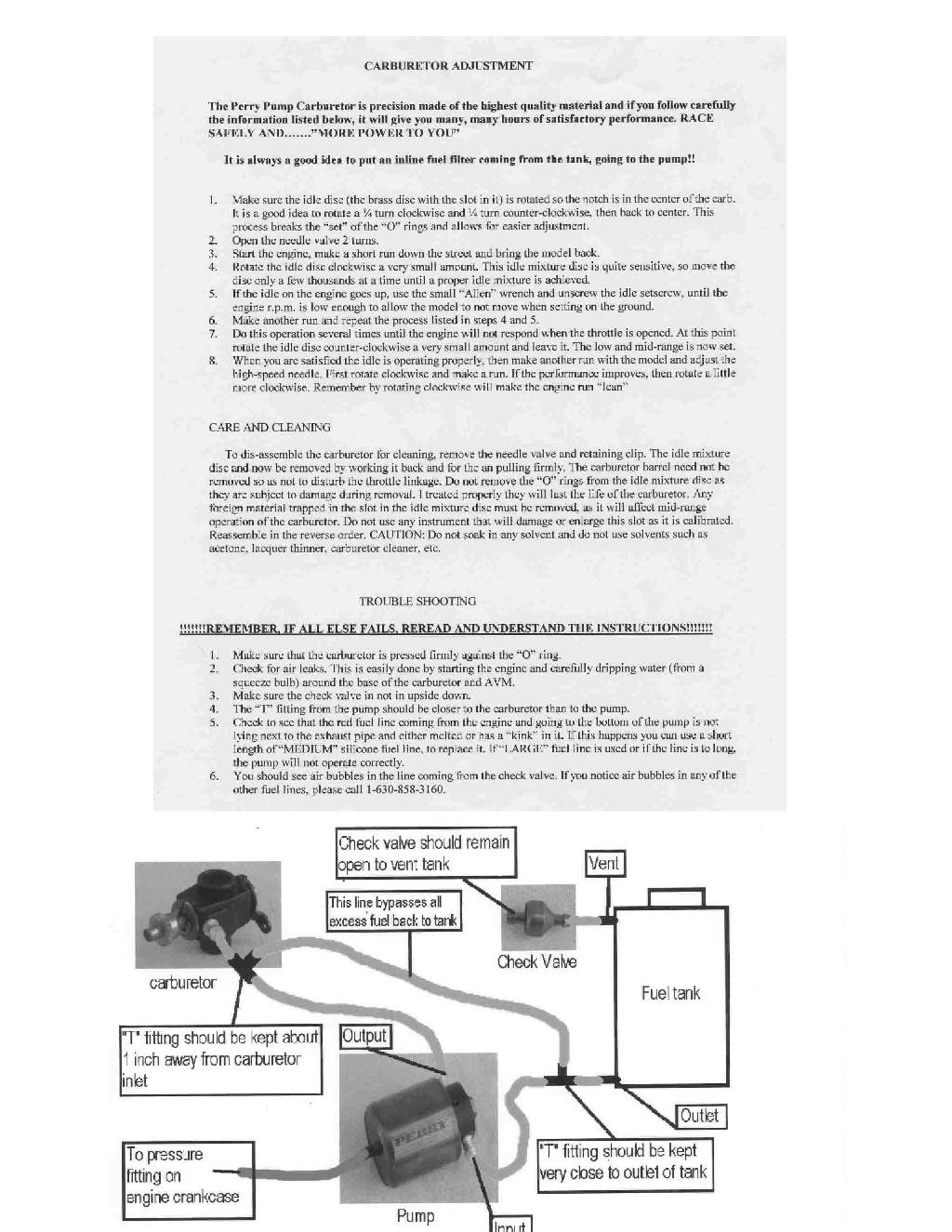

OS Max's solution was to use a pump on the engines with too large of a throttle bore to keep the fuel flowing during low throttle conditions and too give a nice boost of performance out of the engine. I've got 9 flights on my Kaos which has a 50FSR and a perry pump and have positivefuel draw in all flying manuvers. I wanted to make sure I could concertrate on learning to fly pattern maneuvers and not have fuel delivery problems during any of those maneuvers. See pics for pump locationand plumbing.
I called Perry Pumps and asked the best way to hook up their pump and they suggested that you use a T-fitting as close to the carb as possible and runa return line back to the fuel tank or back to another T-fitting between the pump and the fuel tank. (See pump and bypass system pic fromp the Perry Pump website.)
Also when using their Pump you just vent the tank to air. No muffler pressure to tank.
If you have access to a pump try it and see if this solves the problem.

I have a Taurus with a Veco .61 and Perry carb. I had problems with a muffler pressurized tank, it was very sensitive to needle settings and would quit. I replumbed the tank to be vented to atmosphere and used the third line as a fill. The problem went away, it will suck the tank dry and not miss a beat at all power settings, tank level and flight attitudes.

For tanks located way off the centerline of the spray bar, the attached schematic shows how the influence of the height of the fuel reverses for each case.
If the loop is tight enough to generated 2g's of acceleration, the weight of the fuel doubles.
The outside loop may put more static pressure on the spray bar, making the mix too rich for steady idle.

This thread is about the Evolution 0.60 NT and the carbs of these are all designed for normal muffler pressure and not an higher pressure stored in the tank by a check valve. That was why I did write
When using a check valve you will measure a much higher pressure level than with the “uncheckvalved” connection but the carbs all are designed to work without a check valve!!!!
About the Veco 61, but so “off topic”.
The Veco .61 was provided with an exhaust baffle not a muffler. First versions with a VECO carburetor and later also with a Perry carburetor. The dimensions of these carburetors were not based on tank pressure IMO, think for example about a small throat of the barrel or the range ability or characteristic of sleeve and/or needle valve(s)!
When mounting a muffler on such an engine can give some adjustment complications when using the pressure connection. Much easier to do of course is trying to run the engine without using the muffler connection. A good solution for the Taurus because the distance between tank and engine can be short.
Only point not to forget, the (Top Flite, MAN) Taurus was designed for up to 0.45 engine, so the carb of the 0.61 Veco will be on a higher position.
Cees
