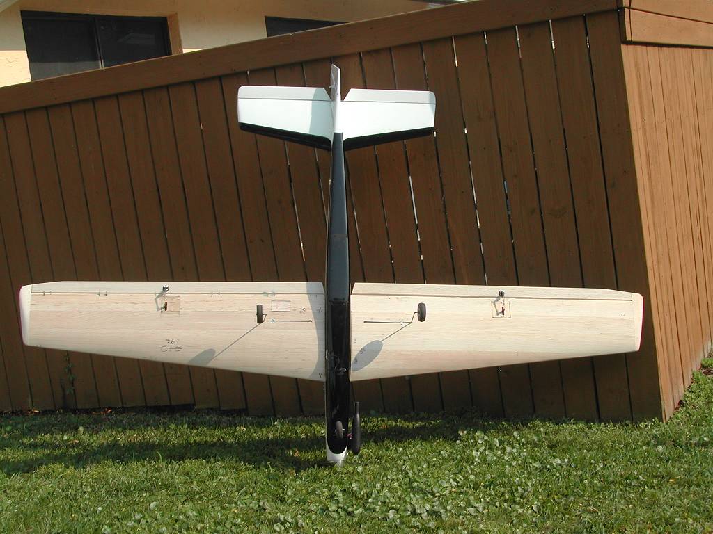

My bad, I forgot to strip the fuselage and weigh it again. However, after assembling it with an OS 120 AX with a Mac muffler, Tru-Turn spinner, 14x8 Master Airscrew three blade prop, steerable nose gear, Futaba R617FS Rx, three 3152 servos, two 5 cell 6 volt 2000 Mah batteries, and a Miracle dual switch, the all up weight of the completed fuselagecame to 8.2 lbs.
At this point the wings unfinished, but with all hardware installed come to 1.825 lbs for the left one and 1.760 lbs for the right one. That comes to 11.785 lbs before I glass and paint the wings. An educated guess on the final weight will be about 12.5 lbs. That is considerably heavier than I wanted but from what Thom has said about the 120 AX power plant I should not have much trouble with flying my Simla. Cutting 30% of this weight should be quite a challenge for Simla number 2. A smaller power plant,one less battery pack,lighter construction techniques, and lighter finishing techniques should help quite a bit. Only time will tell.
Bill
PS- For what it's worth I could have reduced the weight on this first Simla, but I basically quit worrying aboutthe weight in an effort to finish it more qiuckly.
Bye now
Bill
Bye now

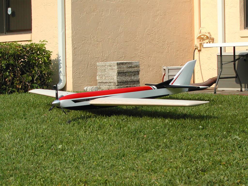

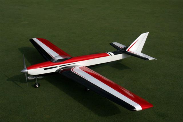

I'llbe repainting tomorrow. I am giving up on the black bottom stripe configuration at the tail feathers and making the stripe fit the wing as nearly as possible. This situation makes me believe that the fuselage has too much depth from top to bottom. I will be making some adjustments on my second Simla giving it a sleaker, slimmer fuselage.
Bill
Bill
#782
ORIGINAL: billberry189
Bill
Bill
A little change here and there can make a big difference in how the model looks. You can see the difference between the original paint, (left picture) and the final paint...coming down a little further on top so the red to black strip tucks slightly BELOW the stab L.E. has an effect on the "dash". The bottom black stripe was based primarily on the position of the wing...it should tuck below the wing L.E., but I raised it slightly to make the white stripe less broad...and the "dash" was fit between them. If everything is just right, the top of the wing should partly cover the "dash".
You can see that although the final paint is BETTER, the fuse was still too "high" top to bottom.
I still feel the paint scheme is the best measure of the accuracy of the kit to the original in the photo...remember we have to compare photos to determine accuracy...there were no plans to go by.
Can wait to see the final paint completed and your maiden flight. Like you, I preferred to have a better pilot make the maiden flight while I manned the camera.
Duane
#783
Joined: Oct 2009
Posts: 338
From: ORLANDO,
FL
Duane,
In order to get the black bottom stripe to line up properly to the wing I had to raise it to a point that was beyond the fin. What I wound up doing was ending the bottom stripe where the stripe on the bottom of the stab ends. Photos to follow this evening as I am at work and do not have my camera with me.
Bil
PS- My dash does run into the wing at the very top of the wing and then continues toward the TE.l
As promised
Bil
As promised

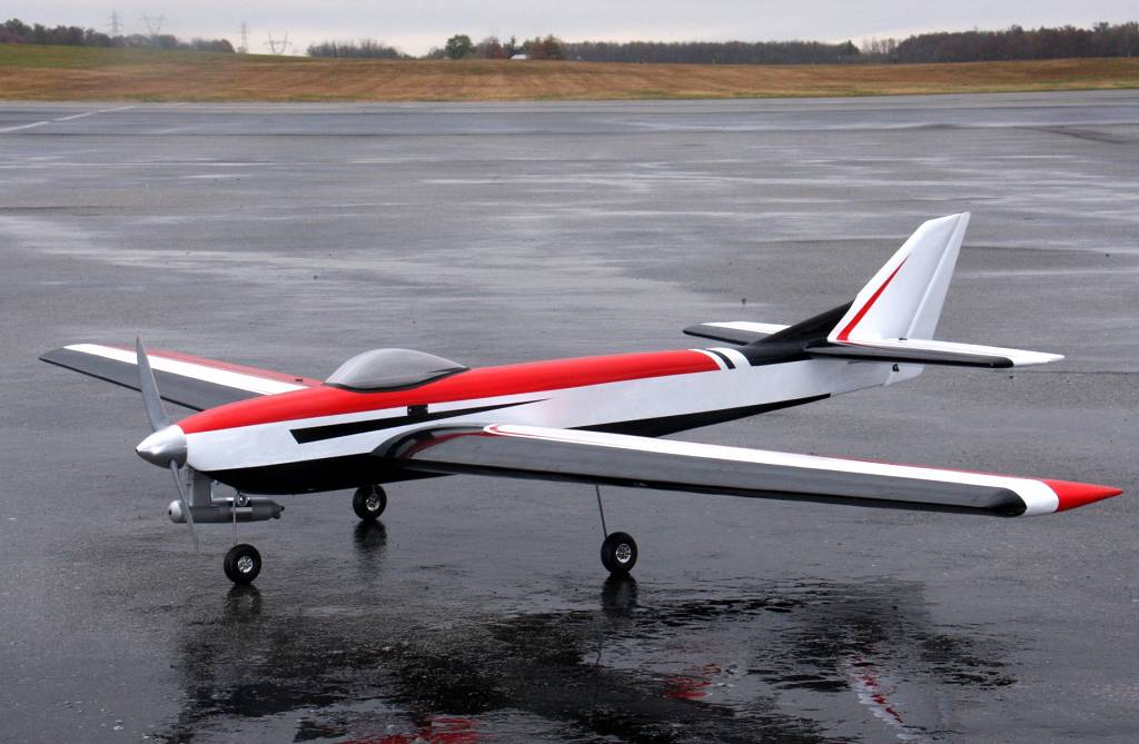

#785
Bill;
I was just taking another look at your paint scheme and "where the lines fall", and it looks prett darn good to me. My black stripe on the bottom isn't all that different from yours. I think the stripe should end past the stab, so it basically isn't all that visible anyway.

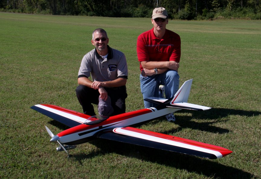

SIMLA UPDATE:
I just returned from Greensboro, NC attending a VR/CS "Glory Days" event Friday night and Saturday. I took the original Simla prototype, which hasn't even been flown since last year. Because it was my "article project plane", and original prototype, and since it was painted and I have no paint left for repairs etc etc, I was a little nervous flying it at my skill level. Simla has only about 10 flights total on it, and had mostly been flown by Kevin Clark and the editor of Model Aviation. I didn't need to be concerned. I got in 4 nice flights there in Greensboro, and now feel much more comfortable with it.
A few additional flight observations: Sealing the ailerons is a MUST..it made a huge difference in roll rate and responsiveness. The OS .91 FX was very adequate as a powerplant; it "perked along" at a good clip and had good vertical performance with that engine. I still haven't tried Simla with the original .60 in the nose, but I believe that a "hot" .60 will fly it adequately but with limited vertical performance. I can imagine that those of you flying with a 120 will have a super-performer on your hands with unlimited vertical [X(]
...yet it slows down to a "walk" and is very forgiving and predictable. "Flies like a Taurus anly better..." is something I've heard more than once. At 102" wingspan, it's such a huge plane that it was a real attention-getter...lots of comments during the meet about how beautiful and graceful it looked, (even when I flew it).
In the hands of a good pilot the Simla really shines and is literally a JOY to watch perform. An expert, was doing Rolling Circles with it. With full rudder, Simla would not quite hold Knife Edge...we either need a little more rudder throw, or mor speed, (which that 120 would certainly provide).
Because it has such a high-aspect wing ratio, (long wing), it behaves a lot like a glider, (just as UStik predicted it would back in the Ed Kazmirski's Taurus threadway to go Burkhard). There was an incident that proved that point...a dead-stick landing, and a long approach. The expert pilot happened to be flying it at the time, and told us he thought it would land short of the 50X50 foot hard surface landing pad that everyone wanted to touch down on, but he kept slowly raising the nose to extend the glide, and in the end, Simla was still a few inches above the deck as it passed the pad edge, and landed in a beautiful nose-high touch-down on the mains amid applause from onlookers. It was very slow and graceful as it touched down like an airliner on full flaps, (there are no flaps on Simla...doesn't need them). Those of you who have purchased a kit and are building the plane....YOU WILL LOVE IT, and be the "envy of the flight line".
I've included a few pictures from the event. (BTW...Cees might be interested to learn that it won the VR/CS "Concours Award" for the plane closest to the original). [8D]
Let's get some reports and photos!! Do we have two more in the air now besides the prototypes?

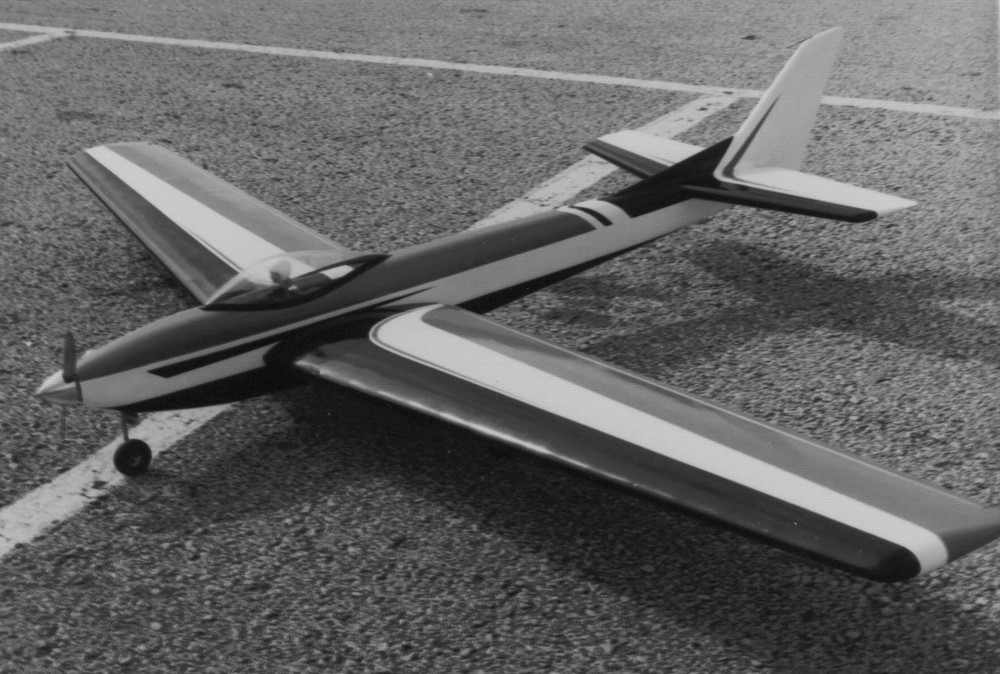

#787
Don likely would have been familiar with the original Simla...I know they were both at the Detroit Invitational meet in 1965. There were two planes Ed was flying at the time, (tha I'm sure of), the Simla and the Taurus II. He had the Taurus II with him at that contest. It would have been "cool" to have seen the Simla, but then I never would have seen the Taurus II, so what can I say? I like them both, and the T-2 has survived to this day, and has flown once more.
Lucky dog to have Don Lowe as your test pilot...I think Don can handle it OK.
What is your Simla's final weight...tell me when you know?
Duane
